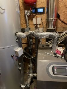

Hi everyone can anybody help I’ve had no heating for nearly a month I kept getting E032 low flow and protection wouldn’t allow water to pump through. I just turned switch on off but I believe after a few times it had to be reset. I’ve tried so many engineers and nobody will look at it. There is no option to reset on screen it seems whole thing hasn’t been set up properly at all. The reason I had to turn it off was due to cold water pumping through constantly if I’d turned down thermostat. It’s been nothing but problems from day one not to mention the cost. Please if anyone knows solution I’d greatly appreciate it.

The filter should be in the return pipework going back to the heat pump. It would be helpful if you could post both wide angle and close-up photo's of your system so that we can help identify the different components.

@derek-m I’ll do that. At this point I just want anyone to fix it installer long gone!they’ve set it up to get the most heat to the rads therefore no weather comp, and no DHW that comes from immersion. Someone told me that when certain temperature gauges/wiring isn’t connected that it will turn off at certain times, but I know that timer in control panel is definitely not on.
Do you have a copy of the manual HughF posted? If so, could you provide a photo of the main screen display as shown on page 10 of the manual.
