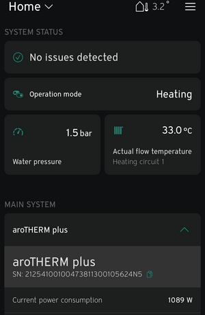

Our Vailllant 5kW heat pump is working well and the house is warm. The flow temperature in the app used to show what you'd expect it to be from the heating curve, but in recent weeks it seems to be showing about 3 degrees less than it should be. As an example today, the heating curve is set to 0.5, outside temperature is 3.2c
The app shows 33c

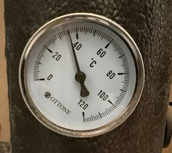

The gauge shows approx 36c

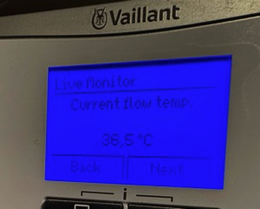

The live monitor shows 36.5c

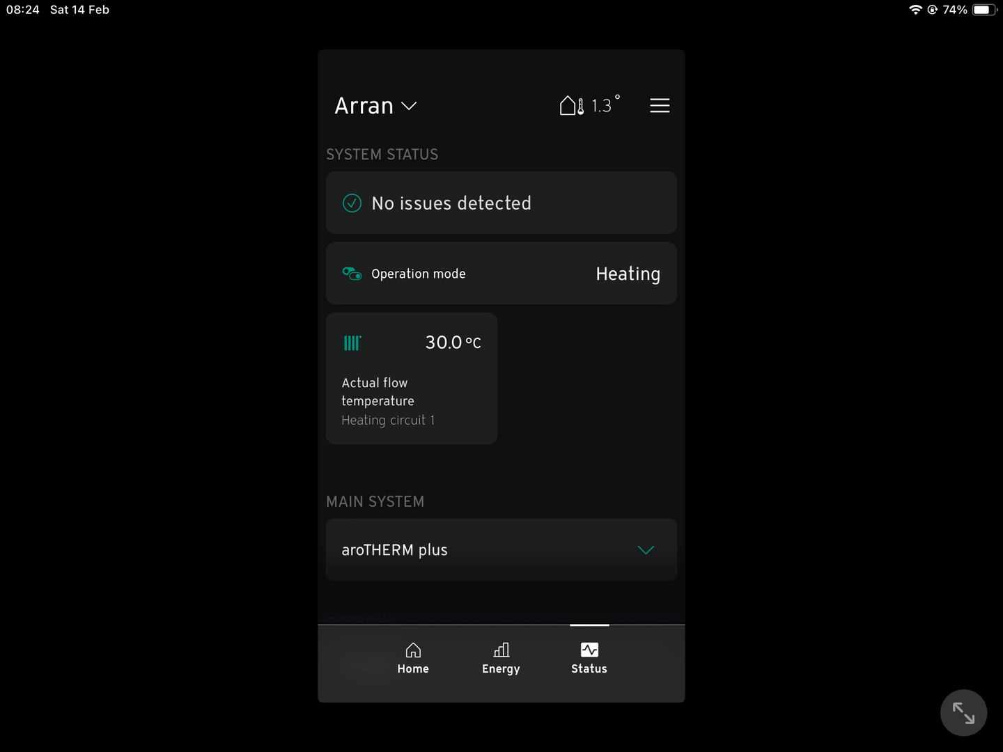

3 questions. Your status screen shot gives system pressure at 1.5bar. I don’t have that shown - see my photo below. Further, my HC is set at 0.4 suggesting the flow should be about 33 not the 30 shown. My flow T is nearly always below what the HC suggests and I don’t understand why.

Yes in principle, but its quite difficult to monitor this way because you cant see trends Also Im not sure the delay between what the app reads and the outside world and the frequency with which the app updates. Live monitor is real time so that may be better. It takes a while for the FT to recover, 10-20mins.
Re the system pressure, have you got the latest version of the app?
It looks like you are seeing the same discrepancy as me.

where the temperature gauge is mounted. I assume on the external unit within the casing?
It's on a backup heater that is in-line with the system and located in the plant room.

No, I've looked at it multiple times over a few weeks now and it is always about 3 degrees out.

No idea then, it's inconceivable that the app and live monitor use different sensors!
Hi Andy, finally I have done the flow temp check and both Senso Comfort and Live Monitor show the same flow temperature. In my case it is currently 28C.
