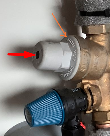

Posted by: @transparentYes, the knob has an adjustment for pressure...
... but it's also a filter (unless the installer removed the cartridge).
Sorry to resurrect this thread, but it is sort of relevant so on balance putting this here.
But how do you actually adjust the pressure? I have exactly the same PRV and following a burst water main and repair in the road right by my house the pipework now hums, a rather penetrating hole in the head sort of hum, when a cold tap is turned on. Putting a hand on the PRV when it is humming confirms it is vibrating. I suspect the burst water main repair changed the mains pressure and that upset things.
The 'manuals' I have found say there is a hex adjustment screw in the top of the grey cover and the grey cover even has plus and minus rotation arrows on it but there is only a black 'spot' in the centre (big red arrow in image below) which I thought may be a cover for the hex screw but it won't come out even with moderate force applied with a scalpel tip to remove it. Unscrewing the whole grey cap will open up the system (and flood the house if I don't turn the mains off first), rather than adjust the pressure. Does anyone know how to adjust these valves to alter the pressure (I want to try a small tweak to see if it will stop the humming)?
