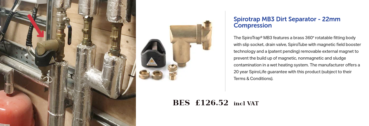

@transparent @shaeney I'm impressed by the use of a Spirotech Spirotrap high flow rate low head resistance dirt filter. Its only the second one I've ever seen on an ASHP install picture (the first one being mine). So many installs use narrow-bore boiler grade ones.

The Spirotech Spirotrap, available widely, including BES

@iancalderbank I have absolutely no idea what this means 🙂
Posts: 3473
@shaeney It's another indication that you have got a particularly well-designed heat-pump installation. 🙂
I'll leave Ian to describe why he favours that particular filter.
