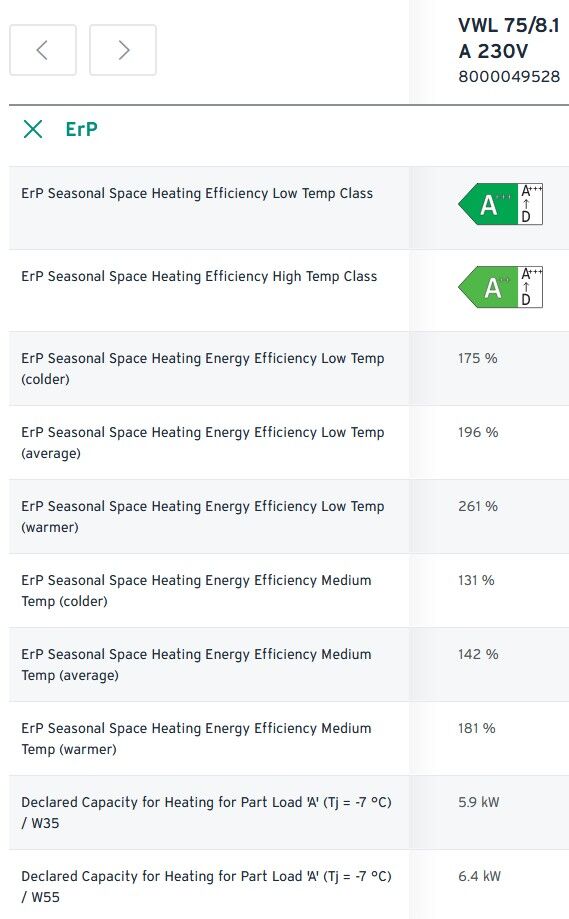

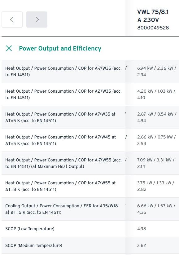

In a word no, I have never fully understood the test conditions for these standard tests which manufacturers are required to do.
Vaillamt data can be difficult to find, they seem to write a lot of different versions for different countries and then put it in different places on their website often in the installer only section which is inconsistently password protected. Not at all what I would expect from a German company.
for the plus we have the Czech data book, which was always the bible.
So far as I know nobody has yet found the equivalent for the pro, but I think this gives you the information you require.
I was given the Installation and Maintenance instructions for the Pro (v 7.1, new Plus is 8.1). But the corresponding table has no explanation.
I would look for the specification of the EN 14511..
There seems to be some info at
