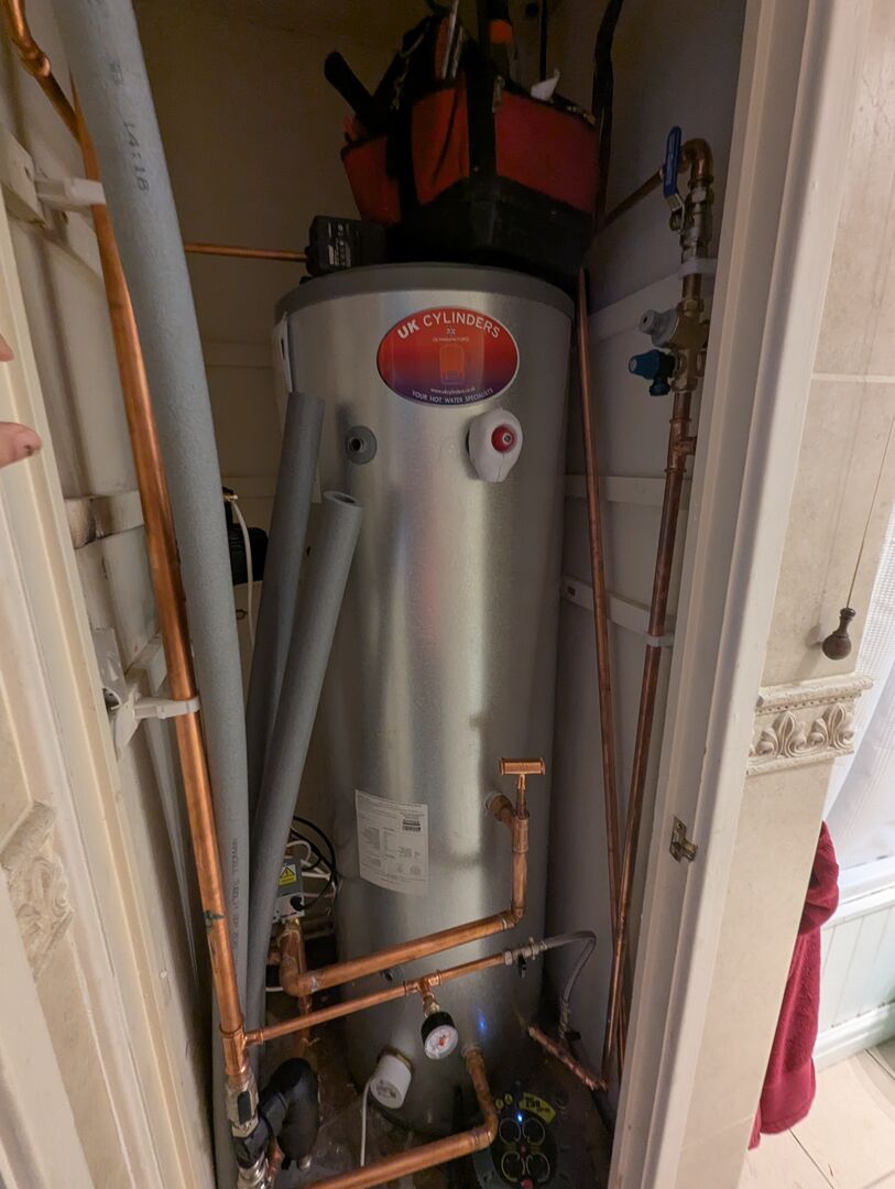

We had immersion powered hot water last night, as expected. The cylinder cupboard is filling up with pipework and there's lagging waiting to be added.

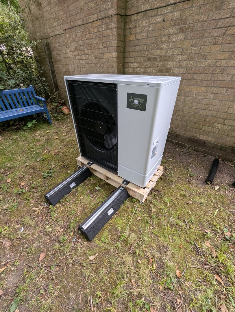

The heat pump (a 10kW Ecodan R290) is still on its pallet in the garden close to where it is being sited.
