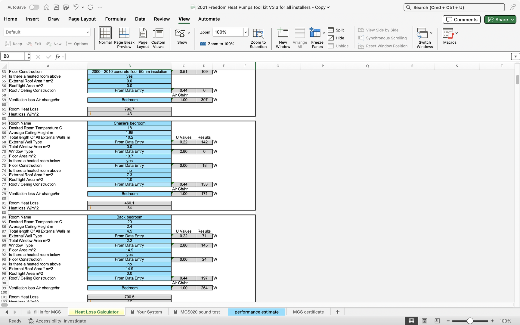

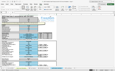

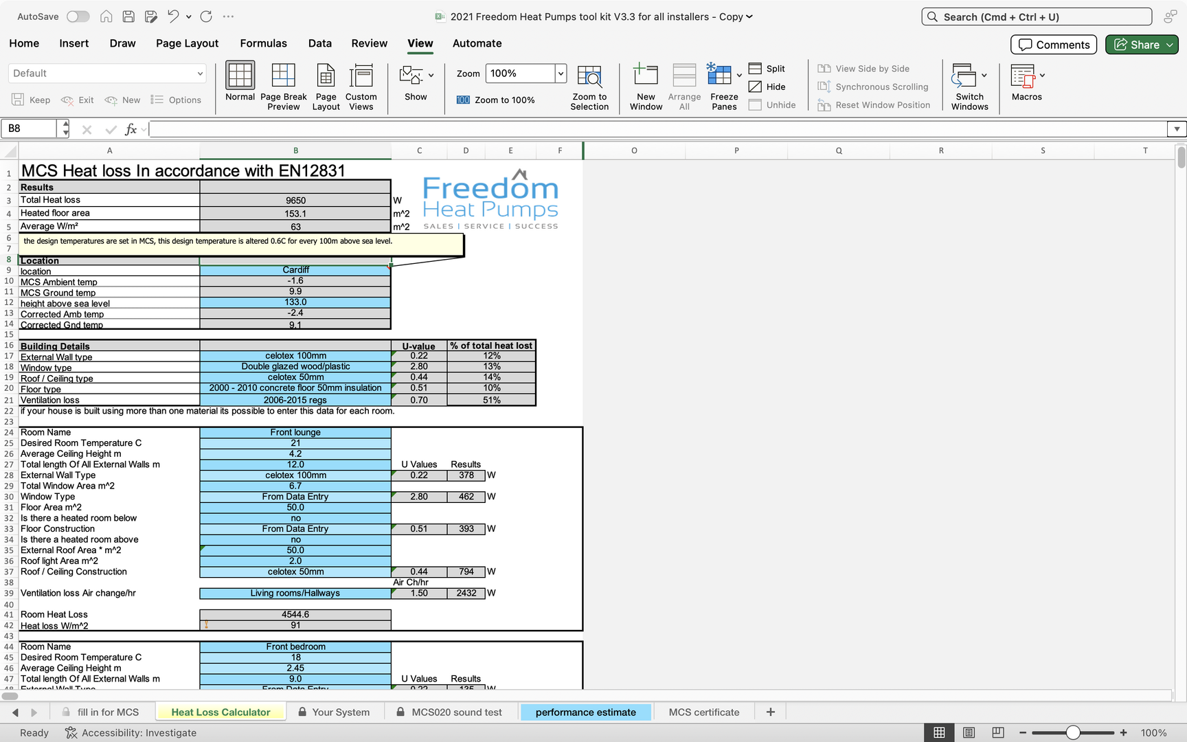

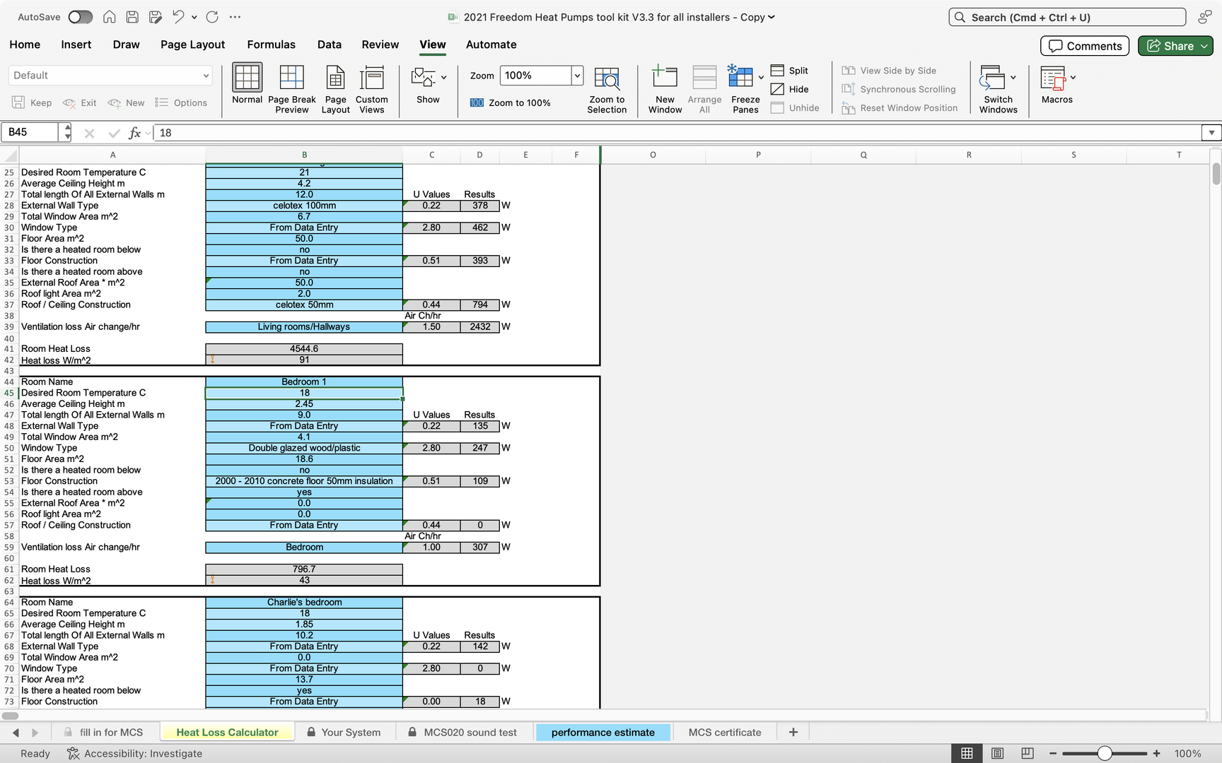

So, I have input details into the Freedom Heat Pumps loss calculator and I get the following
Lounge - Installer Heat Loss 40 Room Loss 1995 Mine Heat Loss 88 Room 4384
Kitchen - Installer HL 32 Room 1003 Mine HL 46 Room 1501
Bedroom 1 - Installer 22 Room 409 Mine HL 43 Room 797
Bedroom Upstairs - Installer 18 Room 247 Mine HL 34 Room 460
Their numbers are out by a factor of between 1.5 and 2.2 x
Their property loss is 8639 kW - mine is probably more like 12915 kW if I factor at the lowest multiple of 1.5 x

I suspected such a discrepancy, but we need to be 100% sure. When you say
"Lounge - Installer Heat Loss 40 Room Loss 1995 Mine Heat Loss 88 Room 4384
Kitchen - Installer HL 32 Room 1003 Mine HL 46 Room 1501"
I presume the larger numbers are the room's heat loss in watts, but I am not sure what the smaller numbers (40, 88, 32, 46) are. Can you please say what they are.
It would also be very helpful if you can post a screen grab of the calcs. That way I and others can check for errors. The more (informed) people who inspect them the better!
The other thing of course is that full area/U-value/AC calculator based heat losses tend to be over-estimates of actual heat loss, but we'll put that to one side for now.

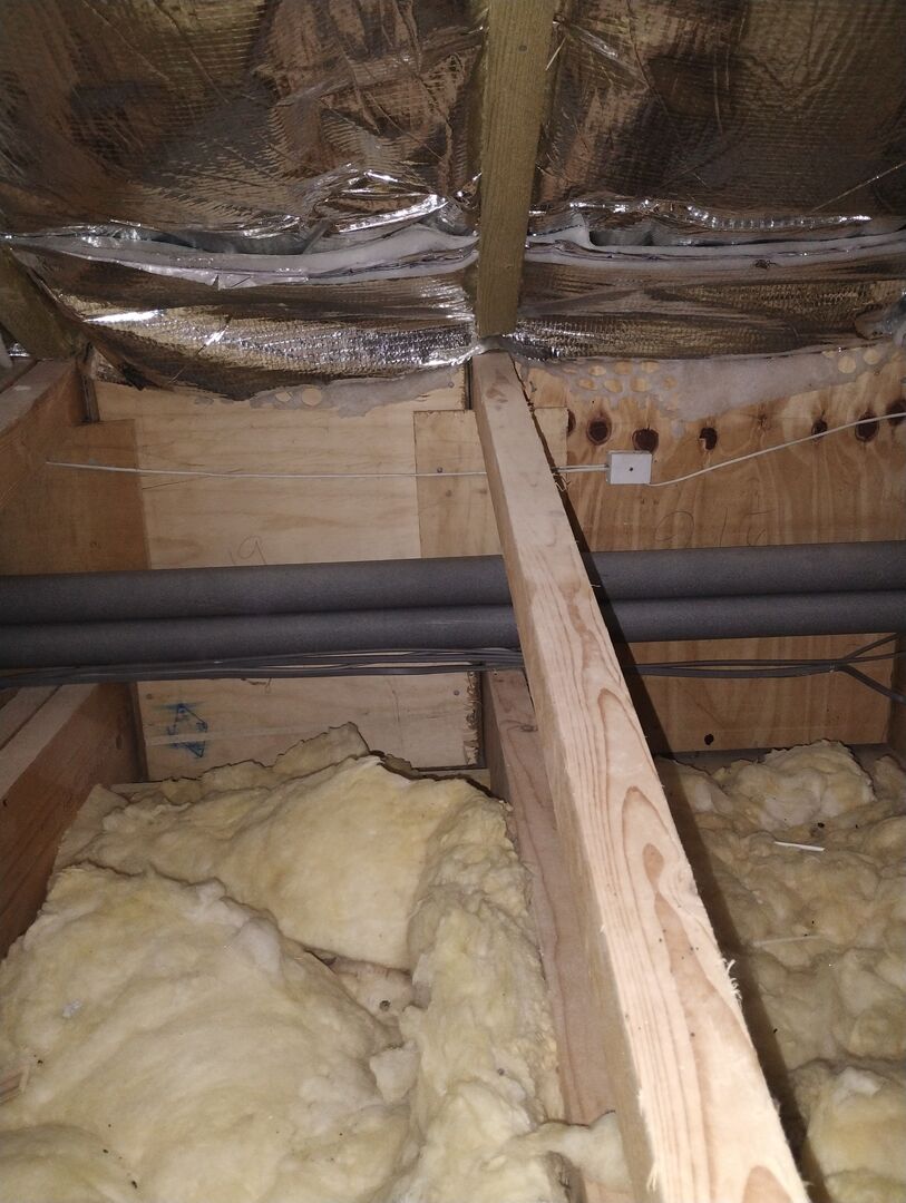

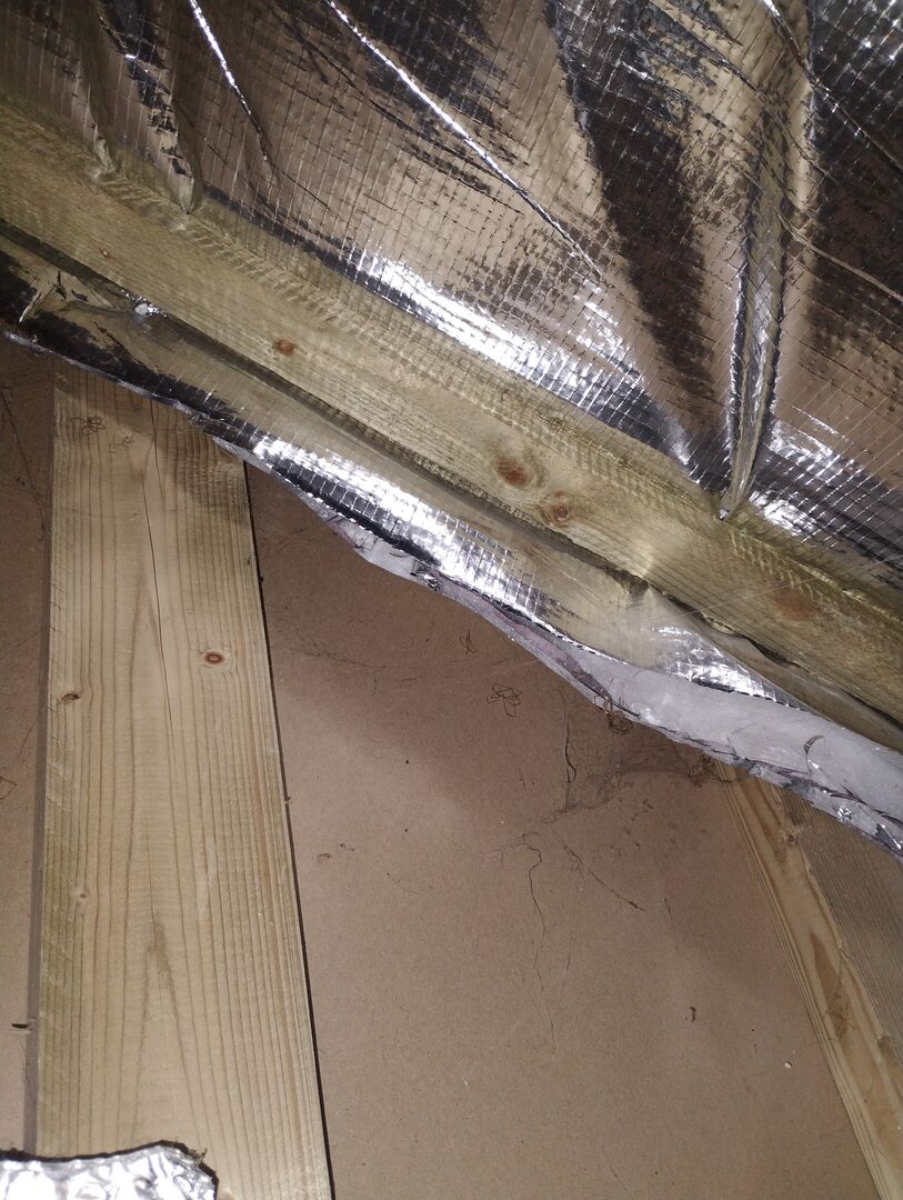

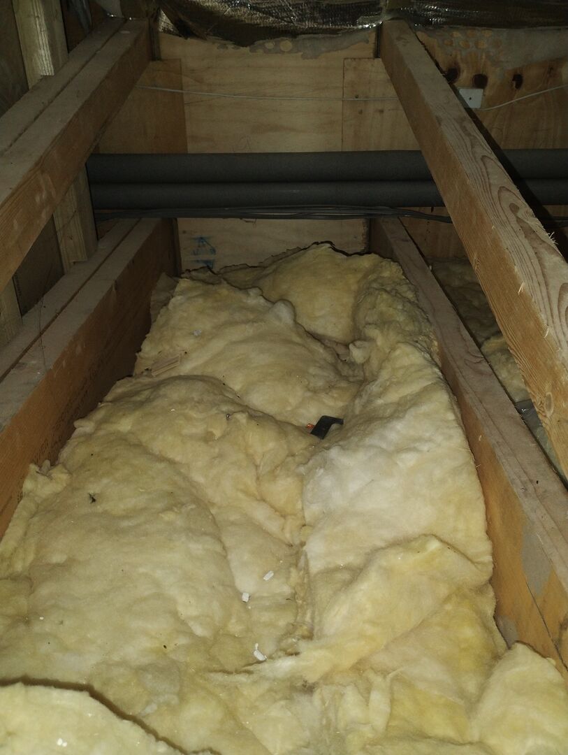

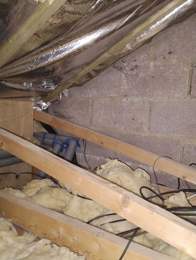

@cathoderay. I've taken the numbers directly from the Freedom heat loss calculator that I downloaded from your link. This shows a room heat loss (large number) and a heat loss number W/m2 (small number). I've attached screen shots of the rooms I have done - lounge, kitchen, bedroom 1 and Charlie's bedroom (upstairs)

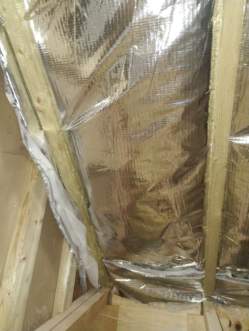

In the assumptions I've put External Wall celotex 100mm as I have solid brick and 100mm was the building regs requirement in 2007 (date of house build). Roof I put celotex 50mm but in the void between ceiling and roof it's mainly Triso quilt (don't know how good that is but doesn't look like it would be as good as celotex 50mm) Regs suggest 200mm for roof insulation but there is no way we have that (attached photos at the only point where I can get access to the rafters shows very little insulation). I've now updated roof downgrading to 50mm celotex but it could be worse than that. Floor construction and vent loss based on date of construction.
ACHs are as specified in the Freedom calculator that is based on room type.

Posted by: @pash44pumpI've attached screen shots of the rooms I have done
Thanks, on a quick inspection they look sensible, but I will review again tomorrow. Others may care to comment in the mean time.
