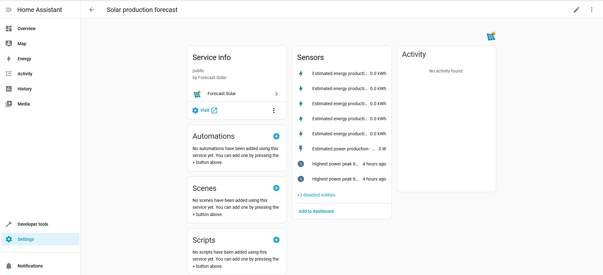

Posted by: @majordennisbloodnokPosted by: @morgan@majordennisbloodnok it isn't obvious where on their site one finds where to get a forecast.
That’s not a problem. If you can hit the main landing page (which you obviously seem to have managed) that’s all I need to know. It confirms there’s no problem between your home and the web server.
Having read up more, the API shouldn’t need a key at all. I don’t know if it used to but doesn’t now or what, but I’ll need to get back home to see what I can see from my home network before going any further.
OK, so I've taken a look at my HA instance and it seems the forecast.solar site's free plan does not need an API key and so the problem with your instance isn't what I thought it was.

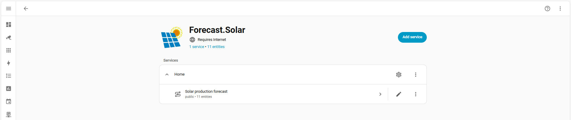

If you go to Settings, Devices and Services, find the forecast.solar device and click on it you should see something like this

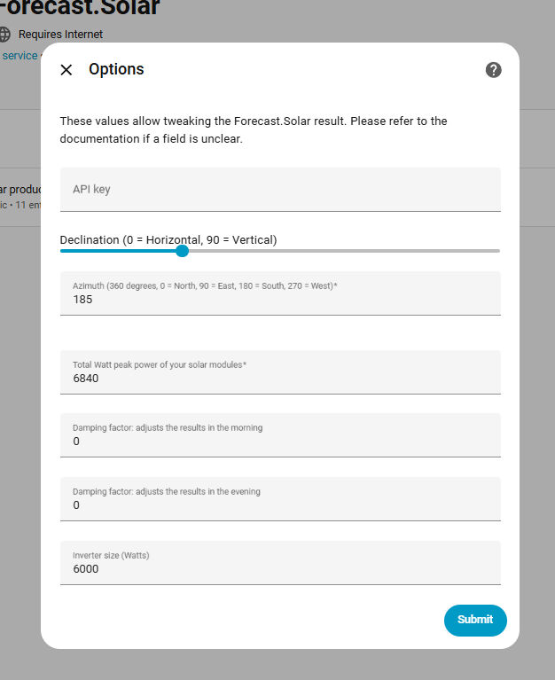

Clicking on the little configuration cog should get you to a screen entitled "Options" where you can tweak the relevant settings (API key if you were using one, direction your roof is pointing, roof elevation, kWp of your panels and so forth). If you leave the settings as they are and just click the Submit button, does that kick it into working?

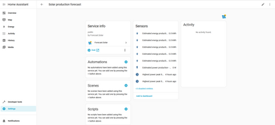

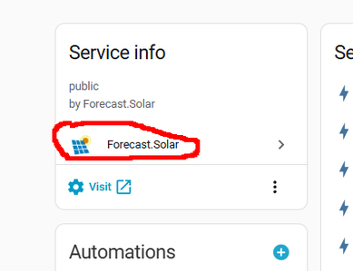

Ah, OK. I think, when you were clicking on the forecast.solar device, you clicked on the "1 service" link rather than the "Forecast.Solar" link. No matter; from the screenshot you've uploaded, can you click on the bit I've highlighted here, please?
That'll get to the same place I showed in this screenshot
...where you can see the little cog icon. That's the one I'd like you to press, and it'll give you a screen looking like this
No doubt your options will be slightly different to mine, but what I'm interested in is what happens when you get to this screen and then just click on the Submit button (i.e. reapplying the same options you had there to start with).

Bingo. Sometimes a judiciously placed size 10 bovver boot does wonders....

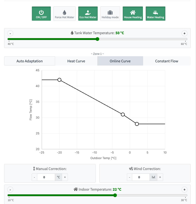

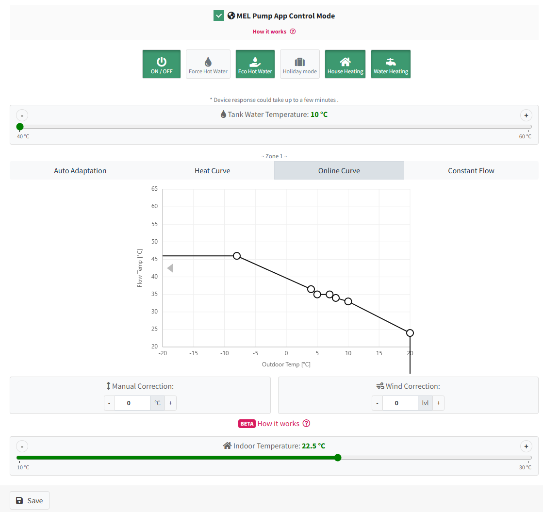

A sneak preview of the onboard compensation curve designer that is going to be built into MELPump for use only with the adapter.
Still tweaking the design - e.g. it would be great to add "live" point to show where on the curve you currently are and therefore you can adjust your points to help optimise.
As mentioned previously, the online tool is only a visual designer, the saved settings are sent and kept locally onboard the adapter in your home so it can operate in the case of WiFi drop out or connection loss with the Internet (when we look at the adapter wifi connection data of the ~2700 users, this is important for reliability)
@f1p Looks good, and will likely be something I use when it becomes available (is it sad that I've picked up that there'll be a new colour coding for the operation mode?) My free trial of MelPump has just expired, so I've just started an annual subscription used primarily for the data reporting, so this will be a useful additional benefit, even if I somehow succeed in implementing the steps outlined by @majordennisbloodnok to get direct control via a 'geekier' route, which I'm still psyching myself up to attempt.
