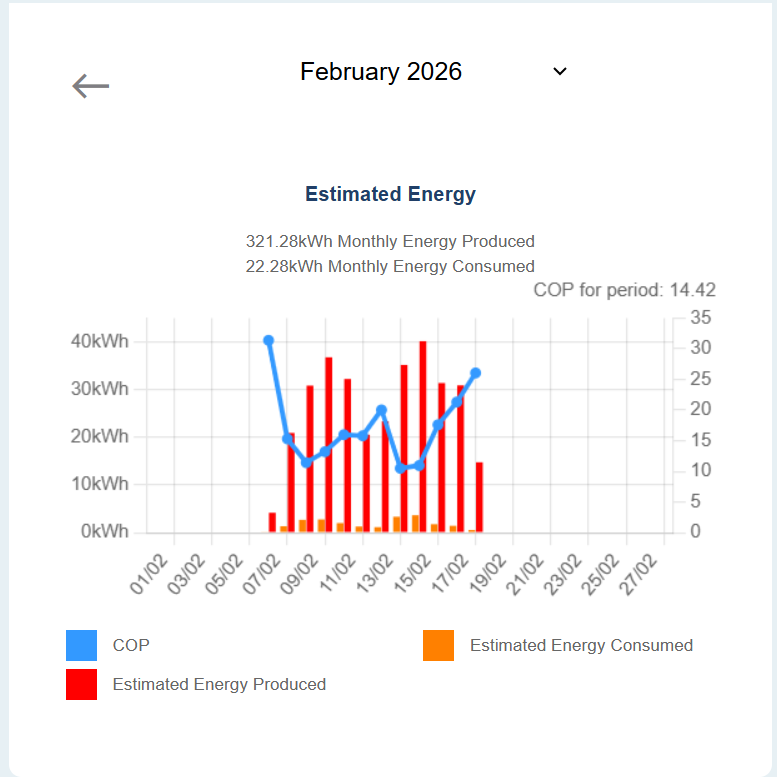

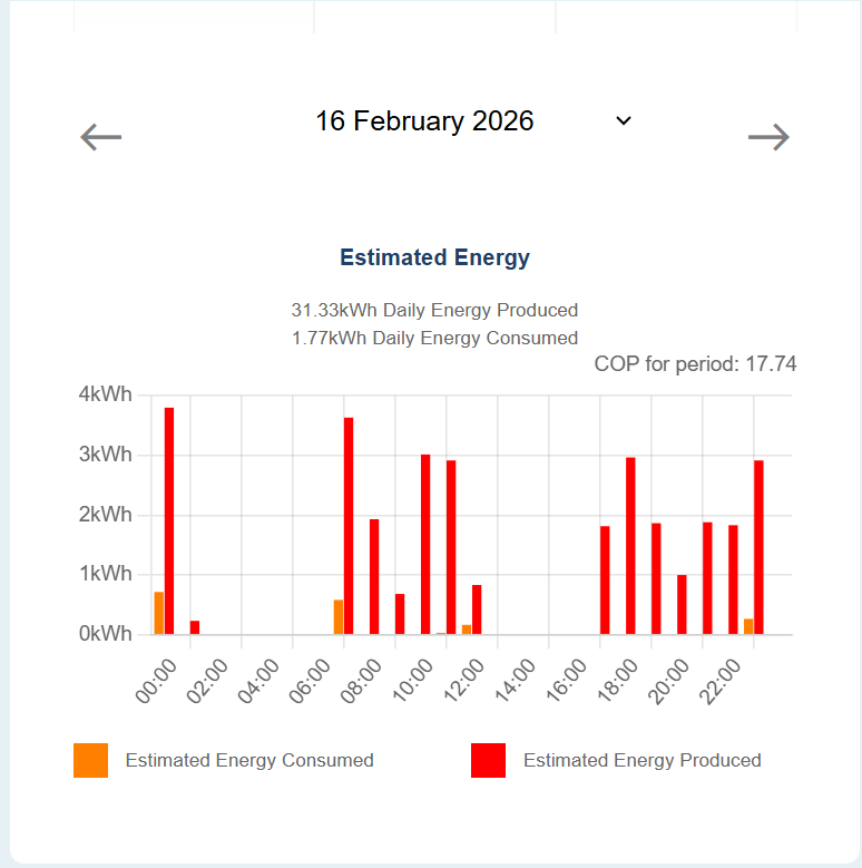

Posted by: @darlomrhDoes anyone have any experience using Melcloud Home and whether the energy reports are reliable or a work of fiction. I have pasted a day this week
That seems too good to be true whilst running on Auto Adaption.
COP of 17.7 exceeds the theoretical Carnot maximum so is definitely too good to be true.
There are several periods when its producing energy but not using it apparently. Thats great, if I believed it, which I dont because its the basis of a perpetual motion machine.
In summary, although I have no experience of using MelCloud, I can say for sure something is wrong. Hopefully someone can suggest what!

Firstly, the obvious answer. There is not a snowball's chance in hell that your heat pump is managing a CoP of 17.74. Either there is an error in the measurement of the figures at the heat pump (unlikely but possible) or there is some other external factor influencing things (quite possible). Whichever it is, though, a CoP of 3-4 is OK/good, 4-5 is great, 5-6 is raising eyebrows and 7+ is unbelievable without independent corroboration.
Secondly, it's worth bearing in mind where the energy consumed and energy produced come from. The energy consumed is reasonably straightforward to measure and so probably fairly accurate; it's also easy to measure independently if you choose to invest in a CT clamp. The energy produced, however, involves a little more black magic; the flow rate determines the volume of water moved in a given period and the delta T (the difference between flow temperature and return temperature) will determine the amount of energy released from that volume of water in that time period. Any variations in the flow rate or delta T during that period will affect the accuracy of the estimate as will the specific gravity of the heating fluid (i.e. does the heat pump know it's pure water or a glycol mix and, if so, is it correct in its understanding?).
All this is only really useful to know in that it's perfectly possible to get the data for a time period for each of the component parts and then for you to do the CoP calculation yourself. That will help you understand if it's a data in problem or a Melcloud Home calculation problem.
In your position, the first thing I'd do is to take a look at the CoP in Melcloud Home over a longer period such as a week or so. If that averaged-out CoP is still unbelievable that'd be my impetus to burrow in further.

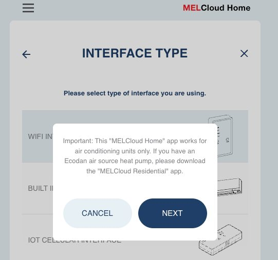

If your Air-to-Water unit has been fitted with the MELCloud WiFi Adapter part number MAC-597IF-E it is only compatible with MELCloud Home,
While they may still be in circulation, older generations such as the MAC-577F-E, MAC587F-E are discontinued but seem to be cross compatible with the old app.melcloud.com and the new MELCloud Home.
When i sign up, regardless of model - i am told MELCloud Home is only for Air-to-Air:

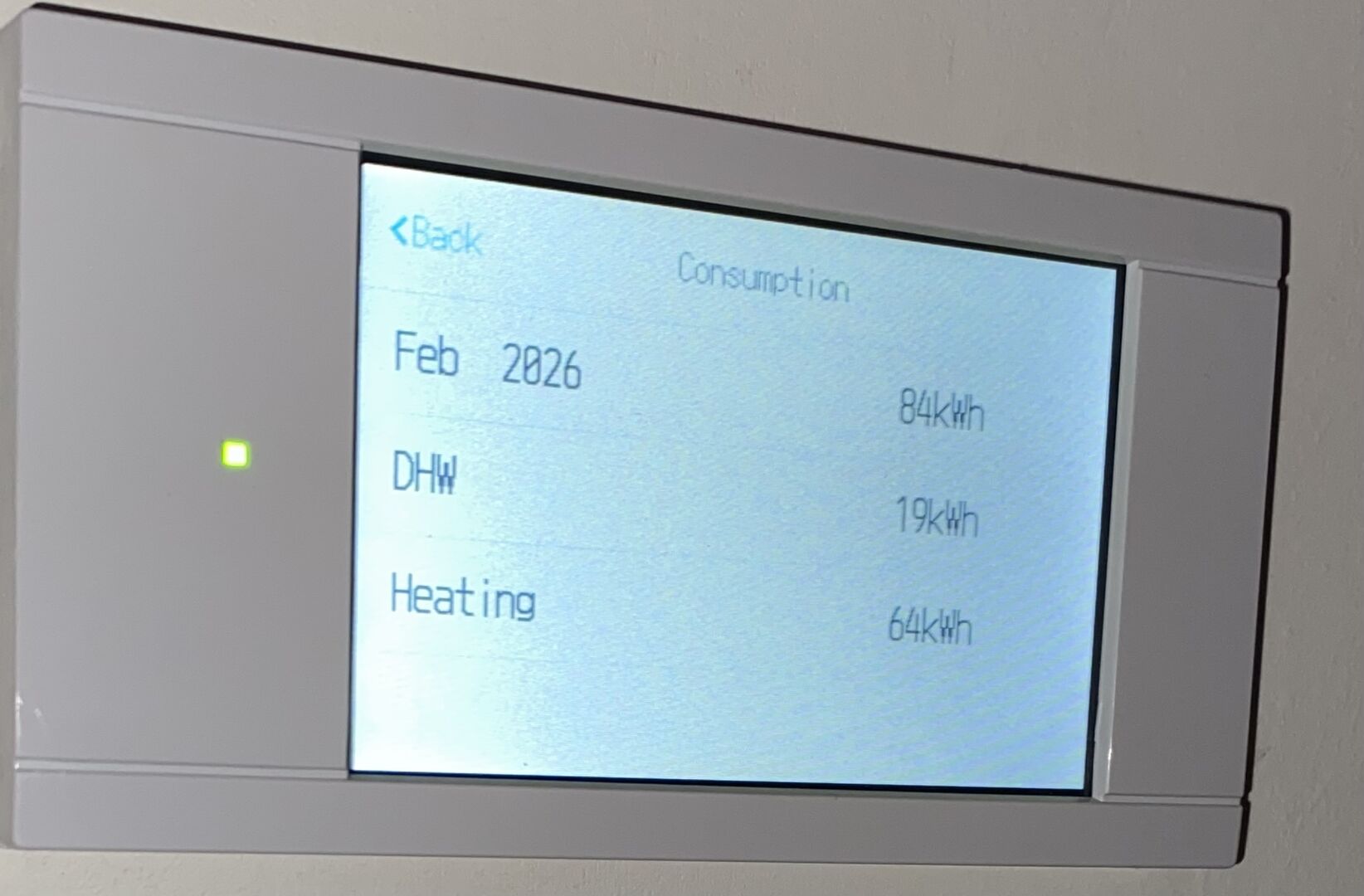

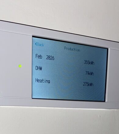

Posted by: @darlomrh84 kwh consumption seems more plausible than 22.3
Totally agree. 84kWh in vs 355kWh out gives a total CoP for period of 4.23 which is well within the bounds of credulity (and actually pretty good too). I'd say that's enough info to be able to raise an issue with Mitsi about Melcloud Home and ask them to investigate/fix.

Just been on the phone to Mitsubishi and indeed MCH is not supported for ASHP (yet) so they advised me all I needed to add was the indoorbox box and none of the others to sync up. So now on melcloud and see how that goes. Didn't help that my kit has melcloud branding on it (which they said was a mistake)
