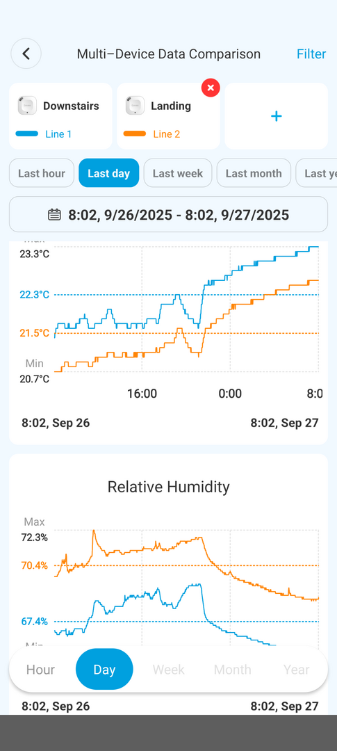

@terry1812 so I set the Madoka to 24 and this happens
Screenshot 20250927 080319
So my Madoka my be set differently
Daikin 6Kw ASHP.
Posts: 5629
Posted by: @jancold
Or your WC curve is set too high.  The most likely thing to happen if you turn up the Madoka is that the house overheats, because the WC curve is set higher than it needs to be.  So the next thing to do is to adjust the WC curve down until the house is just at the right temperature, balancing the rads if necessary.
