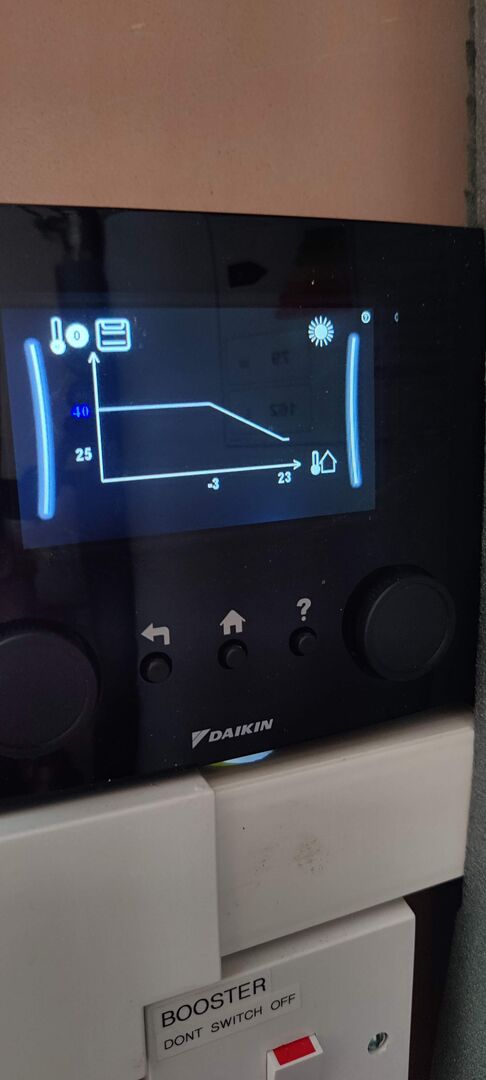

system is an Octopus install with a Daikin 6Kw Heat Pump. Now that I have started heating I am trying to get to grips with the controls. Octopus design to 50C but I have upgraded all the bedroom single panels to K2’s of a similar width. They upgraded the ground floor radiators to K2’s, added a large K3 and I added a 600 * 600 K2. Using Heatpunk I calculated that I should be able to lower the design temp to 45, we shall see if that works. I have removed the trv’s except for two in the bedrooms. I have not done balancing but the bathroom towel rail and main bedroom radiator are the first off the piping and I can imagine they may need throttling in.
Now I want to try to set the MMI for continuous running open zone.
Do I need to set any schedules in the app or just leave them blank?
The weather compensation is set as the photo. If the house over or under heats, which value(s) do I change?
The Madoka, I believe I need to set above my desired temperature, 25 or more.?

Welcome, you are asking very much the right questions!
Posted by: @jancoldThe weather compensation is set as the photo. If the house over or under heats, which value(s) do I change?
The target flow temperature at low OAT (currently 40/-3?)

Posted by: @jancoldNow I want to try to set the MMI for continuous running open zone.
Dont know the Daikin UI but somewhere it will presumably implement on/off/timed (on my vaillant its called manual/off/timed). You want 'On' (ie permanently on), which may well be the default.

@jancold I have a Daikin Altherma 3 8kw. Looking at your mmi, it looks as if it set a little non standard. The base setting is usually 45c at -2 or whatever your design low temp is, at the other end it’s usually 25c at an outside temp of 16c. As a number of people will tell you daikins don’t really like operating at 25c. If you have decided to use weather dependent mode, (recommended) then you don’t need to do anything, the madoka then simply acts as a thermometer. You need to make sure all trv’s are fully opened. The weather dependent will adjust heat according to outside temperature (OT) so for eg, if your OT is 10c, and the curve is flow temp 40c at -2 OT to flow temp 25c at 16c OT then the heat pump looking at the curve will aim at around a flow temp of 36c. Don’t know what you OT is at present and of course it will vary during the course of the day and the heatpump will respond accordingly. in this mode it operates 7/24. Now if it gets to warm you have a couple of options. One is to tweak the Weather dependent curve (WDC), so reduce the output at the -2 level , but leave the other end the same. Don’t make massive changes just tweak it a degree and see how it goes, then another degree. When you change the flow temp, because you are reducing the water temp you will also be reducing the capacity of the radiators to emit heat, which if you are too hot you want to do. Don’t be tempted to put in schedules etc, these I believe do mess with the efficiency. Try to tune the curve to give you what you want. The second option is the offset. On the mmi you can change the flow temperature up or down. So rather than changing the curve, you can get a similar effect by changing the offset. The offset is changed in settings at breadcrumb 2, main zone. Just use the dial on the right hand side.
To check you are in weather dependent mode go to breadcrumb 2.4 and ensure weather dependent is selected.
If you don’t know what I mean by breadcrumb, it is the number allocated to the menus. As you look at your mmi, you should be able to see in the top left hand corner a little dot. If you can’t see that press the ? On the MMI once. When you turn the left wheel on the MMI you should then be able to see the menu numbers change. To select just PRESS the left wheel.

@terry1812 That is very helpful, thanks. Since finding the included paperwork was irrelevant I have now downloaded and printed out the 68 page user manual.
I will remove the schedules since I thought it was the way to make the pump run 24/7 and you say they are not necessary and reset the curve. Just now our min OT is about 6C .
