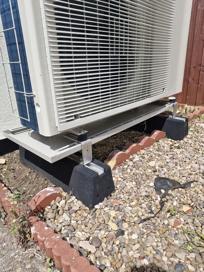

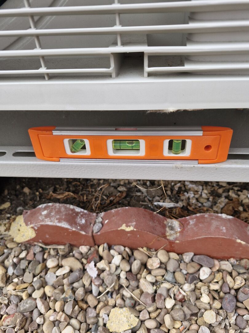

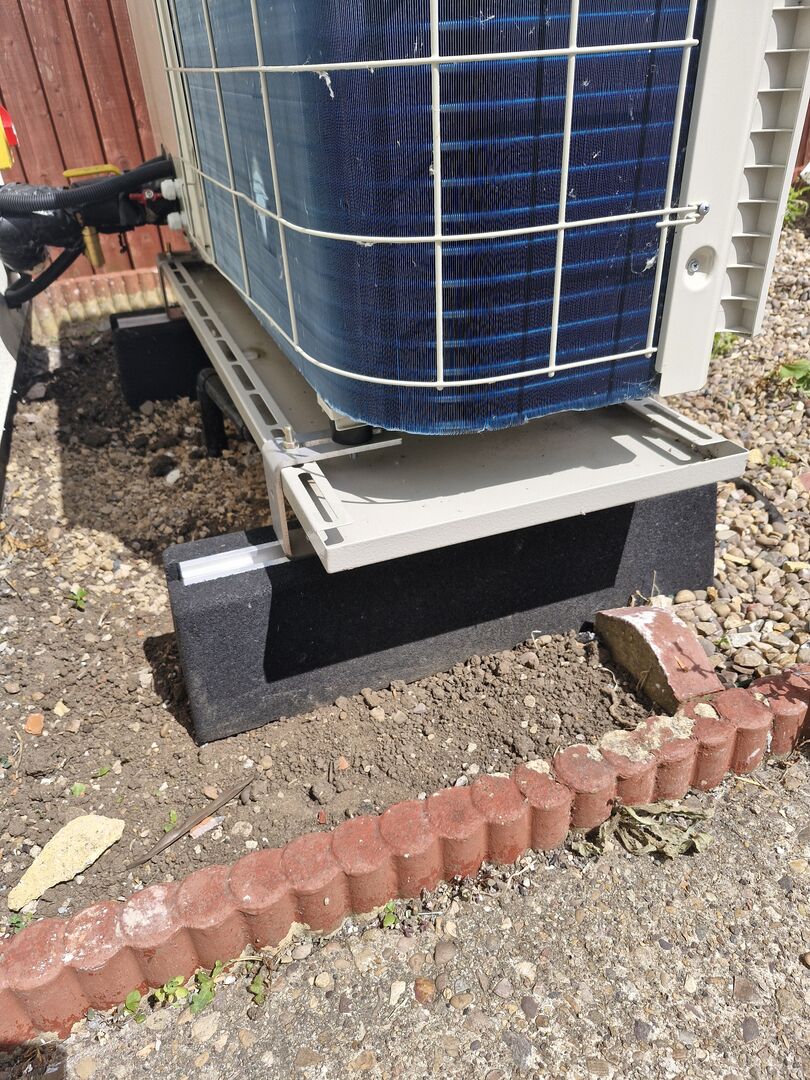

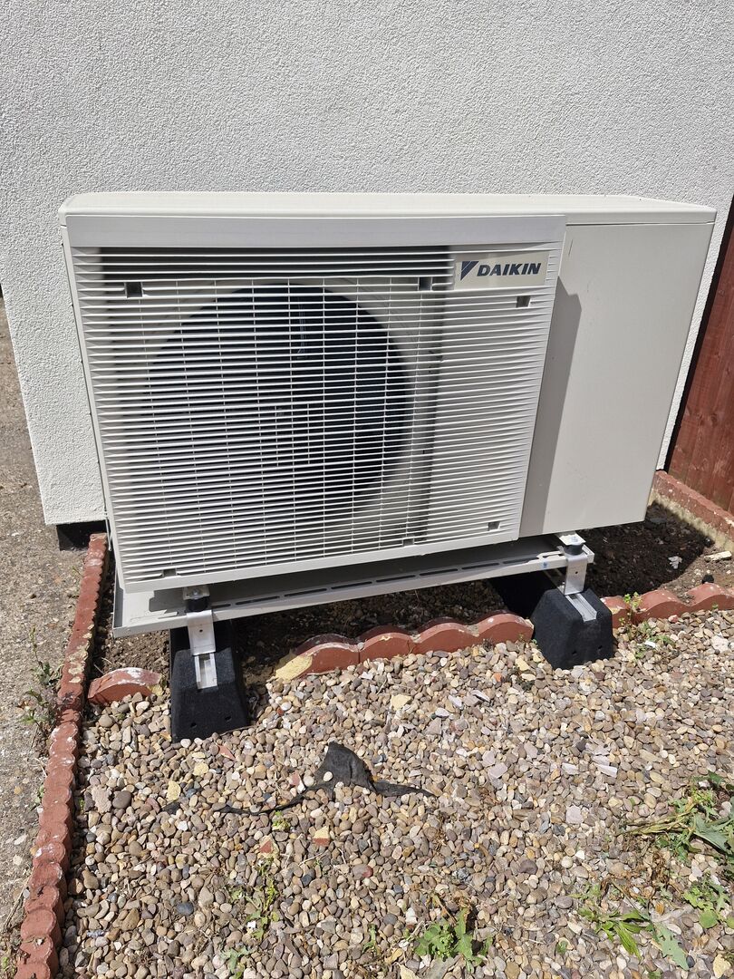

I had this ASHP installed in April. It failed the Trust Mark inspection because it was installed on uneven ground/edging and was not level front to back.
A man from the company has been out since and I believe he put a bit of broken up breeze block under one of the feet to level it out and put more soil on top.
The photos show the result.

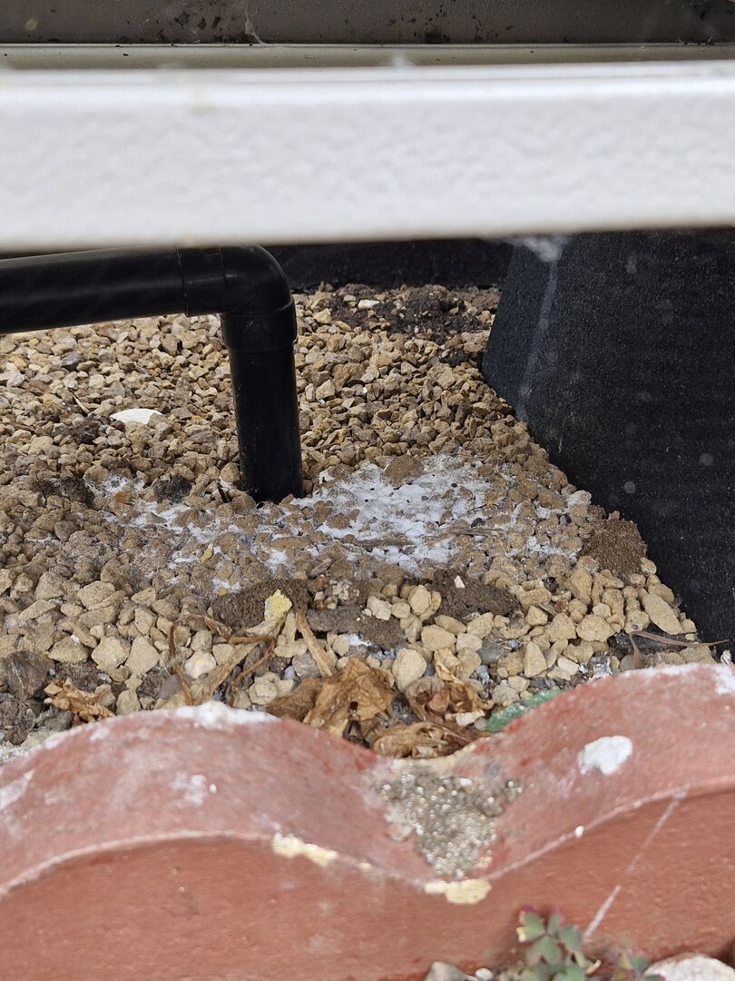

For context the edging is concreted in, which is why they've just smashed it up and put feet on top. The soil area used to be a flower bed and To my knowledge no groundwork/weed membrane or anything was used. Just a little bit of new gravel was scattered around the condensation outlet (which had already frosted over with mineralisation, hopefully this is normal).
To be honest I was expecting they'd lay a concrete slab, but maybe I was expecting too much?
Anyway, I'm worried they're going to get me to sign to say I'm happy with it...and I don't think I am. Should I be? Is this normal/acceptable?
I also don't really understand why it's level in the middle (side to side) but not at the edges, I guess the unit must be bowed in the centre as the drip tray is not level.

Can you please post some photos? What you've described doesn't sound great.
@el3b Hi, sorry to hear that, it is advisable to install the system level to allow it to function correctly and to prevent unwanted noise vibration or ware on the components.
I have attached 2 types of plinth we usually ask for or provide to the external units, this allows minimal vibration, a level and sturdy hard standing and good soak-away for the condensate.

I think @editor and @ashp-bobba are being very polite about this but their views are clear nonetheless. Without putting any words into their mouths, I'm going to be a little more blunt with my own take.
Posted by: @el3bI had this ASHP installed in April. It failed the Trust Mark inspection because it was installed on uneven ground/edging and was not level front to back.
This ASHP was installed by an installer with - at least as far as this part of the job is concerned - a clean slate. They could have chosen to put a concrete slab down if they preferred or they could have chosen to wall mount the unit. All they needed to do was make sure the outdoor unit was sited in a safe, stable position that ensured the unit was level in accordance with the manufacturer's specifications. Let's forget that it's an ASHP; this bit is not plumbing. If they plumped for a wall bracket it's basically heavy duty shelf-hanging. If they plumped for a unit sitting on the ground the preparation is basically small-scale garden shed preparation. You wouldn't put up with a door frame that isn't truly vertical so why should you put up with a base that isn't level? It couldn't be more noddy and basic. The fact they haven't done it correctly is their fault and theirs alone, and sorting it out is their problem.
When I was a youngster, disreputable car sales people would put sawdust in a noisy gearbox to quieten it down, and the problem would obviously surface later after the customer had parted with their money. This is the same kind of approach; it's not a fix; it's a cludge. The installer should be hauled back to correct the problem properly.
