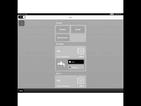

- @editor I didn't resolve the issue really. My system is an Ecodan 5kW. I understand that it might be possible using Melcloud (but I'd need to buy an Ecodan WiFi adapter). In the end, I just implement setback manually. I've got the curve calibrated nicely to give room temps of about 19.5. The stats are set to 21, as a temp limiter. When I go to bed I nudge the curve down by 1 or 2 degrees on the FTC6 panel, then nudge it back in the morning. Power consumption is pretty meagre and I can mostly satisfy it with my solar panels and battery.
