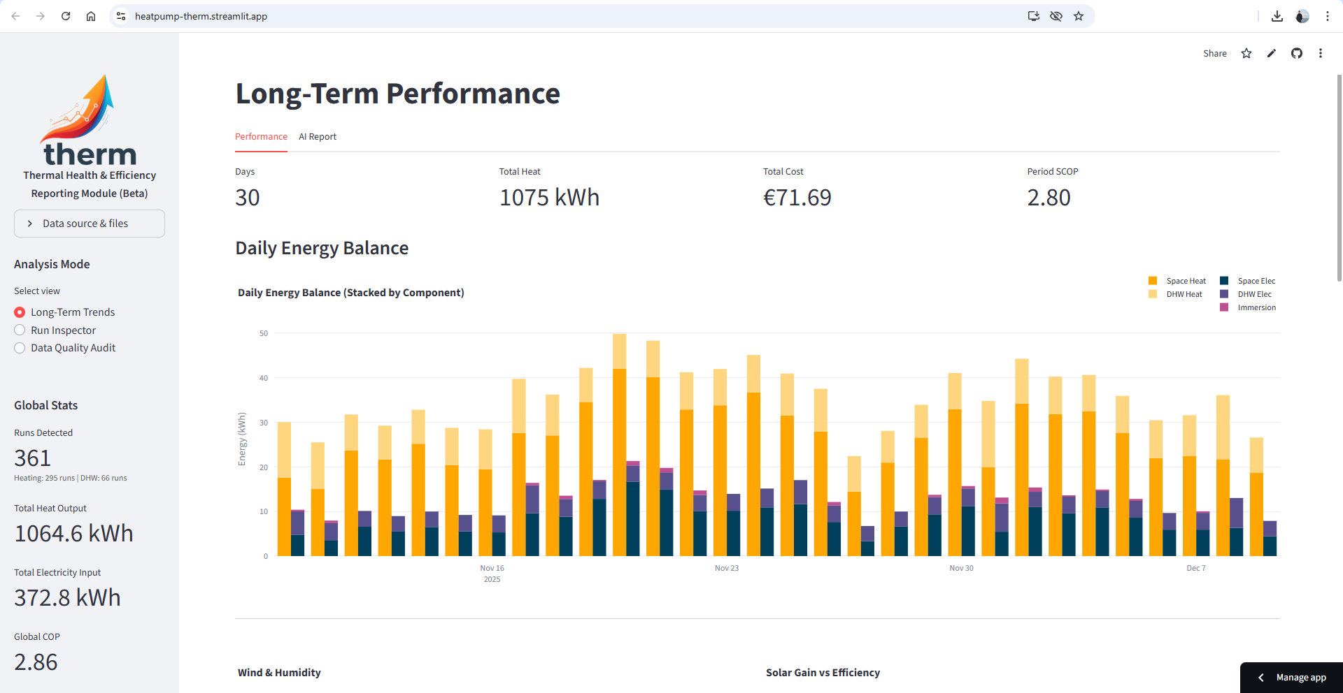

Over the last while I’ve been building an analysis tool for my own Samsung/Joule heat pump using data from Home Assistant exports. It started as a way to answer some very basic questions I couldn’t get clear answers to from dashboards alone — what is my real COP, what’s is influencing system performance and are there things I can do to optimise how it runs? I found myself getting overwhelmed by all the options that were available to adjust and didn't know what the try and optimise first.
That project turned into my web app therm, which was an opportunity to look into AI-based coding tools (I have no professional experience) and to see what I could come up with, so I said I would share it here to see if others were interested. It is not a mass-market tool and probably only for those who already like to analyse their heat pump data.
One of the goals I had was to be able to produce an output that I could give to an AI system so that it could help diagnose any issues with my setup. I had tried uploading the raw Home Assistant/Grafana data to AI platforms but the issue was the very inconsistent analysis between uploads on various days. The app hopefully resolves this by conducting the structured data analysis and leaves the interpretation of a much smaller, but consistently laid out dataset to the AI system. The JSON data outputs also contain prompts for the AI system to use to guide their interpretation and result output.
The can also work as a prospective tool for someone who wants to monitor the impact of any changes they make and only set up the data feeds now.
The app can be accessed via the Streamlit platform (unfortunately they do make you sign up). There are sample files there to use to see the app working:
https://heatpump-therm.streamlit.app/

As a minimum dataset, the app requires an Outdoor Unit power sensor (I use a CT clamp) and then Flow/Return temperatures (I am getting them from the Modbus data)
Once the files are loaded, the app reconstructs the system behaviour minute-by-minute and breaks operation into proper heating runs, DHW runs, defrost periods, and idle time. Each run is then analysed for delivered heat, electrical input, real COP, ΔT stability, flow behaviour, and zone interaction.
It creates structured JSON data for the long-term data and for the individual runs. This

The biggest fault it exposed on my system
The single most important thing THERM uncovered on my own Samsung/Joule setup was this:
During DHW production, the space-heating circulation pumps are allowed to run. When that happens, heat intended for the cylinder is simultaneously being pushed into underfloor and radiators. The return temperature rises rapidly, ΔT collapses, and the compressor has to work much harder for the same tank temperature increase. DHW COP gets severely impacted.
This behaviour was essentially invisible to me and would take someone closely monitoring monitor pump states to detect it.
I had added an optocoupler board previously to monitor the primary pump, secondary pump, and three zone pumps, and merged those digital states into the analysis alongside the Modbus data. I was able then to correlate the zone pump readings with the Indoor Unit power sensor to set a threshold of 120W so that Heating during DHW can be determined without the zone pump sensors.
The AI analysis helped me to discover this and it has had a major impact on the performance of the system.
It also helped to identify that the pump speeds were likely incorrect and when I changed these, I also saw performance improvements.
