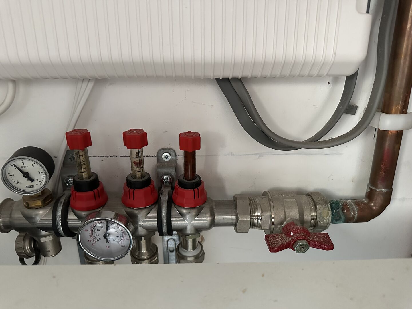

The ground floor UFH manifold needs those valve actuators removed, and replaced with the manual knobs which it probably came with.
Those knobs are then turned so that the flow through each loop is balanced.
That's where the sight-glasses at the top are needed.
Each pipe loop will have a different length, and might also be constrained by having more bends than the others.
You will end up having the manual knob fully open for the longest pipe-loop, which is the one with the most resistance to flow.

Posted by: @vanqbalance those knobs so the numbers in the clear part all match? currently they look all full/red
Well I can get all my UFH flow monitors to show "all at max flow" simply by having the circulating pump on full!
But that's not efficient of course.
The shorter loops would be returning water which still retains lots of energy.

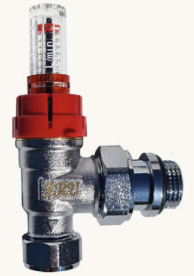

Have a look at this article about a flow-regulating valve for radiators.
It's similar to those on your UFH manifold but allows you to see the water speed for each radiator.

Posted by: @vanqQ. Then how do it make sure the valve (not sure where this is or if there is one for the downstairs system) and the pump are "open", as assume they're also in that heating control box.
You've got manual butterfly valves at the end of the UFH manifold, which don't have to full open. Mine aren't on my upstairs manifold.

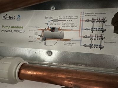

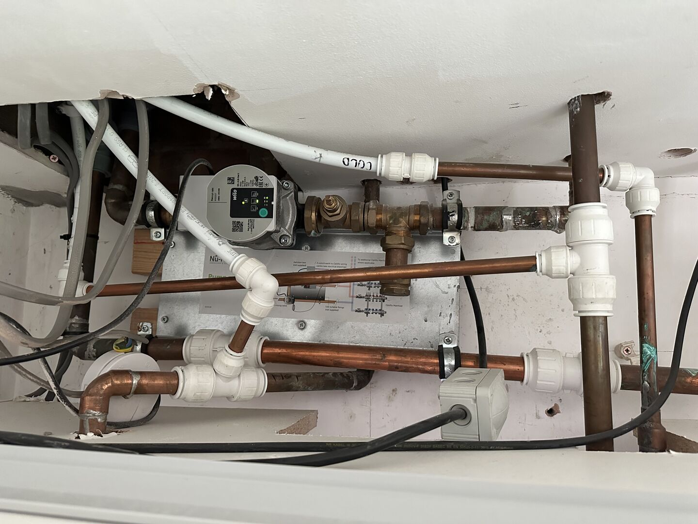

If you think we need to know more about "the" pump then post a photo.
But do you actually have one?
The entire system might just be using the pump inbuilt to the ASHP.

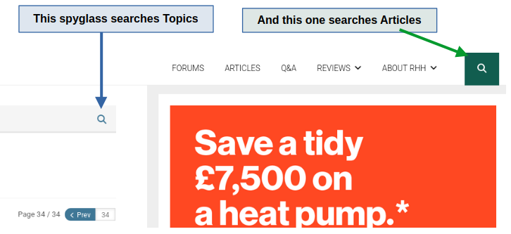

Posted by: @vanqQ. How do I then set the actual temperature? Assume its controlling the flow temp at source and some trial and error until thats correct?
You should have an Outside Air Temperature (OAT) sensor, which connects back to the ASHP control unit.
And there's a system called Weather Compensation (WC) which allows the installer to select an appropriate WC curve for your house.
Those two mechanisms 'instruct' the heat-pump how to choose the required flow temperature and speed.
Setting up the WC curve is one of most often discussion points on this forum.
Type WC curve into the search box (spyglass at top right of this screen) and you'll find scores of results!

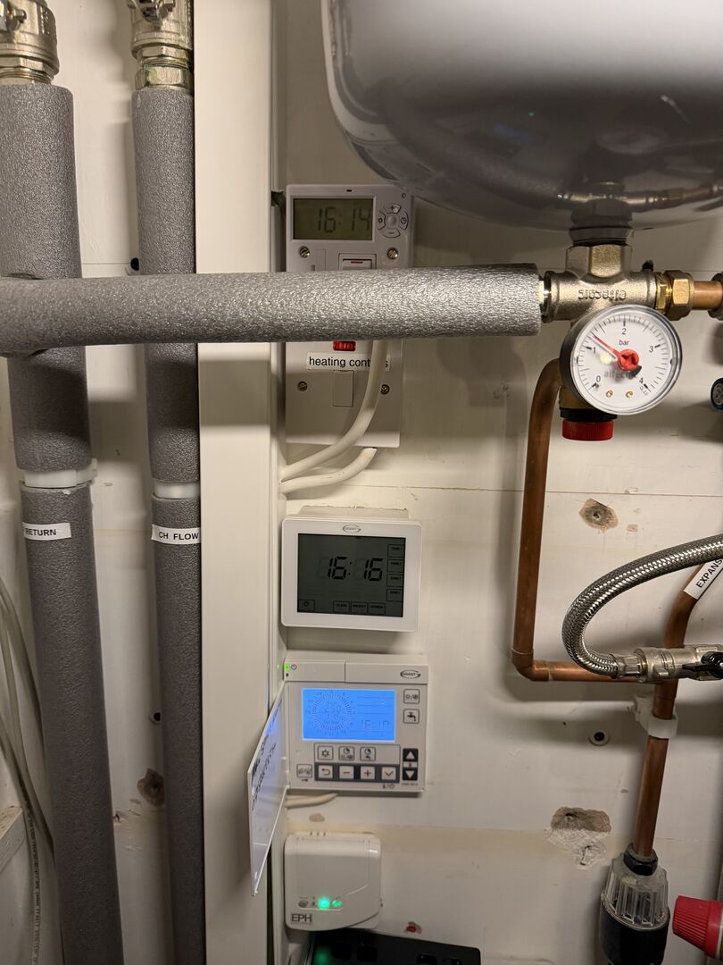

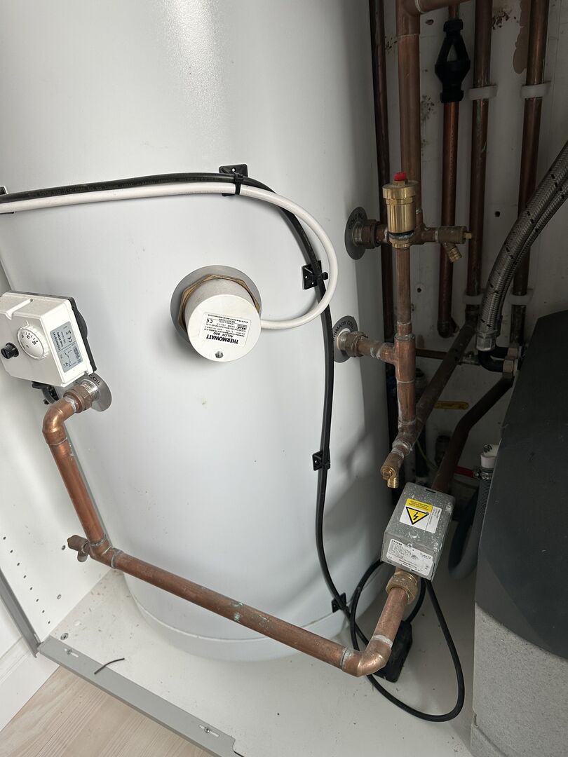

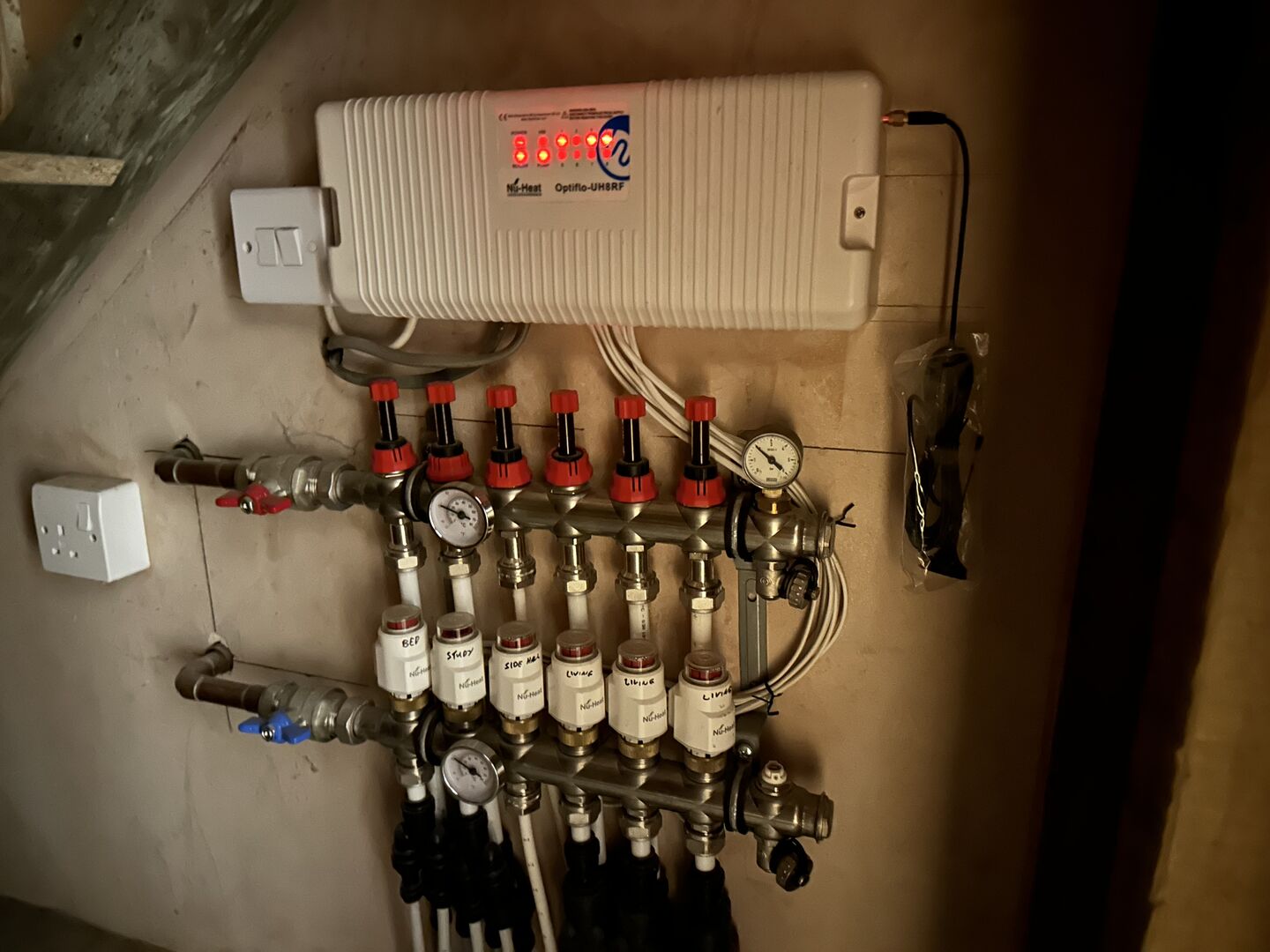

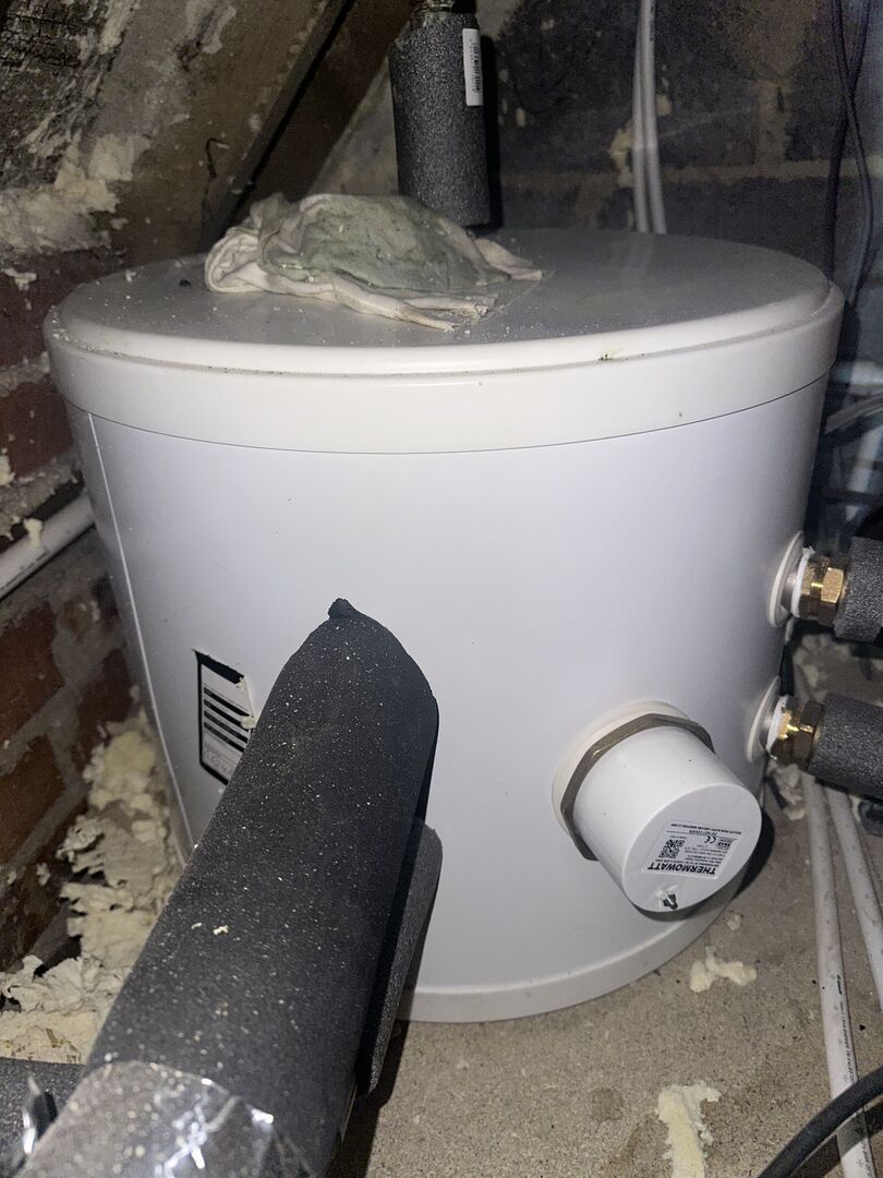

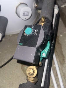

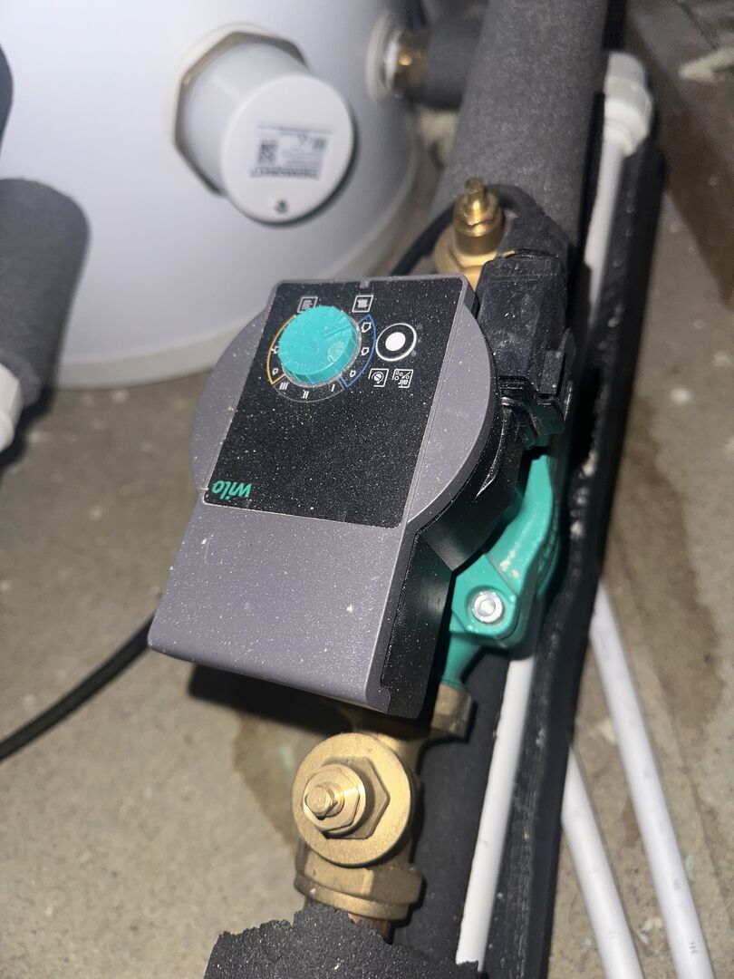

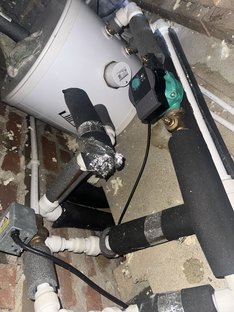

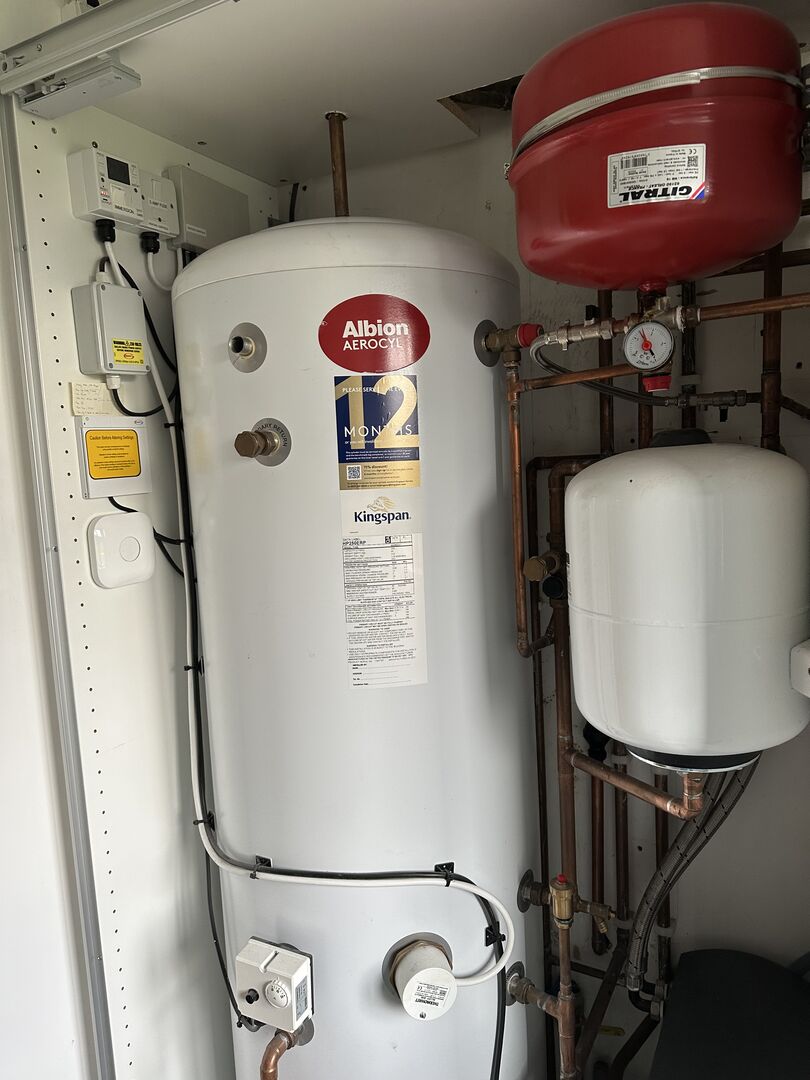

Here’s the pictures
doesnt look to have a normal value to control the heating downstairs only for hot water and upstairs to me but does seem to have a pump for both
there are 2 separate manifolds for the UFH

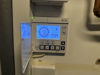

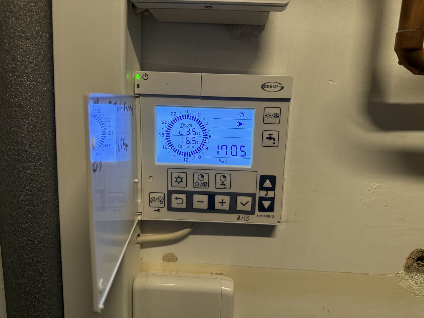

As a followup, I have the Aerona Remote controller, and don't seem to be able to edit and control the device from there. Each time I go to press any of the main buttons just get 3 beeps. Can get into installer mode but can't see any parameters in either the Chofu/Grant manuals to turn this off.
Posted by: @vanqWould I essentially be able to do the same for the Heatmeister as a first step, set all to max then control on the grant? Does that also work for hot water
yes to both, probably. External controls for ashps (and many modern boilers) are largely superfluous and frequently counterproductive.
The possible problem is if ufh and radiators are set up to run at different temperatures which they might be. You need to check this and might need to maintain the mixing function of the manifold. Many heat pumps can control this as well don't know if the Grant can or not.
If it is this controller press the plus and minus buttons and the snowflake button together at the same time for a few seconds this should get you into the installer menu.

@grantmethestrength thanks, yes I did that. But couldn’t get it so I could use the normal buttons (heating schedule, dhw etc) they all still then had an annoying 3 beeps. What did you use?
@vanq my set up which is a pretty standard kit for the Aerona3 R32 has a timer for the immersion (top most box) a timer for DHW (second box down) and the heat pump controller (third box down) and the EPH remote thermostat controller (bottom box). Because why have one controller when you can have four? Cheers Grant!
