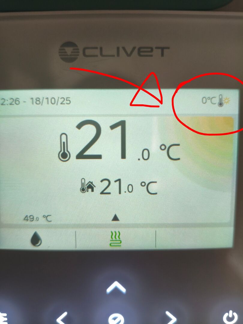

The engineer then came back the following day and replaced the logic board inside the pump itself. This seemed to solve the overheating issue but the room controller then continuously stated then outdoor temperature was zero degrees, despite being 14-15 degrees outside.  I could also no longer remotely control the heat pump via the Clivet eye app (message of heat pump off line)

(@kenbone)
Posts: 49
Can you give me picture of the controller please?
There has been a recent upgrade to the controller, but it won't work with the older units.
You need to have a matched outdoor board with the controller, hot water will work but the heating can do strange things.
is weather compensation enabled ?

@kenbone i
IMG 20251018 122650~2
It's the latest upgraded controller
