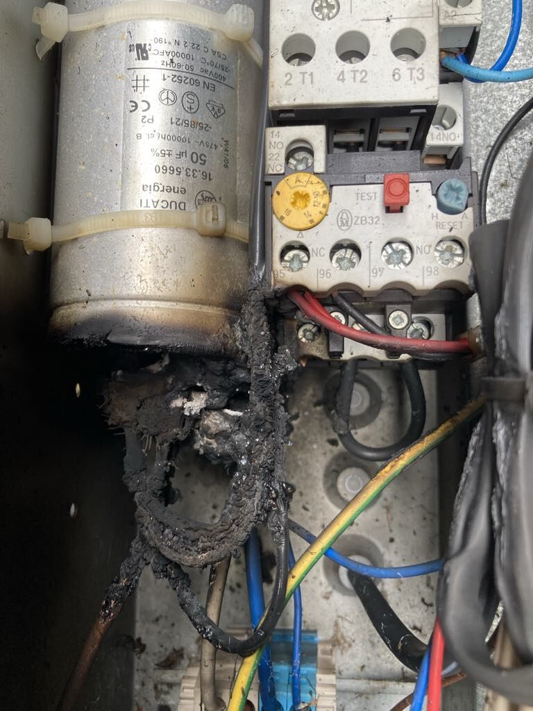

Update: It finally stopped raining and I opened up the heat pump. The attached picture tells the story. Quite surprised that can happen!
So I'm currently searching for an appropriate replacement capacitor for the Ducati energia 16.33.5660
I usually use RS Components, but not looking good. Does anyone know what the modern equivalent is? Thanks. Will let you know if I find it.
Update 2: I've ordered a Ducati Energia 4.16.33.56.60 from TME Electronic Components. Fingers crossed for the new one fitting and me being able to salvage the wiring.

Posted by: @skyefarmerThe attached picture tells the story.

Update: All fixed. Replacement Ducati capacitor is in. The only delay was getting hold of some stranded copper wire of suitable diameter to handle the start up current (approx 16A).
