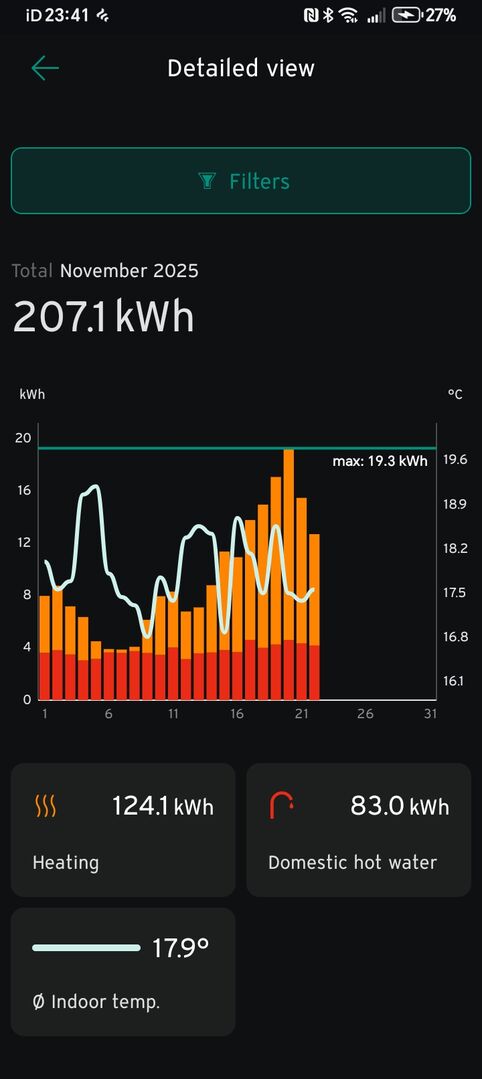

Some Initial Heating Data - Up to 22nd November
The last week or so was the first real cold snap so a good test of how the heat pump performs in cold conditions.
Energy Used
So far up to now up to and including 22nd November:
  • Heating : 124.7kwh used at a cop of 3.73 for the month so far. Cost £8.72 @7.00p/pkwh - (Octopus Intelligent and 18.8kwh batteries)
  • Hot Water : 83kwh at 2.59 for the month so far.  Cost - £5.81 @ 7p/pkwh
Combined total Cost so far this month - £14.53
Cop
In terms of Cop for heating, I have found:
  • around 12/13 degrees - cop is around 500%,
  • 6- 7 degrees - 400%
  • 0 - 1 degrees - 300%
Max daily cop was 502% on 4th November
Min daily cop was 298% on 20th November.
Weather
There have been broadly 3 periods in the month:
Early November Mild weather up around 12-13 degrees - house was slightly overheating at 19 degrees compared to 18 target temperature with weather compensation at 0.1 and flow temperature at 21 degrees running constantly. I had to set the target temp inside to 15 degrees to drop the flow temp to 21 (which is the lowest it will run). I turned the heat pump off due to overheating (to only come on at 15 degrees internal temperature) on the 5th November. The heating was off until the 9th November when the house started to get cold and around 15/16 degrees.
Early - Mid November Heat pump back on around target temperature around 18 degrees - running generally at 25 -29 degrees flow temperatures weather comp 0.1.
Cold Snap Mid November - Heat Pump running at 29-30 flow degree temperature. House is around 17 during the day but at night after curtains are closed, it creeps up to 18 degrees temp. For a couple of nights, I increased the weather comp up to 0.2 to test it and it made it slightly warmer, (increase flow temperature to 35 degrees) but I had to turn in down as it was too warm to sleep. I then put it back to 0.1 weather comp curve.
Summary
Average temp for the month 17.9 degrees. House is 70sqm 1973 build with 300mm loft insulation but no cavity wall insulation.
Overall, the house is much warmer than my previous house with a gas boiler. I went round my parents house on Wednesday night (who have a gas boiler) and it was still 14.5 degrees at 6pm (the heating had been on since 5) but was only just beginning to warm up. It felt cold going from my house that was 17 degrees.
I would expect the heating cop to creep back up closer towards 4 given the milder weather for the rest of November.
I am still looking to improve the building fabric, I have two blown glass window panes at ground floor that I am getting replaced and two new double glazed windows at first floor. I am still waiting for cavity wall insulation as part of the GBIS scheme and have had a survey done.

Screenshot 20251122 234133 com vaillantgroup enduserapp vaillant MainActivity
