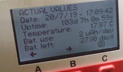

I was one of the first households to be fitted with SMETS2 metering back in March 2019.
As you might expect there were teething issues, and I had the complete set of four devices changed twice more in the following months!
My third (final) GSME was installed on 20th July '19.
The battery life was then reporting 2730 days, which is clearly less than the 10-years predicted lifetime.
... and yes, I have a photo to prove it because I'm a nerd and was actively bug-reporting to OVO.
However, that battery has not lasted the predicted 2730 days.
It actually expired on 22nd Oct'24.
As I've been very busy designing and building prototype monitors for the electricity grid,
I failed to notice that my own GSME wasn't providing any usage data until April'25.
Unlike a Smart Electricity Meter, a GSME cannot retain data because it lacks the power to do so.
A Smart Water Meter would obviously have the same problem.
I've been an Octopus customer for the past few years, which leaves them with the problem of estimating my usage for 6 months.
However, there is apparently an 'approved' methodology for making such an estimate.
It's based on the previous couple of billing periods prior to the outage.
That may seem odd because those month's bills would be for Aug & Sept '24,
whereas the lost meter readings were over a winter period.
What concerns me more is that Octopus themselves didn't pick up the lack of any response from my gas meter.
There are about a dozen SMETS messages which should be requested across the national smart meter network.
'Low battery' is obviously one of those.
Others include the sensors which detect tampering and attempted malicious attack.
That suggests to me that Octopus' own Kraken software system hasn't implemented the SMETS Messaging System.
Since they're one of the very best Suppliers, I'm guessing that most other Suppliers haven't been collecting Alert messages either!
Stand by for an increasingly large number of GSME batteries to start expiring soon.
That'll give Ofgem something to worry about 🤨
