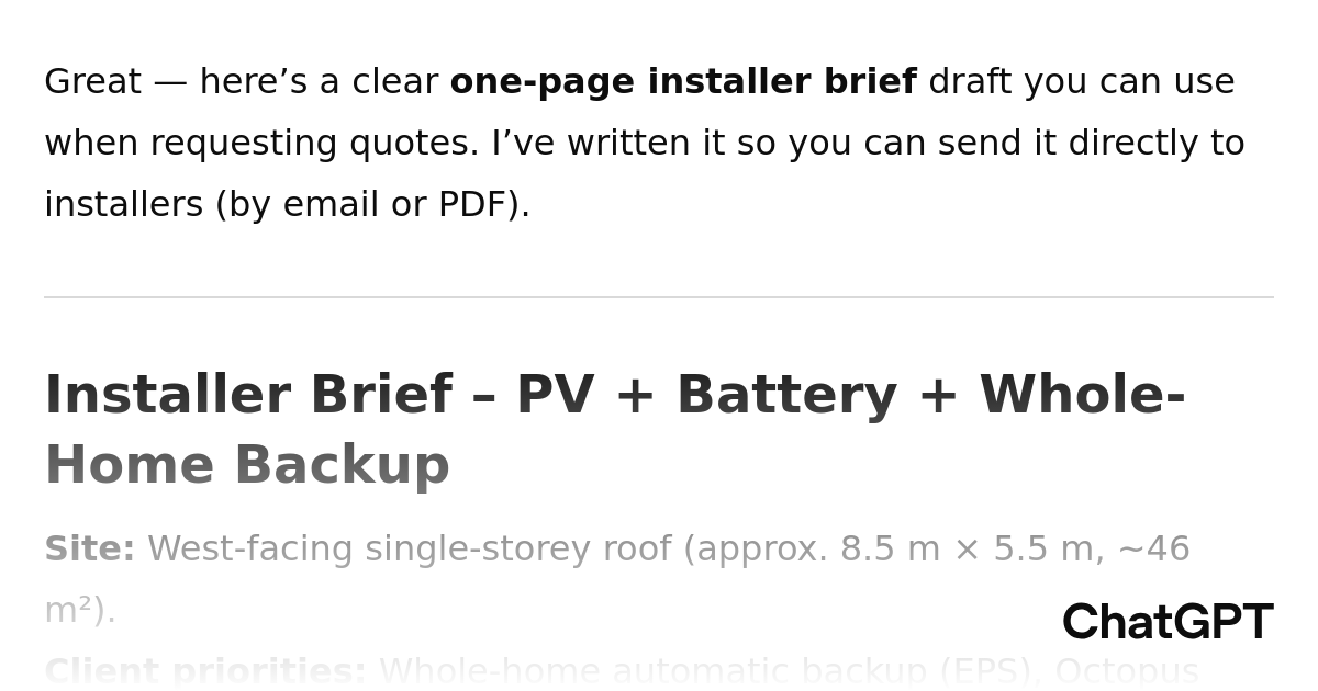

I thought I'd try to use ChatGPT to specify my requirements. Based on
- West facing extension flat roof. 8.5m x 5.5m
- Shaded by main building no other shading
- 9kw ashp
- EV provision via zappi
- PV solar + batteries
- EPS preferably whole home, automated changeover.
- Zappi not part of EPS setup.
- Integration with Octopus tariffs
Pretty good initial suggestions I feel:
Installer brief:
Comparison Table: https://chatgpt.com/s/t_68b7345032188191901a20142eb8177c
Any thoughts/comments? Briefing requirements OK?
