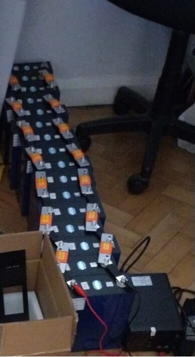

Ah... now I can see a photo,
and that changes the advice I've previously given here.
Firstly you've connected that Power Supply Unit at the near-end of the entire set of 16 cells.

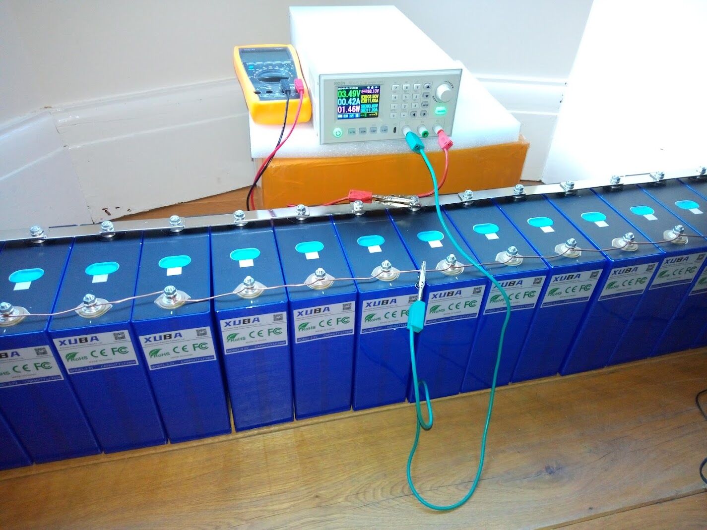

In my earlier photo I had a 12A PSU connected in the centre of the row.
The cell at the far end of your set is receiving electricity which has been passed through 16 preceding connectors,each of which adds resistance.
Secondly, your PSU is connected using crocodile clips.
Those add a considerable resistance.
Fortuitously I've previously done that experiment, and took a photo as evidence:
My 12A supply is recording just 0.42A
This is the major reason why you'll be waiting until 2026 for your cells to charge up 😳
