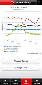

Attached is our tank temp for last 24hrs. I wonder why the water cools so quickly in the tank.

It looks like someone had a bath about 6pm and didn't turn the tap off properly. After the 'bath' the tank heats up immediately, then slowly cools down, heats up again and immediately starts cooling  - in the middle of the night. The temp drop is too much for normal heat loss and it doesn't happen during the day. Or your hot water is draining away some other way...

It sounds like the Secondary Return, re-circulation, as described above is a reasonable contender… your heat loss is significant since it looks about 11 degrees loss in 6 hours. Whereas an indoor insulated tank of around 250 litres with conventional pipework and modest to short runs of pipework seems to lose around 3.5C in 6 hours (5 degrees in 9 hours, recorded in 5th Feb 2023, set at 48 to 38 reheat)

Screenshot 20230911 071132 MELCloud
So with the secondary return pump turned off the new temp chart just shows a bath. I'm going to put the secondary return pump on a timer plug. Thank you 😊

@willen-john wow. That’s a big improvement. 👍🏻
