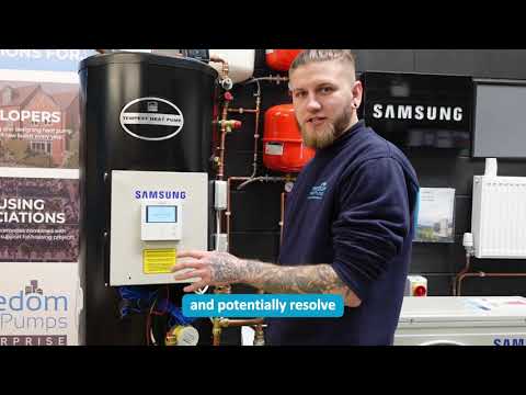

Have you seen this video? Cleaning the filter shouldn’t be a big deal. I shut both lever valves before I clean mine.
Hi, yes ces were a but tardy in getting back to me but Lucy on their helpline talked me thru it. I guessed correctly what to do but wasn't happy unless they were involved. Loadsa crap came out. So now I know. Many thanks.
