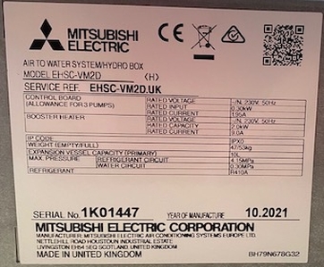

1 - The EHSC Hydrobox was made in UK but the PUHZ in Japan.
