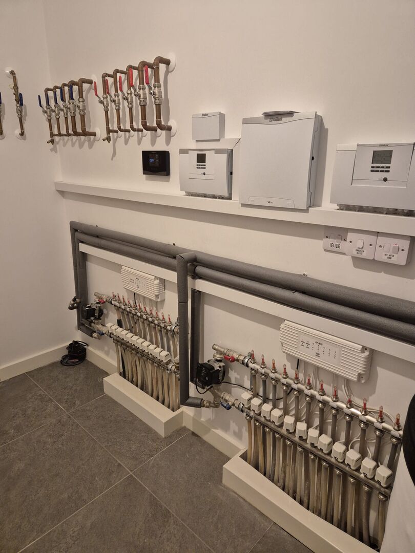

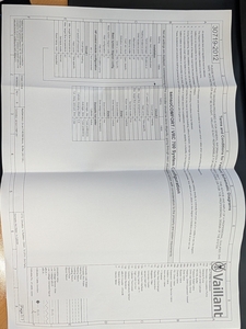

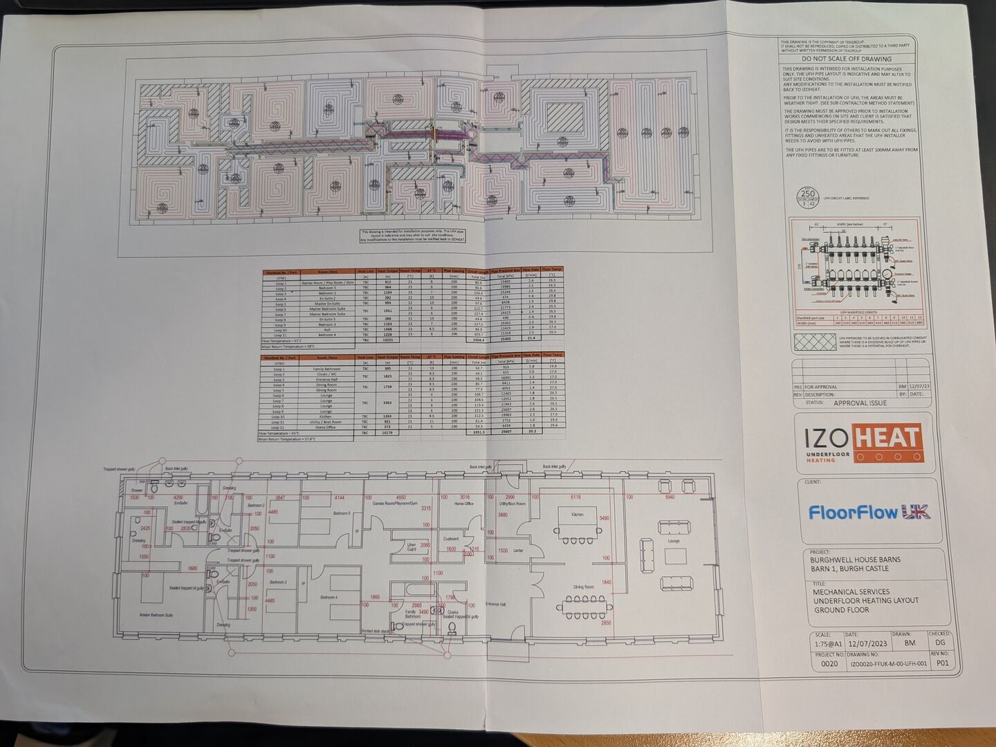

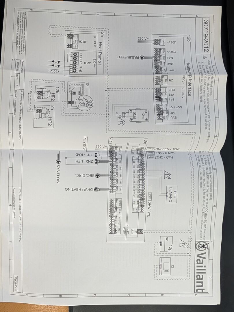

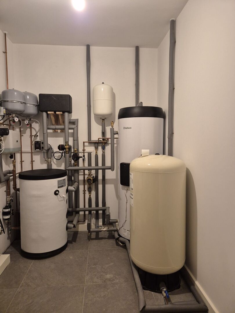

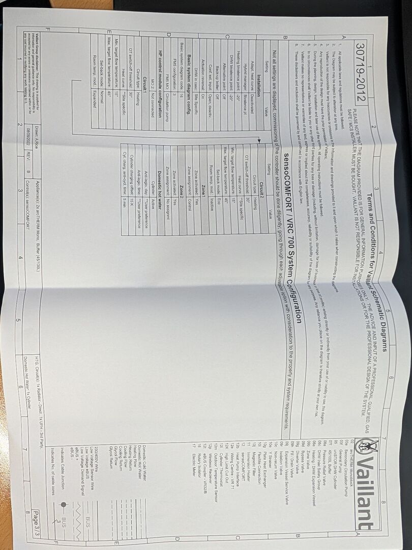

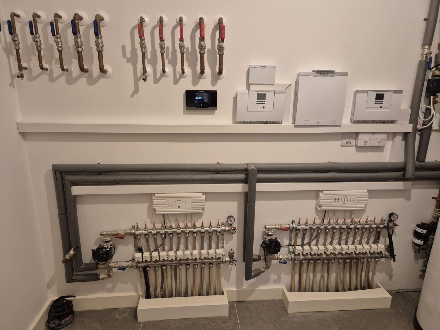

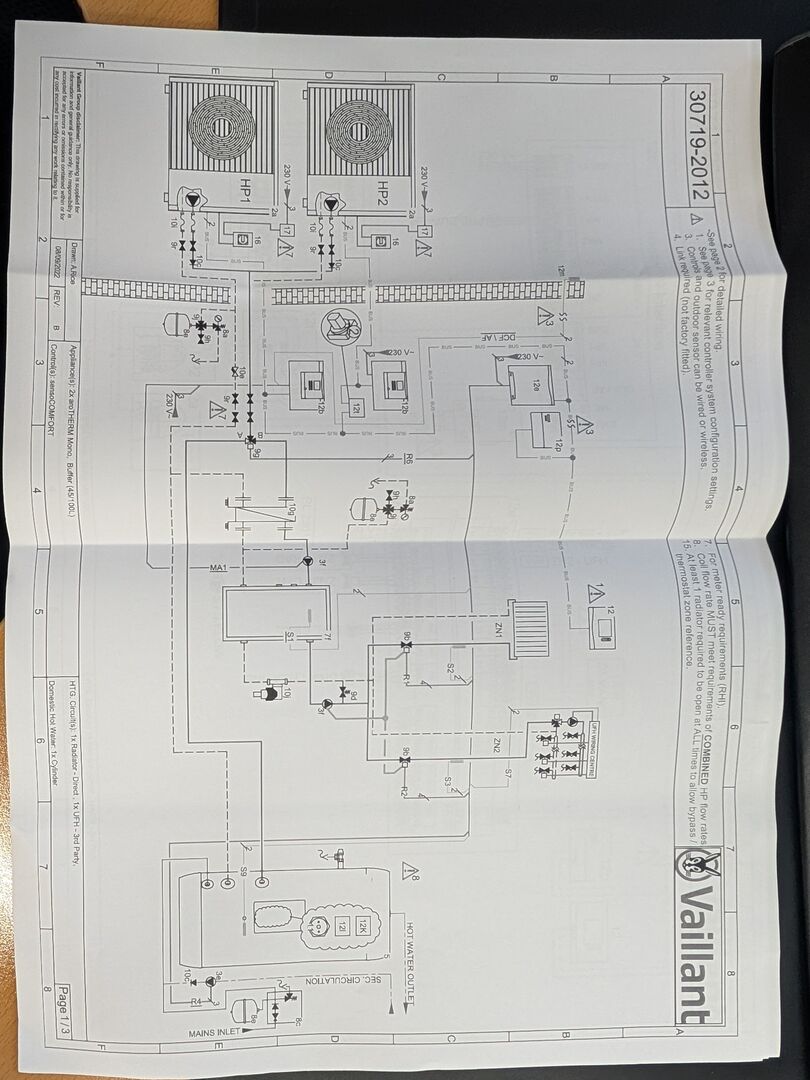

I have found some schematics and also attached some pics of plant room.  Can't find anything regarding the hot water pipe run though
1000030966
1000030967
1000030965
1000030974
1000030975
1000030976
1000030977
Posts: 5652
Nice neat plumbing job!  I cant see the plant room on the rather low resolution plan.  Where is it?
Also the key drawing 12327-1000030975 is too low resolution to read (and rotated through 90 degrees).  If you would like to repost in higher resolution and the correct orientation it might be possible to work out.  A legible version of 12329-1000030977 would also be good.

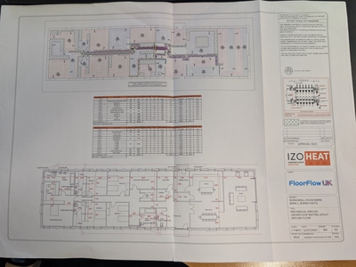

(@paullacey)
Posts: 8
@jamespa
PXL 20251028 081156923
PXL 20251028 081150690
PXL 20251028 081203982
PXL 20251028 081137463
Are these any better as these are directly from my phone from pictures I've taken
Posts: 5652
They are better but still difficult to read.  Can you please upload the image files rather than pasting them as images, then they can be downloaded at full resolution and rotated so that they can be read easily.  Also where is the plant room on the plan.
These are certainly what's needed to work out what's going on and, as they appear to have been produced by Vaillant, you may also be able to get help from Vaillant if it cant be diagnosed here.
(@paullacey)
Posts: 8
@jamespa
the plant room is next to the games room/playroom/gym
Posts: 5652
Posted by: @paullacey
@jamespa
Thats a blessing, at least its in the middle.  If you can post the files as opposed to pasting the images I will take a look at them, it should be easy to work out, they are exactly what is needed.
(@iaack)
Posts: 63
@paullacey From the diagrams I assess you have 2 heat pumps plumbed in "tandem" but controlled in "cascade". What the second heat pump can do is the same as the first one, but only if commanded to (cascade).
Think of a tandem bike with 2 riders. Either rider could provide energy to propel the bike. Now think of a set of instructions; rider one pedals on the flat, rider two must assist only when the speed falls to say, 8 mph.
In this scenario if rider 1 becomes exhausted, rider 2 takes all the strain.
If heat pump one struggles or totally fails in any way the 2nd heat pump can still perform some limited heating.
