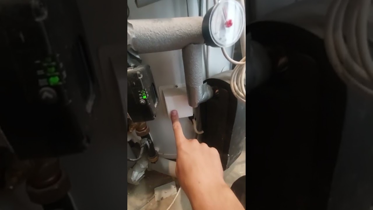

This one is a good explanation of different heating modes
and this one for timing heating/HW.
https://www.youtube.com/watch?v=FE9GfGLzsDo
