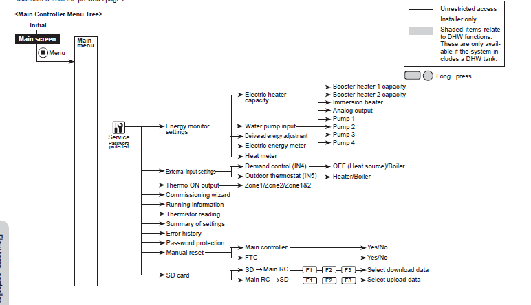

To check the flow rate you go into the service menu, scroll down to running information and enter 540. The displayed number is the flow rate in l/min.

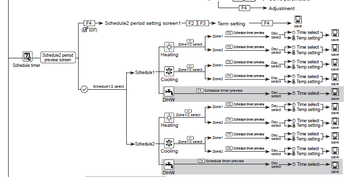

The schedule function on the Mitsubishi is potentially confusing as it seems to combine DHW timing with space heating timing. Is it possible someone has accidentally fiddled with this?

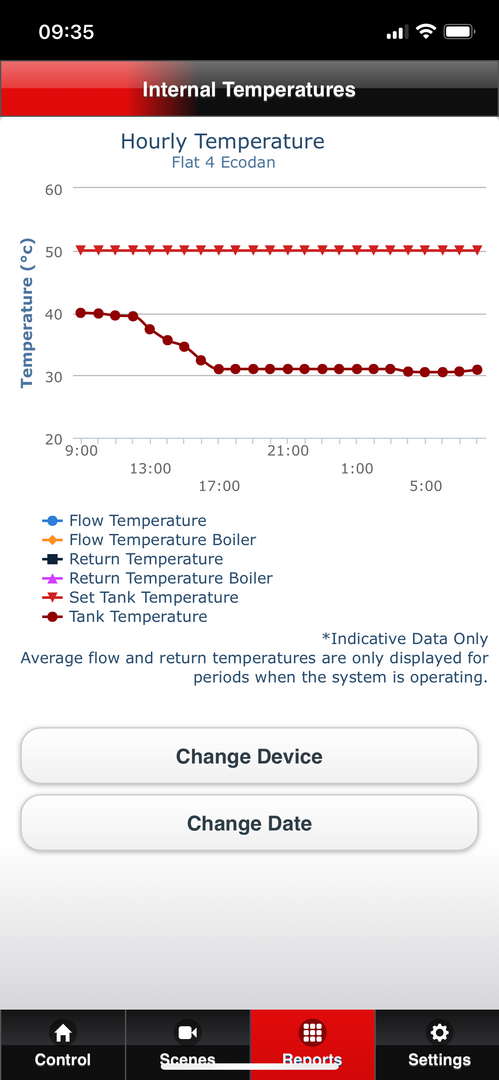

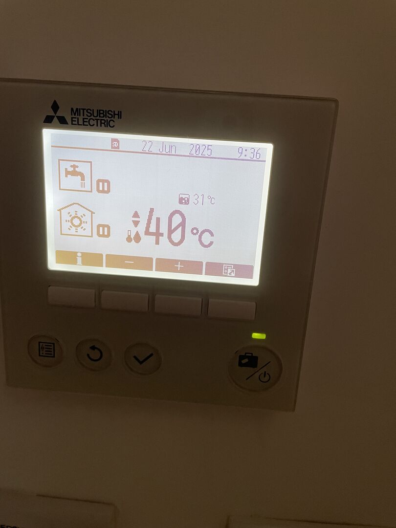

A couple of pics. One shows temperature of water in tank (report from MELCloud app) over course of 24 hrs water in tank dropping to close to 30C and a pic of the controller confirming water. Tank at 31C but not demanding heat.
@m1kegibson Hi, looking at the melcloud it looks to me that it stops heating the water at 40 DegC, this is set to low and it will fire into hot water mode when it hit 29 or 30, they often come out the box with a 10 Deg diff, so if set to 40 (Max Lim) it will wait until 30 before it fires up again.
The reason it probably works when reset is the ecodan when first fired up looks to satisfy DHW as it treats this as a priority. This will work regardless of the temp below the set point until set point is reached.
The only reason I can think that the melcloud is saying it is set to 50 but it is stopping at 40 is max set point DHW settings?
Just so you know, the quickest way to fix this if it is a programming error is to call Mitsubishi electric, they will log on through the app and make the settings correctly, they have an amazing customer support and can fix this if it is just installer settings.
Looking at those photos I agree with @ashp-bobba.
To put it another way it looks like its targeting a DHW temp of 40 not 50, which means that it will normally start reheat only when the temp falls below 30 (assuming the default hysteresis of 10). Reprogramming/correcting the programming is likely the answer.
