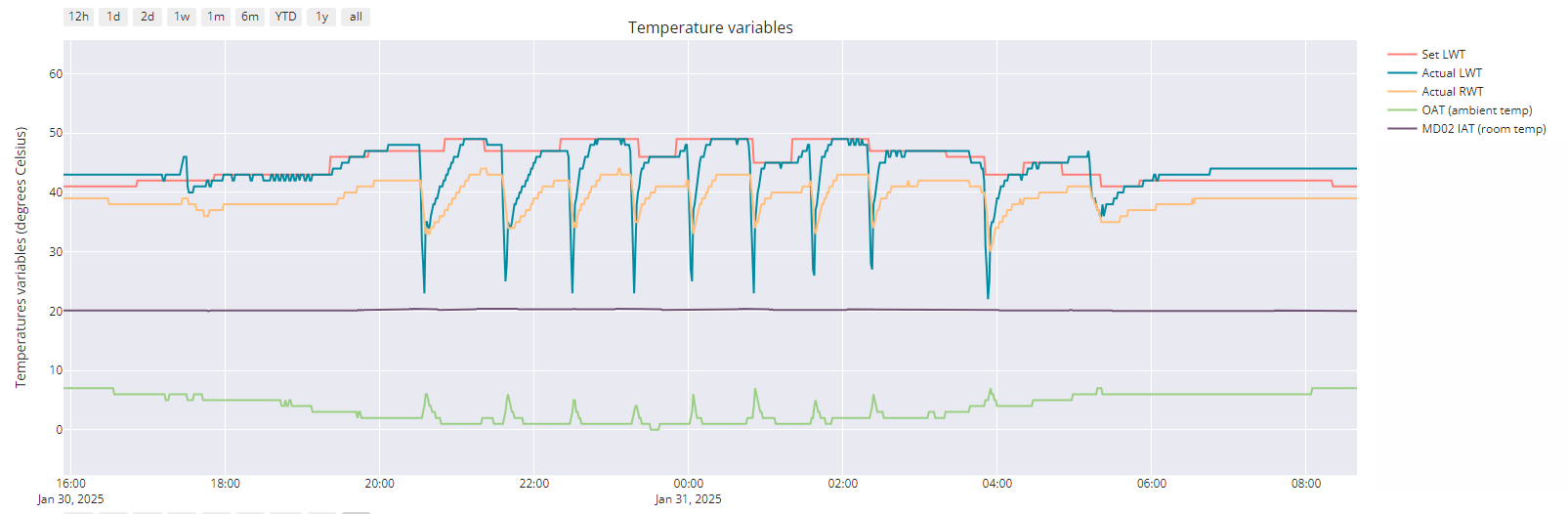

(a) but I do have the WC set properly, see past posts of charts of my IAT, eg this one. There is simply no need for room stat interference:
(b) I don't want independent control in each room, never said I did, so no need to fix a problem that doesn't exist with devices (TRVs) that will almost certainly compromise performance. Ages ago, I looked at all of my TRVs, and said "Off with their heads!". They have remained decapitated ever since.
My problem (distant room a bit cooler than ideal) isn't your problem, you don't need to fix it, and I haven't asked you to do so. It's not a bad general principle that you don't 'fix' people/things, unless and until the person asks for a fix. As it happens I have already come to my own conclusions (pipework obstruction) and remedy (live with it), as previously posted.
