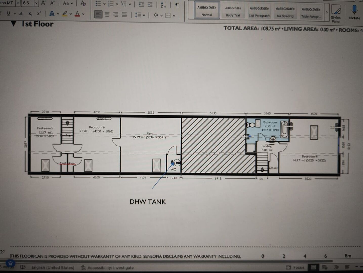

Returning to the set of 14 photos on the previous page, can someone else please clarify that Pic.1 is of the Domestic Hot Water (DHW) tank
and Pic.2 is a buffer tank in a different location?

Im presuming that the buffer tank is shown in the second photo and the DHW tank in the first.
If Im right then the buffer tank is too small to give adequate stratification (even if it were properly controlled) and thus mixing is inevitable. Given that the load is dominated by the UFH running, presumably, at 35C you potentially have return water from the UFH at 30C mixing with flow water at 50C significantly diluting the flow temperature of the water to the emitters. This is an efficiency nightmare and is hardly going to help performance. I would love to see the design calculations for this side of the for the system, but doubt there are any. My guess is that the installer decided to 'fit a buffer tank so that he didn't have to bother worrying about the existing system', except that he was wrong in thinking that.

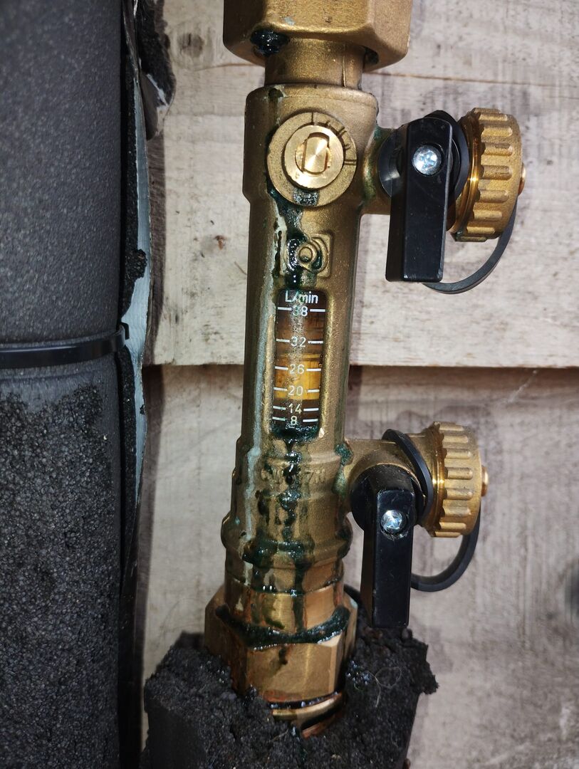

(2) Are there any leaks? Yes there is a small amount of leakage from the pipework in the following photo. What actually are those valves? How big an issue is this? I would raise this with the installer as another thing that needs resolving.

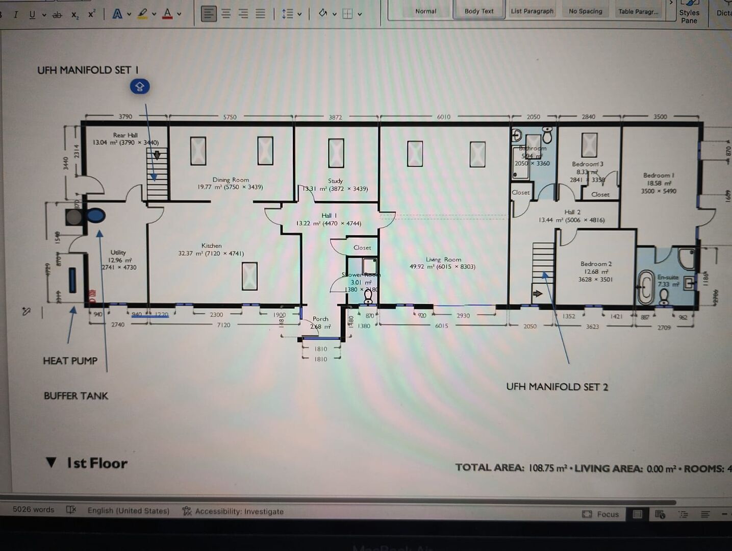

(3) Regarding system positioning and historical performance issues, I attach photos of the ASHP position, the buffer tank position, the DHW tank position and the position of the 2 sets of UFH manifolds.
You won't be surprised to know that the worst performance in the house are bedroom 1 and its en-suite. They are furthest from the ASHP and also are some of the only rooms that have 2 external walls. They face down a valley, from which all the winds and rain come, making this the coldest end of the house even with no heating on. At the moment for example, with no heating on, the kitchen end of the house is 21.5C and those rooms are at 20C.
During cold periods, those rooms have been as low as 12C when the external temperature has been below 0C. Bear in mind that I had always been running on set flow temperature not WC and with radiators off.
You should also know that the house has multiple zone thermostats (as it did when we bought the house) which are wired into the UFH manifolds to call for heat, when the temperature of a zone drops below desired temperature. Some posters have mentioned room thermostats as being negative but in a large house, how else do you control the temperature of zones that you don't want to be the same. As you can see in the scope document, the desired bedroom temperatures are 3-4 degrees below that of kitchen/study etc.
