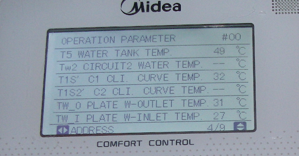

I'm pretty sure the Operation Parameter values shown on the wired controller come from the heat pump, if only because the data cable runs from the wired controller to the heat pump, and doesn't go anywhere else. It may or may not also report the indoor air temp at the wired controller, but as mine is in the airing cupboard, I don't take much notice of that. The outdoor air temp is not what it says it is, it is instead most likely, though not 100% certain, the air intake temperature somewhere inside the heat pump, and is subject to various influences that at various times @jamespa and I have tried to understand. Nonetheless, this outside air temp is what the wired controller used to get the WC flow (leaving water) temp - but it is not the actual outside air temp. Go figure, as the say...
The wired controller (and modbus if in use, as it is in my setup) values I use for the flow (output, leaving water) and return (input, returning water) temperatures are on screen 4 on the wired controller Operation Parameter pages (see image below, the bottom two rows, 31° out, 27° in in the image) and are in modbus registers 104 (in) and 105 (out). The two sources report the same values.

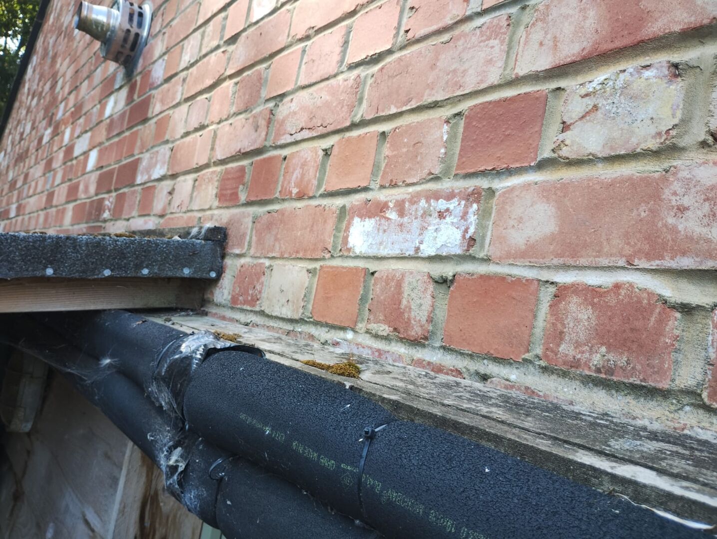

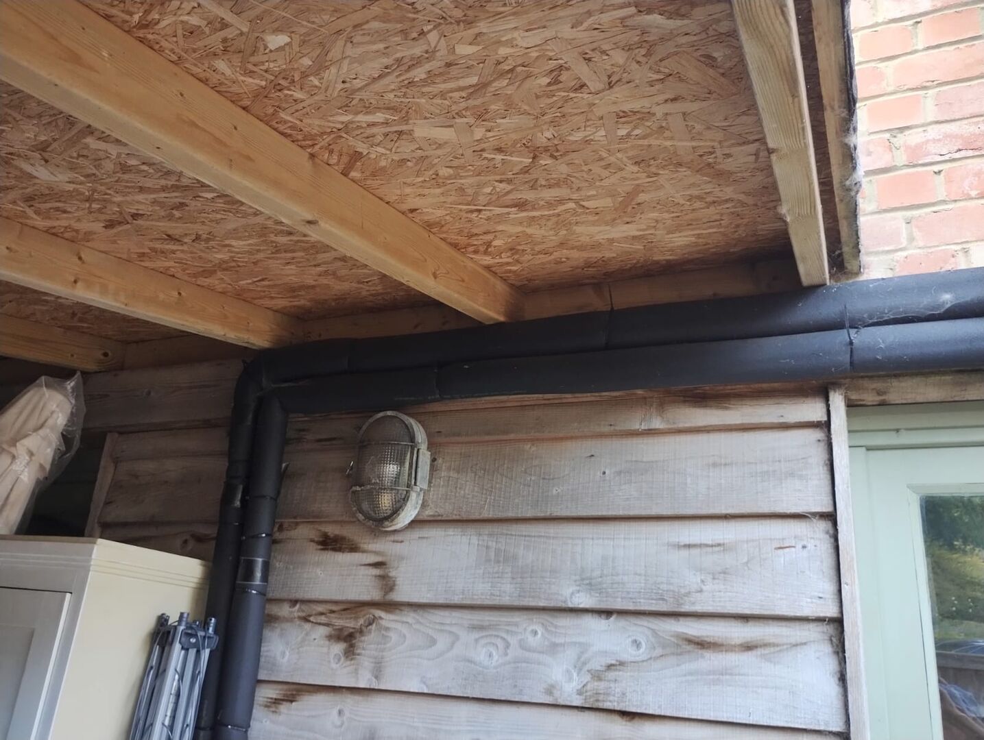

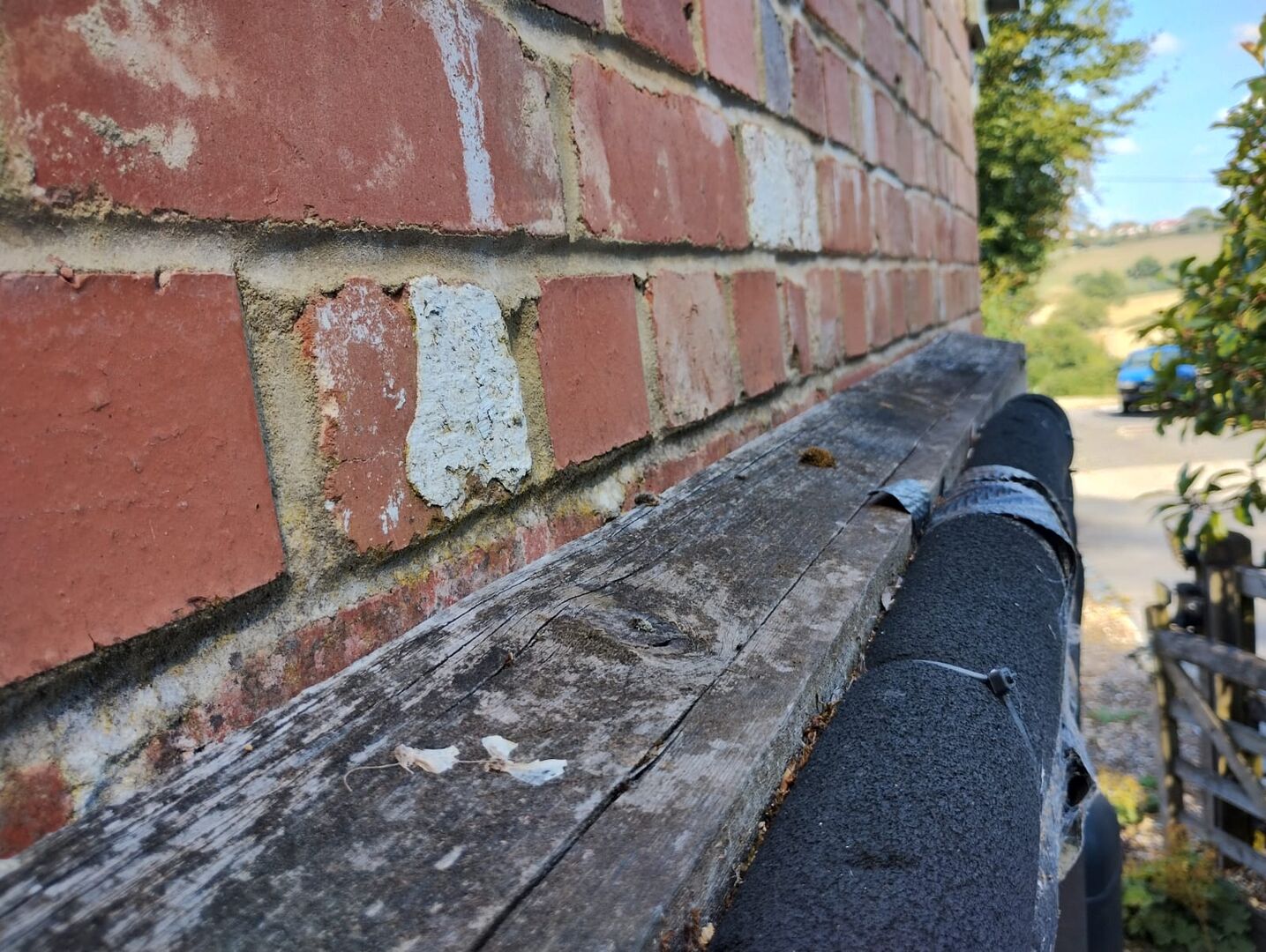

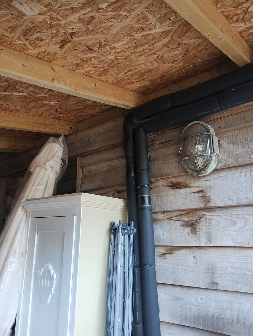

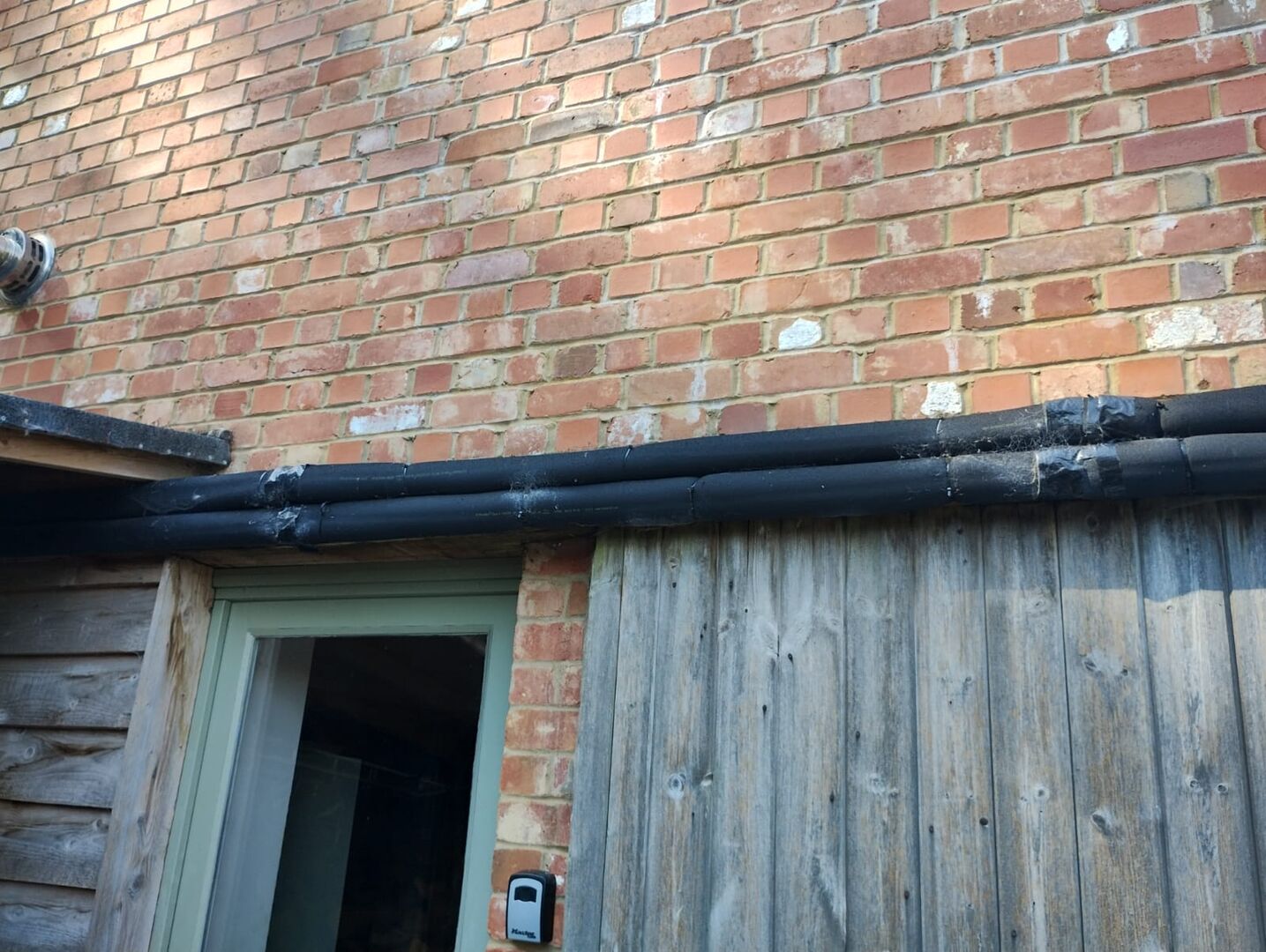

@cathoderay the in/out temps I posted were from the same screen you showed. I only first got into these kind of screens this year after being fobbed off again by the installer. External pipework photos attached. Total run is about 4.5m
