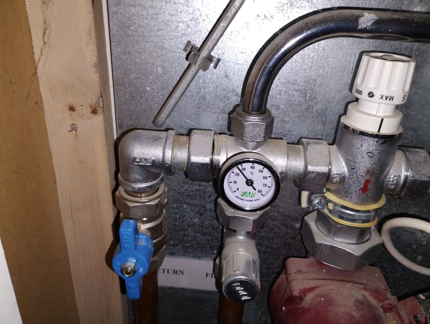

I'm happy to try what you suggest though if you think that will give us useful information. How do I measure the temps on the four ports of the buffer (sorry don't know what that means). By measure temps at beginning of UFH loops do you mean as shown in attached photo where I have one of these gauges for each loop (so 2 of these
and one for each room?
