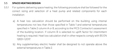

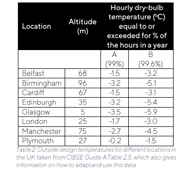

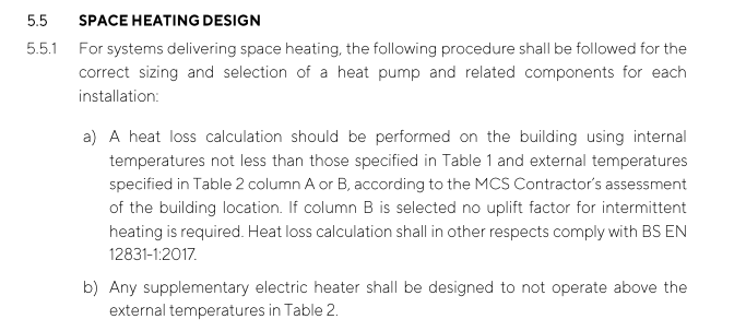

In addition to the BUS requirements there are also MCS requirements (MIS3005-D), which may clinch the matter. These include this
Seemingly this says that supplementary heaters may be included, but only for operation below the design temperature. However this text is followed by some 'get outs' which could well allow a supplementary heater to be included within the MCS rules, so then the barrier reverts to the BUS rules.
Not entirely helpful I admit, other than to say I don't think there is an absolutely definitive answer. If pushed I would say that relying on an external backup heater at the design temperature is doubtful, however if you can find an installer to do it (which probably you can) the risk is very small. Maybe someone else can give a more definitive interpretation.

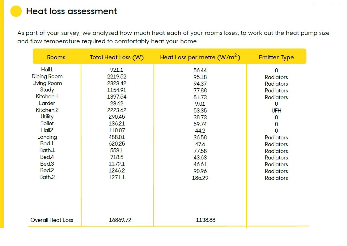

Wow @jamespa thanks so much for this - I am lucky enough (in our very hot summers!) to live in Somerset in an 1840s vicarage made of blue lias stone (external walls c. 450-500mm). It's approx 300m2, with a very large loft space and a cellar (both insulated). Most walls have no added insulation, some wooden floors downstairs are insulated, the rest are blue lias flags. Modern double glazing throughout.
The new 40m2 kitchen extension is to current building regs. It IS quite a cold house - partly due to the very open staircase (skylight above) so the heat escapes upstairs (we're adding a new rad in the hall to counteract/create an envelope I think it's called).
Attached is the heat loss estimate - my bad, it's only 16.9kW, so a small win!
It is going to be high loss. I have heard that the commonly assumed U values for stone walls is way to high, and the air changes is also often too high, so it still might be less than you think.
Do you have any way to get an independent handle on loss - eg if you heat it reasonably well most of the time your total annual oil consumption. If you can convince yourself its in the 12kW region then the backup heater becomes a true backup and the argument may go away

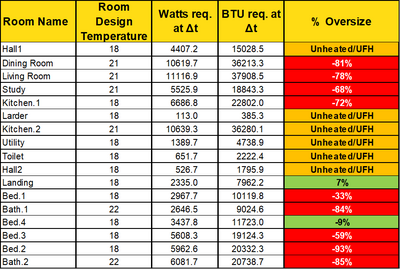

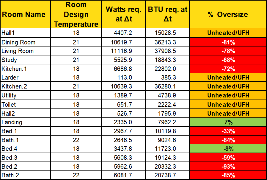

Our overall intention is to change the rads over time to get us closer to 35 degs FR within 12-18 months eventually negating the UFH inefficiency. Wall insulation not possible, but we will look at additional loft and underfloor.
I attach the rad breakdown from Good Energy - of course real world, we almost never have the rads on in the bedrooms or very low.

You want to aim for open loop operation on weather compensation only, no buffer, LLH or PHE between emitters and heat pump (you may need a mixer for the UFH until you have changed the rads). No fancy controls unless very specifically designed for heat pumps (Homely, Adia, Havenwise are the only ones I am aware of that qualify). No fancy proportional control thermostats, no hives etc. Preferably just 1 thermostat turned up 2C above target temp, TRVs if fitted mostly 2C above target temp.
Without knowing more about your house I cant be precise, but in general the fewer controls the better. Fortunately the Vaillant controls are pretty good, possibly the best amongst the 'upper mid market' heat pumps.
