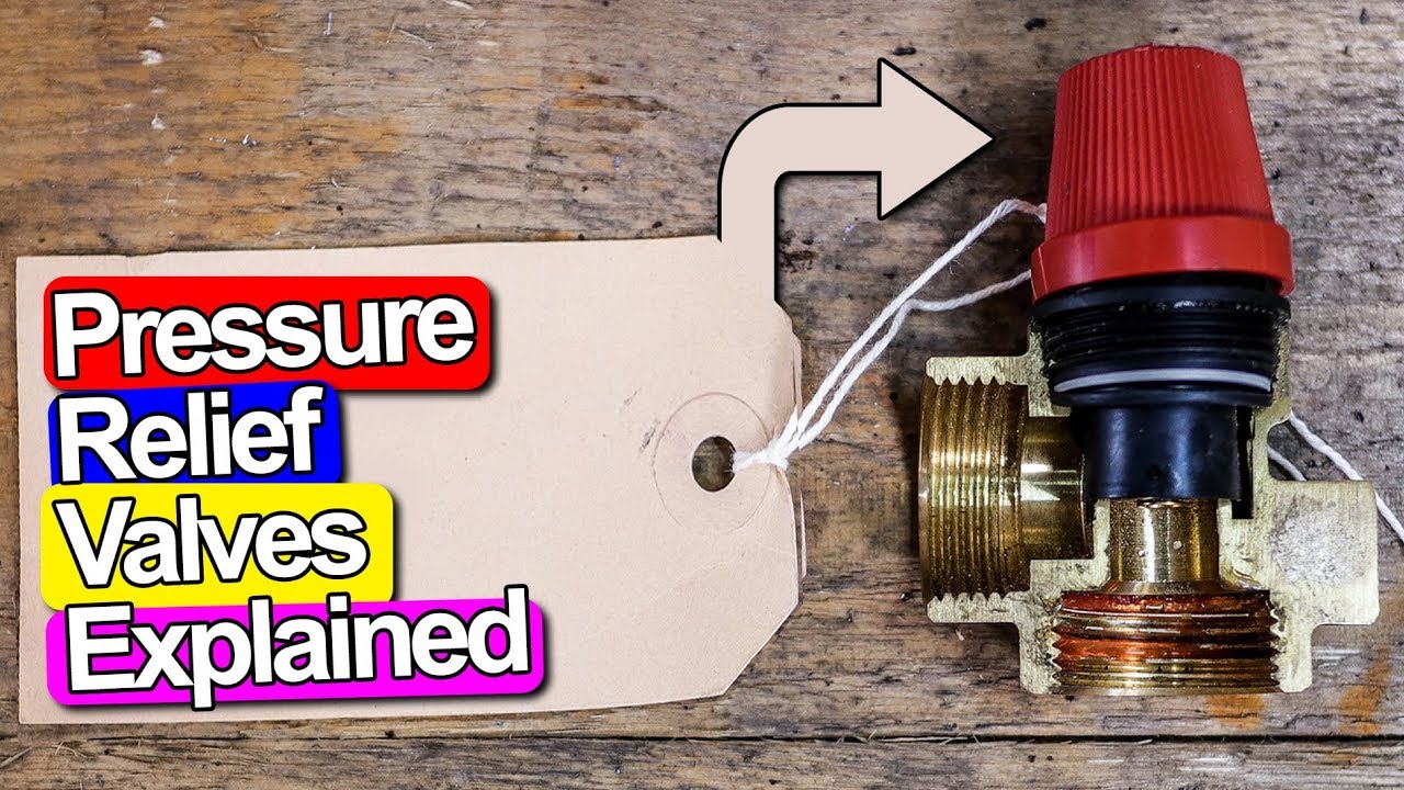

Is the water actually still flowing out?
That looks like your pressure relief valve doesn't get the chance to close back, have you tried to stop/close the water supply to the tank to allow the pressure to drop in the tank in order for the valve to close? If that's the case.
Might be one in a million change that it caught some debris/smudge that blocks it.

(@fazel)
Posts: 124
@marvinator80 if the explanation from the video it's true in your case, the cause is fluctuation in water pressure coming from the supply, if this pushes out the valve, the valve doesn't close back until pressure drops under a certain level(close supply and open taps). If it will happens often you will have to call the plumber.
