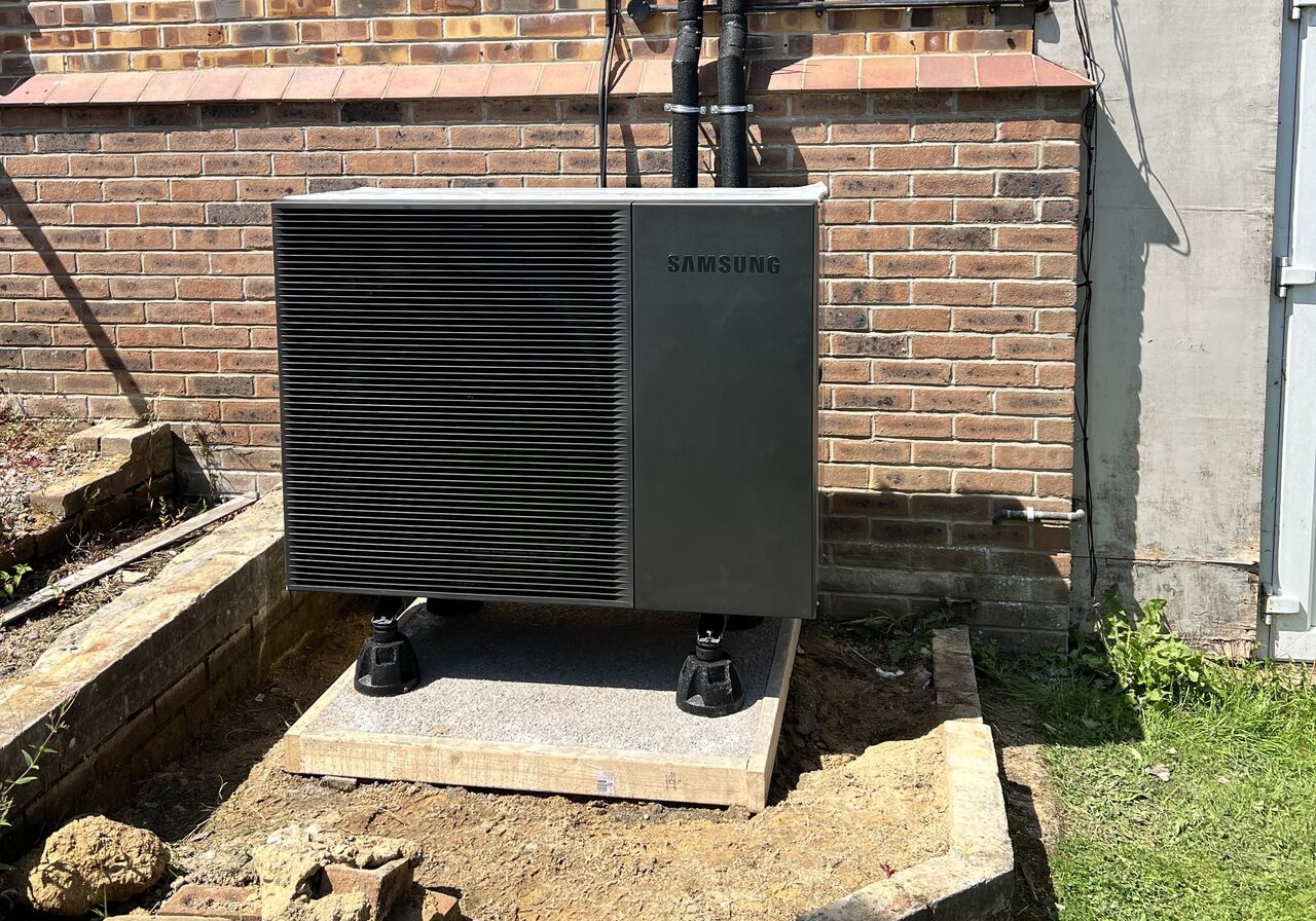

3: Heat pumps are often supported by heavy rubber 'feet'.
Here's one as sold by BES
Depending on where you live, this may be all that's required.
However, there are places where heat-pumps get stolen by 'gangs' who come equipped with a trolley jack. 😥
The ASHP itself will invariably have bolt-holes by which it can be secured...
... in which case you might want a concrete pad to bolt it onto, rather than rubber feet.
There are a number of types of 'security bolt/nut' which can be used, rather than a hex-head which could be removed with a spanner.
That means a thief would have to use an angle-grinder on the bolt-heads... which is noisy and attracts attention
Some installers might suggest fitting a couple of strong eye-bolts into the wall behind the heat-pump before it's in position.
A hefty chain can then be used to secure the unit to those eyes.
No mechanism can be completely fool-proof.
Given enough time, a gang could use bolt-cutters, angle-grinders and sledge-hammers to bag themselves a nice new £5k unit sitting outside your house.
The idea is to make your heat-pump less attractive than all the others in the neighbourhood!

Similar to what @transparent mentioned, the Zeus Articulated Mounted Feet have been widely accepted in the industry for providing stability: https://renewableheatinghub.co.uk/straight-steady-why-your-heat-pump-should-be-level
