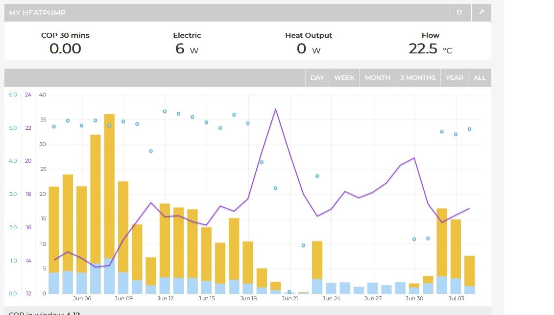

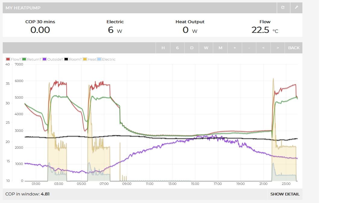

My Samsung Gen 6, keeps coming on intermittently to run the heating when the weather is warm. Im running it on weather compensation, but also have the control unit in my lounge to limit it when the lounge reaches temperature. At the moment I have the lounge stat set to 16C. As you can see in the first graph my room temperature never got below 20C, so by my logic the heating should be off.
The second graph shows how some days its on and others its not!

@editor Thats correct. Its not particularly cold but the purple line in the first graph shows the outside temperature. Its shows that the heating came on at 9.30pm when the outside temperature was about 16C and the indoor temperature 21C.
