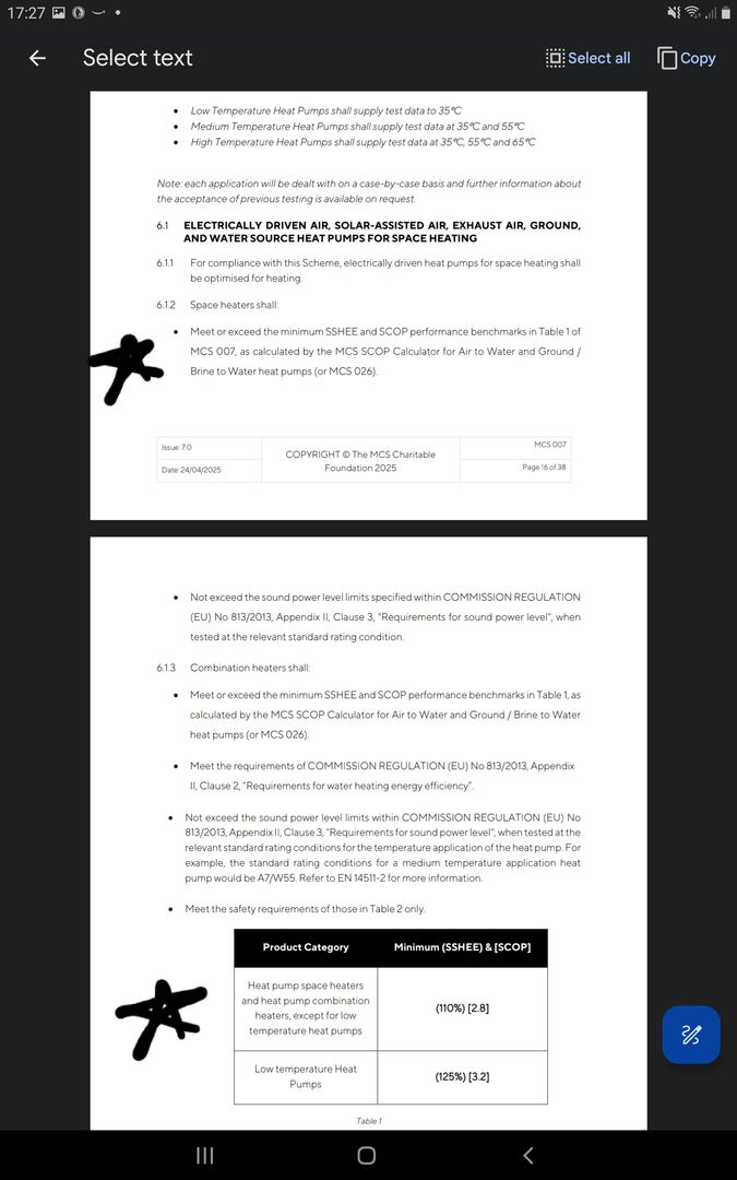

In the interim I finally found the MCS SCOP performance requirement in MCS007 as below:
ie. Its based on output from MCS SCOP calculator (mine apparently said 3.8 when its 2.3). Compliant minimum is 2.8 and MCS claim no responsibility for their predictions. Hopefully its input error.

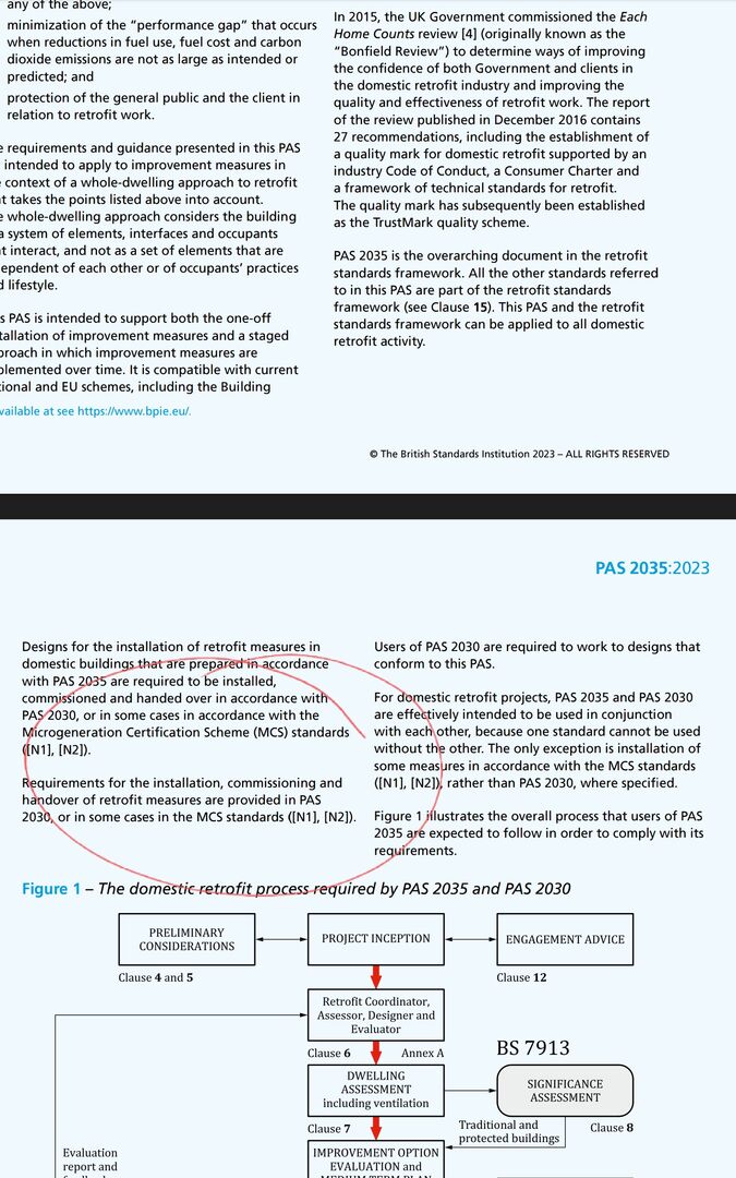

Also PAS2035 stipulates MCS N1&N2 which I can't find. Anyone?

Regarding the requirement for the SCOP to be a minimum of 2.8, from https://assets.publishing.service.gov.uk/government/uploads/system/uploads/attachment_data/file/1026446/clean-heat-grant-government-response.pdf
"Government response
We will require that all heat pumps have a minimum SCOP rating of 2.8, an increase from the minimum SCOP rating of 2.5 on the domestic RHI. The system efficiency will be evidenced through the MCS certificate submitted by the installer at the point of voucher redemption. There will be no ongoing obligation on customers or installers to report in-situ system performance."
So it seems the regulations of a SCOP of 2.8 is just via the MCS calculation on the certificate and not actual system performance.
"PAS2035 stipulates MCS N1&N2"
N1 and N2 are references within the document, see normative references on page 10. The bibliography on page 54 says:
[1] GREAT BRITAIN. Climate Change Act 2008. London: The Stationery Office.
[2] HM GOVERNMENT. Net zero strategy: Build back greener. London: BEIS, 2021.

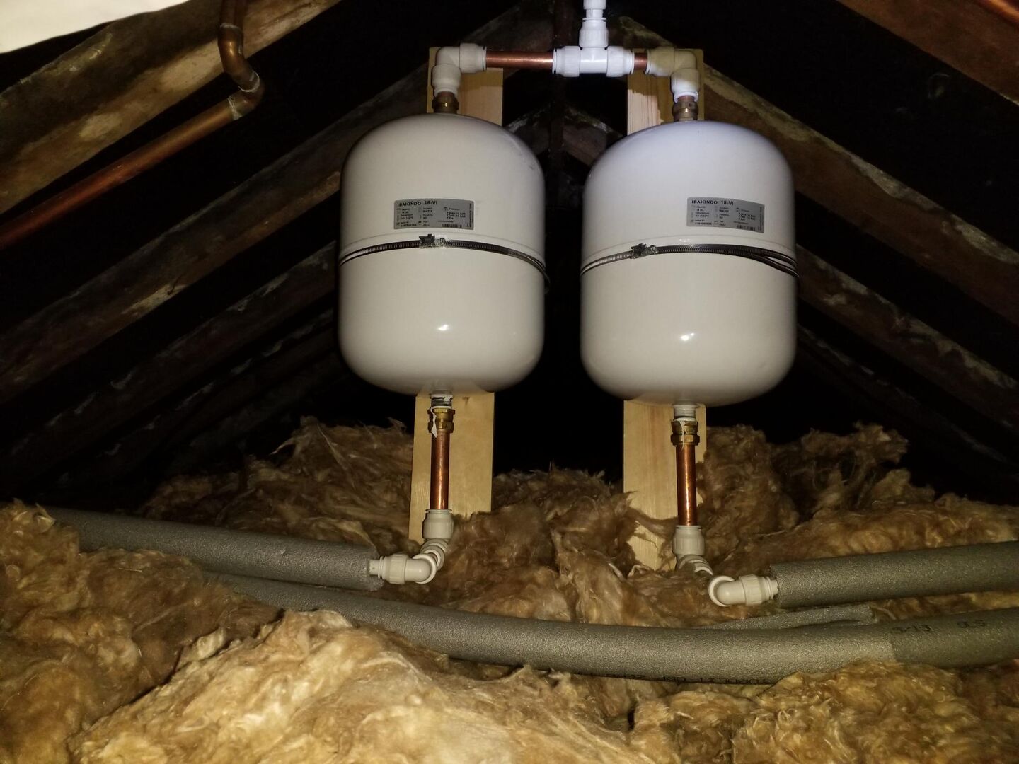

I've already included the "reasonable skill and care" requirement as a reason for having selected the 5KW system as it definitely wouldn't require a volumiser and meets my heat loss.
Either way you'd hope that doubling my volume and locating half outside of the heated envelope of the house like this without any consultation is unreasonable.
P.S. the tanks themselves are held in place to the woodern struts (both of which have been split) with the jubilee clip alone and pipework is balanced on 30cm of insulation unsupported from the eaves.
All smacks of poor design for which the retrofit co-ordinator/designer has ultimate responsibility who's role is defined by PAS2035 and scheme provider code of practice. In my case I had no communication with one at all.
NB. Under current plans MCS won't be requiring scheme provider membership, lets hope they've developed a more robust requirement for adequate assessment and design and its appreciated that every document I received was incorrectly populated.
