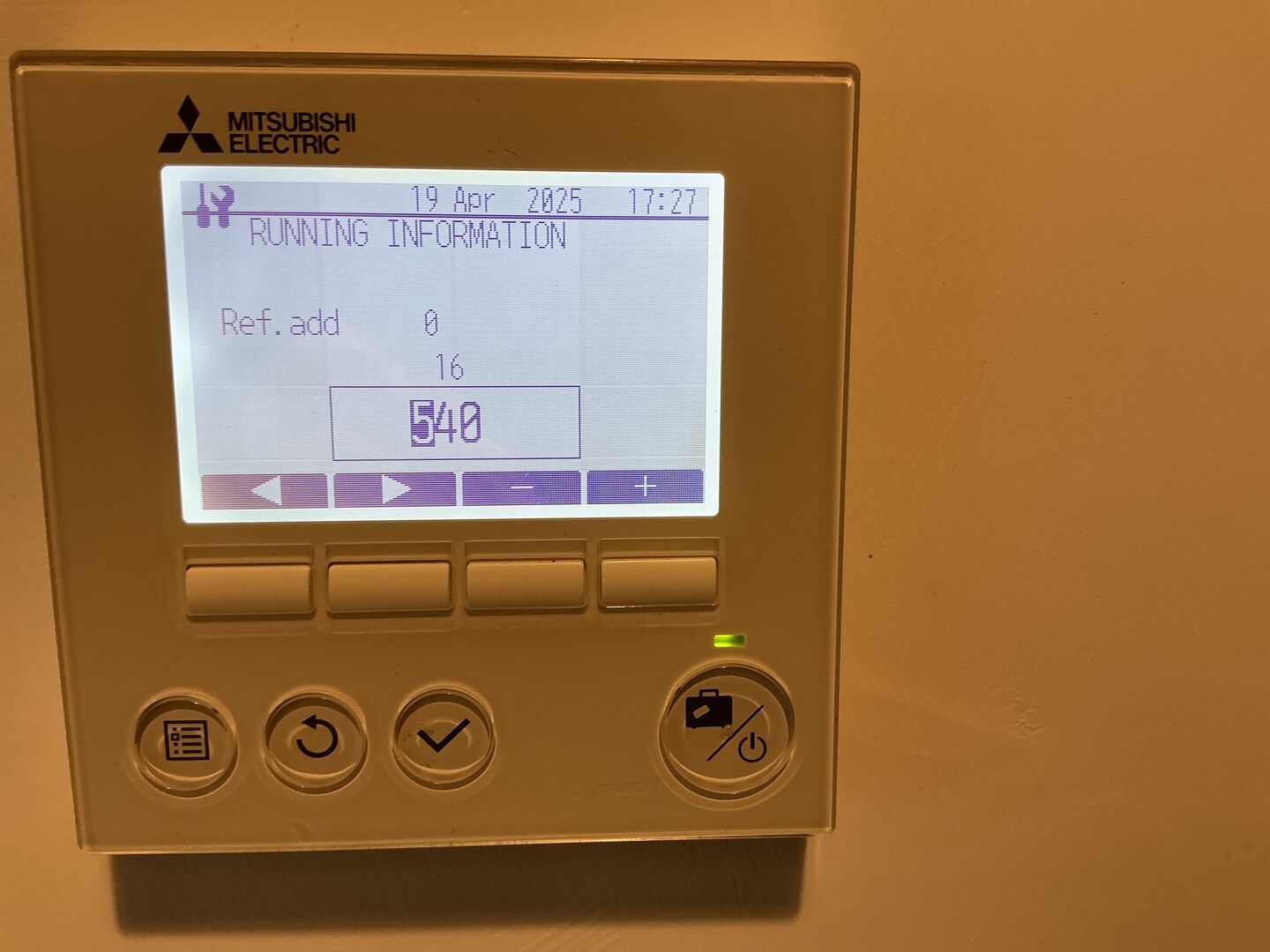

L9 indicates a flow rate issue when the system detects less than 5 l/min. The Mitsubishi ME Engineer App includes specific checks for this scenario.
The Homeowner Help-Line may request the make and model to provide tailored advice. They can also review fault logs via MelCloud to pinpoint the exact issues. Please call them.
If the hot water works properly, it’s likely the issue is on the secondary side (e.g., radiators or underfloor heating circuits). For example, if only one underfloor heating loop is calling for heat and the flow rate is below 2 l/min, the system will trigger an L9 fault.
To confirm flow rates, access the controller’s service menu, navigate to Running Information, and enter the code 540. The flow rate (in l/min) will display above the code.

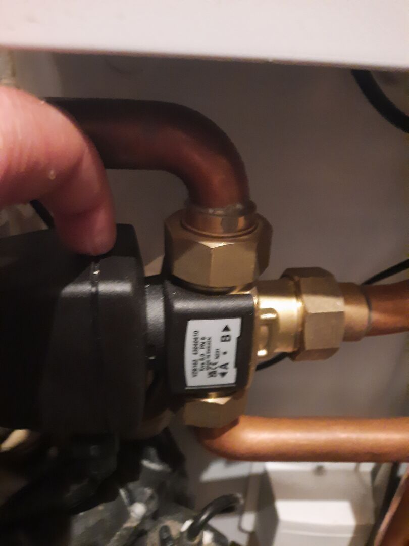

Thanks for this Mars. I've actually found out the issue, so this could potentially fix your problem Phonix.
It was the 'head' of the 3 port valve. It was seizing up inside the body - the heating side anyway.
A little wd40 and it seems to be working, but will have to order new one ASAP before it seizes again.

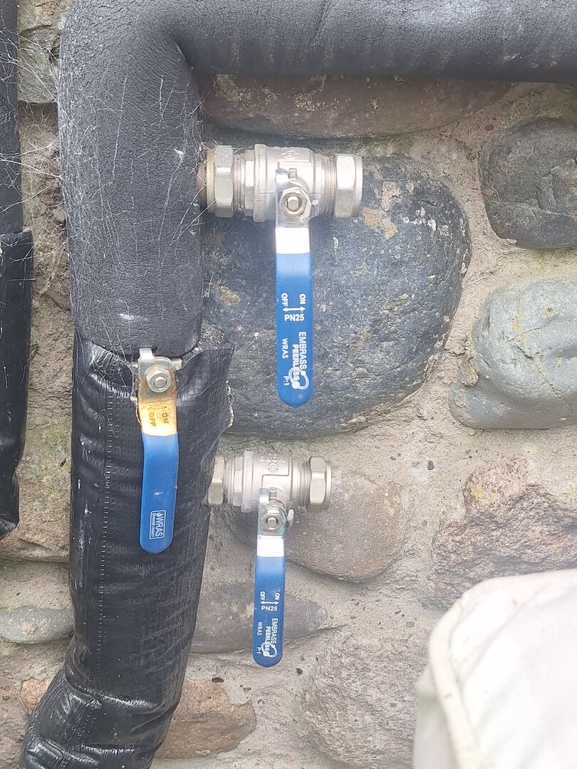

I since checked the magnetic filter again and there was quite a lot of debris that flushed through. I've been trying to find the other Y filter and can only find the attached in my indoor system.. I'm not sure this is a filter though as its vertical? Any thoughts?

(@ashp-bobba)
Posts: 505
@phoenix15 Hi Phoenix, this is an automaticity differential bypass valve and is often placed to allow surplus flow to short cycle the main system and prevent stalling of the primary pump when in a mode that needs less flow (not usually needed on ASHP with variable speed pumps and the ASHP controlling both heat and hot water (it might be needed on e 3rd party cylinder set up in some limited cases). Is your Ecodan connected to Mitsubishi Pre-plumbed cylinder?

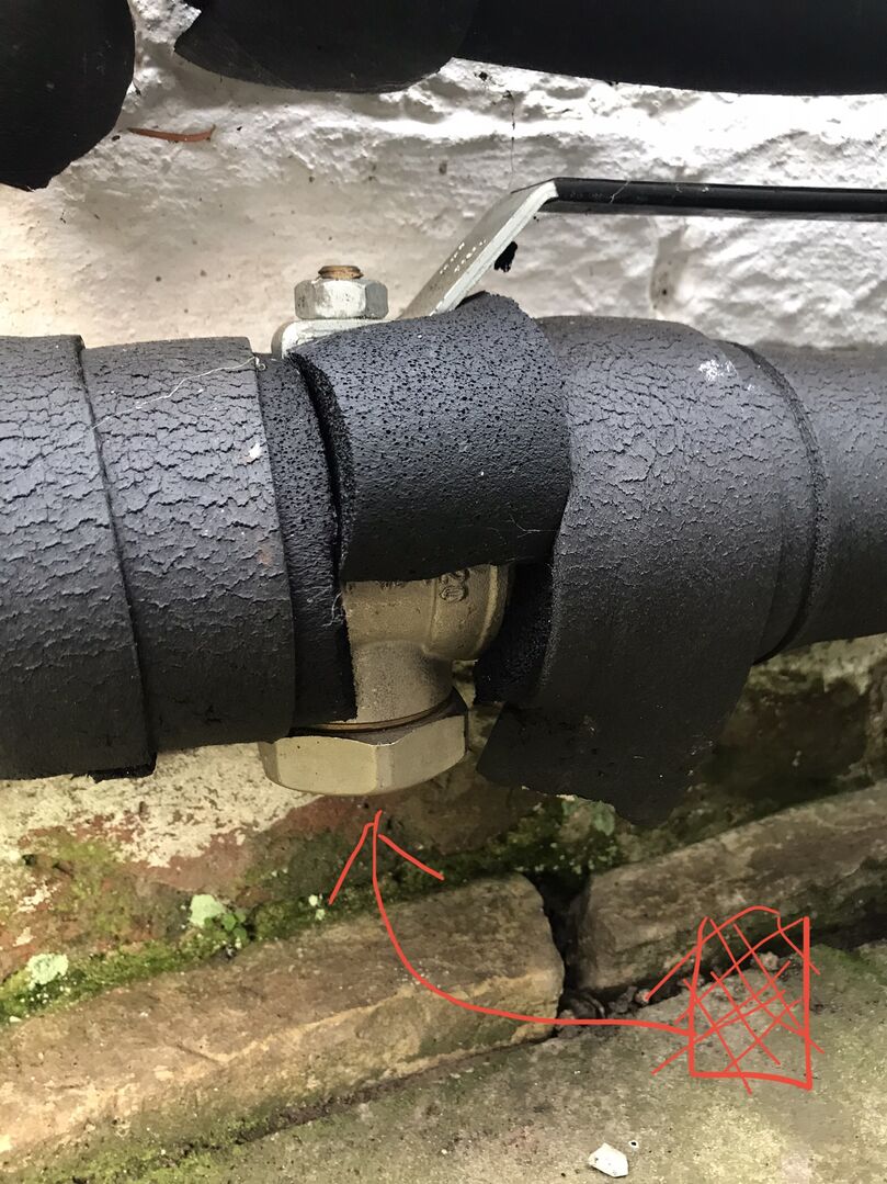

Posts: 569
@phoenix15 just wondering did you eventually find the other filter. Many of the Mitsubishi installs don’t always use the Y strainer. Instead thy have an isolation valve with a built in mesh filter. This valve is located on the outside wall on the primary return pipe going back to the Heat Pump.
Here is a picture of one and I have arrowed the access-nut which needs to be unscrewed to remove the mesh filter.
04045B48 981F 4DE0 9B8C C18AB9766E5B
(*Important note : the valve needs to be closed first before removing the nut to prevent the water emptying out onto the floor. And of course it could also contain hot water or glycol)
(@dnagre)
Posts: 3
@phoenix15 I'm no plumber so please don't take this as gospel, but what I did is
1- turn system off
2- press a button behind housing to remove housing (where my finger is pointing to, but around the back)
3- isolate the water going into the system- I had two valves
4 - use a spanner to losen, slowly, the nuts around the 3 port valve- also in the pic, water will flow out so get a big bucket.
5- when you have the valve in your hand , look for the needle looking thing. Push and pull delicately with pliers whilst spraying wd40 to the circular opening ingredients on the left and right side of the cylinder.
I also know I need to get a powerflush to get rid of the detritus I have built up in the system. This should hopefully boost flow rate too.  Good luck
20250416 202618

That’s interesting, but obviously concerning also…. Do you know how to access the flow rate enquiry menu on your main controller? IE the screen enquiry where you enter the 540 code.
It’s in the Service Menu. Select SERVICE (with the tick button), select password (with the tick button) usually 0000.
Scroll down to Running Information and select it (with the tick button), key in code 540 using the +and- buttons and arrow buttons to move the curser and press the tick button.
the readout should be your flow rate in litres per minute.
The next step is sometimes very revealing…. Press the tick button every 3 to 5 seconds for 5 consecutive times. and confirm if the flow rate changes at all.
Can you confirm what flow rate you are getting each time you press the tick button?
if there is an intermittent blockage problem this may vary quite dramatically. If it remains constantly at your target flow rate then that’s one less consideration to cross off the list. It’s not un-common for debris to build up and interfere with the optical sensor.
let me know if you want to try this?

@sunandair it just says 0 the whole time so definitely an issue. We've been trying to get someone out to the property but keep getting let down - small town and not many people that will service these AHSPs. I've had to contact Mitsubishi and see if they can come out instead, waiting to hear from them.
