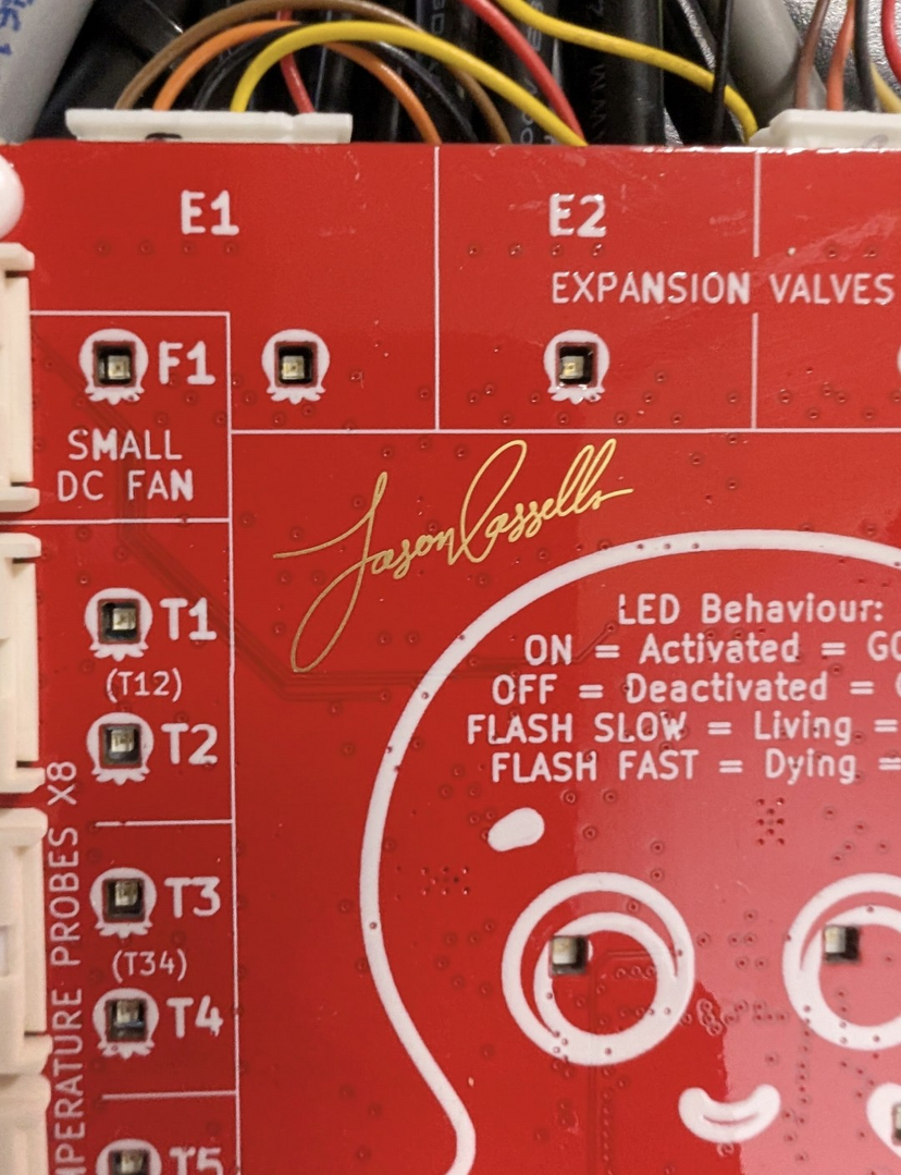

Someone signed the PCB!
@swwils that PCB is signed by Dr. Jason Cassells, former managing director of Renewable Energy Devices (RED) and unknown heat pump manufacturing legend. RED made high-end heat pumps and they were acquired by Octopus. We had the honour of interviewing Jason years ago before he sold to Octopus.

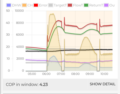

I am not privvy to the exact control algorithm, but it definitely seems to have some room temp influence... but not directly as far as I've seen - the unit will occasionally ramp up past the minimum modulation point, check the result on room temp then ramp back down again. This is outside the usual, constant dT modulation.
I haven't really had any non-cyclic loads for it yet, so my data is very limited... My house has massive solar gains (every room is south facing with floor to ceiling glazing) and the primary stat is in the room with largest heat loss. A perfect system would be multi zoned and WC downstairs but RAT everywhere else, but to be honest I am happy just running it in one large open WC loop. There is real value in just set and forget and I think for the majority of people noone cares about how the heating works.
