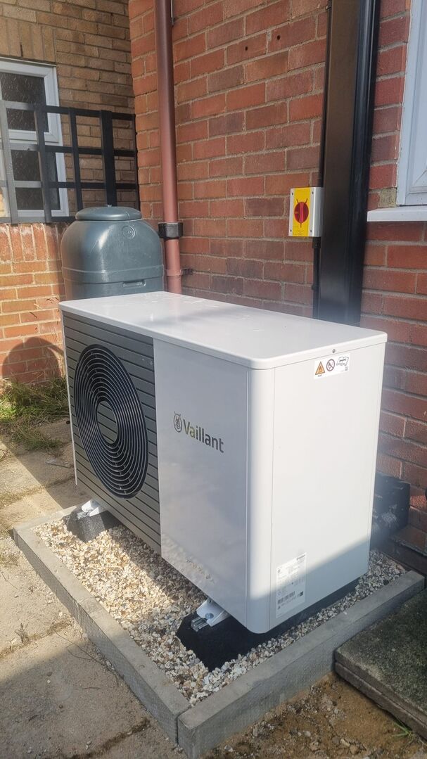

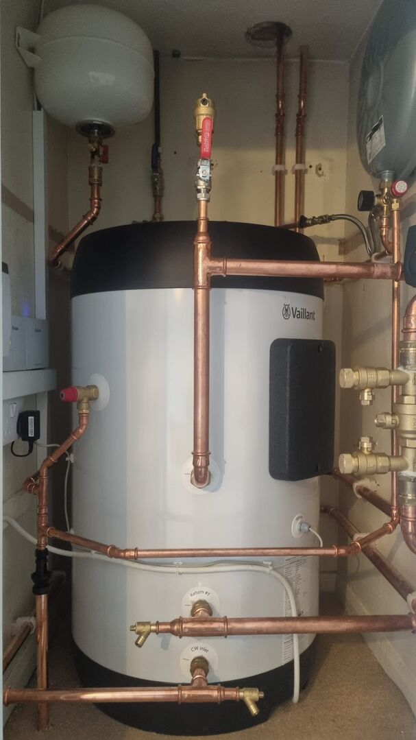

I am excited to update you on my heat pump installation. This has finally been commissioned today. Works started Monday morning, the 25th.
I took a couple of pictures of the pump and the cylinder. I am not showing the loft with the piping and wiring to the volumiser nor the radiators.
My feeling is that work has been done properly and the Smart Heating ltd Head said that the water is flowing with max efficiency. Micro-bubbles will still be to be dissolved over time.
He walked me through the Vaillant app and the sensocomfort controller (this has been a slight disappointment because I was on the impression that they were going to plug Havenwise based on their previous comms but this was an office mistake - he told me Heat Geek does not provide Havenwise whereas they provide it to customers outside this scheme...).
I have currently set the target room temp at 18 and the hot water at 45 degrees C.
Any comments/questions are welcome.
Thanks for your support and help.
Enjoy the weekend!
Delighted to hear this went well. It looks very neat
The only comment I would make about the installation is that pipework within 1m of the DHW tank should be insulated - unless (like me) you instructed them not to do so (I wanted an airing cupboard)
