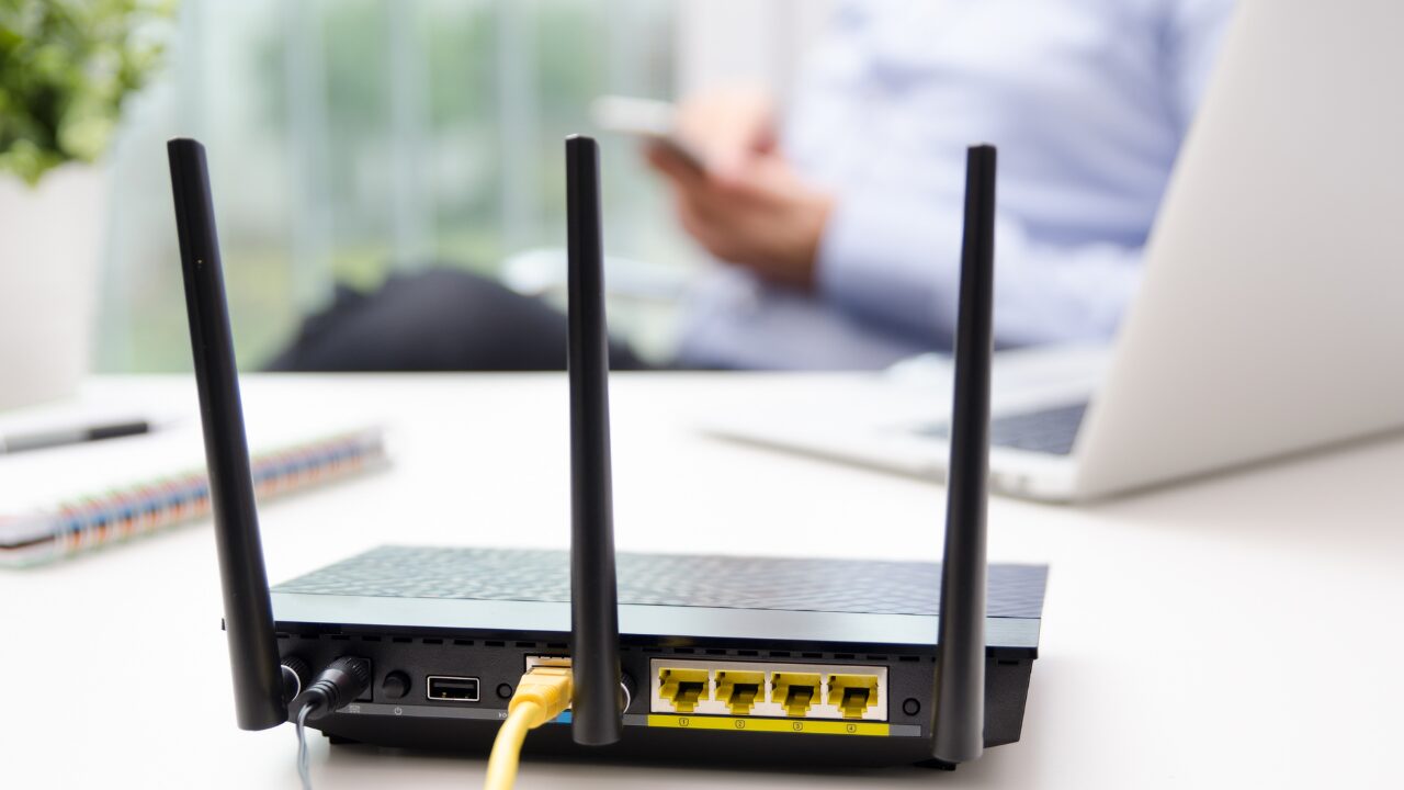

Is Your Broadband Router the Weak Link in Your High-Tech Home?
So you’ve invested in a heat pump, a solar PV array and battery, an electric car, an EV charger and goodness knows how many other smart devices – CCTV cameras, doorbells, smart plugs, smart TVs, streaming services and many more. How much have you invested? Excluding the car, £10k? £20k? More? And how do you control all this? Apps? An integrated home automation system? Manufacturers’ portals? Whatever your answer, somehow and somewhere in all that you’re relying on that broadband connection of yours.
Not only that, if you work from home then that broadband’s indispensable. Even if you don’t, you most likely use it with your phones, your tablets, any laptops or PCs you have. That’s a HUGE dependency. It’s sobering, then, to think that whilst we’re busy building and adding to our technological life, few of us have considered the foundations we’re building onto.
The starting point
So let’s take a look at how things are set up in most homes. At some point you had a chat with a service provider and they installed a connection. The engineer who visited likely installed their little box on the wall at a point convenient to them, and they left you with a router that would let you use your swanky new broadband.
That router now represents your home network in its entirety. If you want wifi, that box provides it. If you want to plug in something with a network cable, that box has a few ports that allow that. You obviously don’t want the world looking back down that connection at everything on your network, so the router also has an inbuilt firewall. Not bad for a freebie.
However, if you look a bit closer you start to see the limitations. The “convenient” point the engineer put the router was near the front door, meaning wifi is rubbish at the back of the house (or other installation point vs furthest point away from it). If someone’s watching a movie, everyone else’s wifi slows down. If you want to plug more than four network cables in, that router isn’t the tool for the job. And the ISP promised a router; they didn’t promise a GOOD router.
So what can be done?
I should point out here and now that investing in your home network is not cost-free. Everything you do to improve it has a price tag and whilst the improvements are often well worth the cost, everyone’s budget is different and you have to decide whether any particular improvement is worth doing in your situation; after all, the cost of doing nothing is still a working broadband connection.
Pretty obviously, if everything’s centred round the router and you’re being held back by the router’s limitations the temptation is to upgrade by getting a better router. Certainly a valid option, but not necessarily the best. The problem is that even a better router is still being asked to do everything; a jack of all trades, if you will, and it most certainly still won’t be a master of any of them. And the one thing you’re unlikely to tangibly improve on is the ability to actually route internal traffic out to the broadband connection.
A more effective path of improvement, therefore, is to start reducing the number of different jobs you’re asking of the router and get those jobs done by kit that’s designed for the task. There are a few key rules of thumb that are worth mentioning here to help with identifying which functionality is most important for you.
