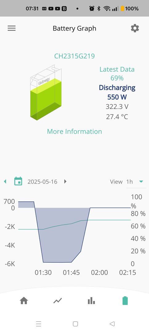

The app shows the values. But given that it just charges from 90% to 96% in around 40 minutes, the graph is not very clear.
