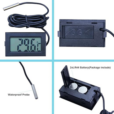

@grahamf - it's going to make our discussion a lot easier if we had more temperature data.
At present you can buy six(!) digital thermometers with remote probes from Amazon for £8.49,
plus a set of LR44 button cells to power them.
You can probably push the probes into the insulation where a pipe joins to each tank.
OK, you'll need to be taking manual readings, but you'll quickly get a better idea of what's happening,
and if the stratification referred to by @judith is working.
At this stage let's not assume that the two tanks are coupled together in the 'correct' way!
