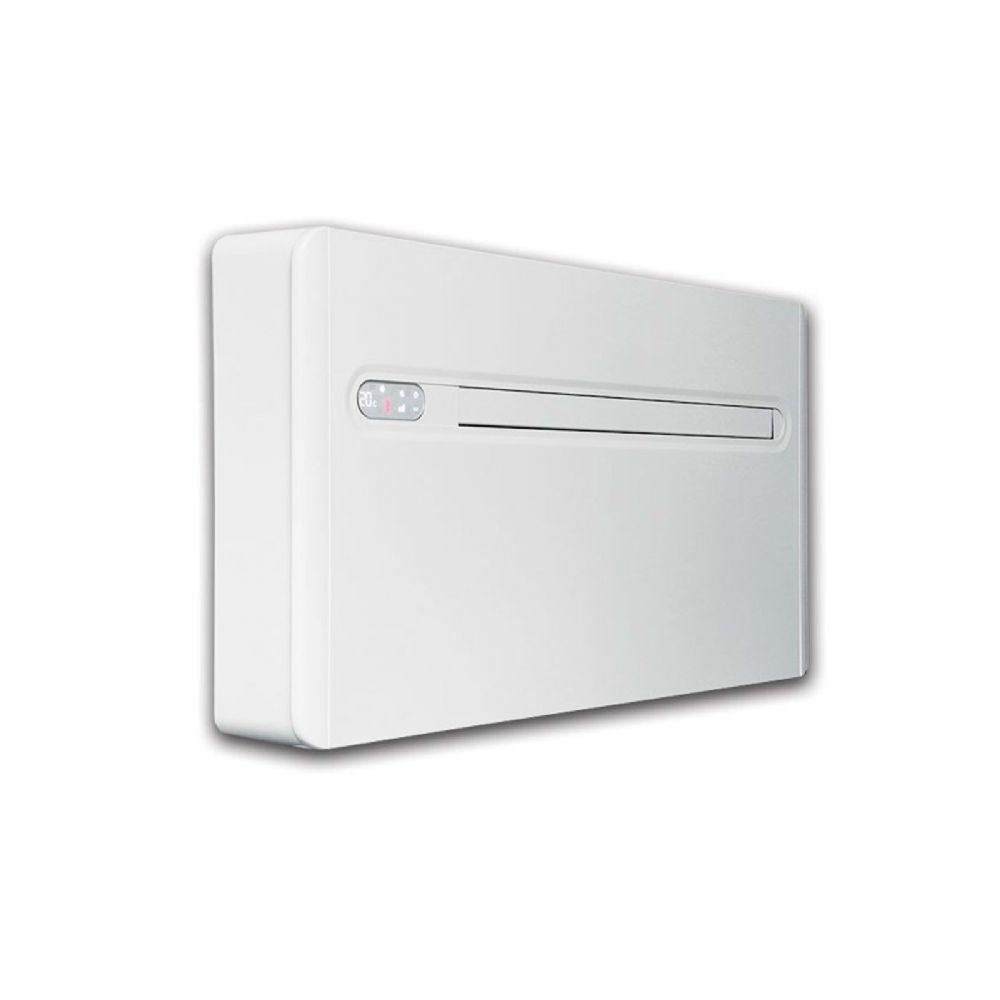

To minimise energy consumption to could consider a small Air to Air ASHP, which should be able to heat a single room in the most efficient manner. Though I still doubt that you would be able to go totally off grid.
Thanks Derek - I'll have a look at those. Anything more efficient than direct would be interesting. As for off-grid - I may have to as I suspect AMI will be mandated eventually and I'm not hopeful we'll get an opt-out option like you can get in countries like the US.
These looks quite reasonable for single room heating folks or those that cannot afford the full hp.
why not use an airconditioning unit or an air to air heat pump as we call them these days. You can get one installed and supplied for £1000 by any local installer if you get it done before the summer. In summer the lads are busy so it costs more. good luck.
look at a midea unit they are very good and ridiculously cheap www.freedomac.co.uk
Heat pump builder
thanks graham... specs look good. and efficiencies as high as 4 (at least on paper). Install and operation look a lot less complicated also.
Anyone have any real-life experience with these modular units? cop/running costs info?
Just as an alternative. A heat pump with everything in a single internal unit with no outside mechanism. Just two vents. Hence doesn't need fgas installer.
I will leave to others to comment given i have no experience of heat pumps.
Does anyone have any experience of these? I have a log cabin we need to heat and this looks like it could do it
