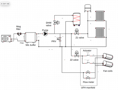

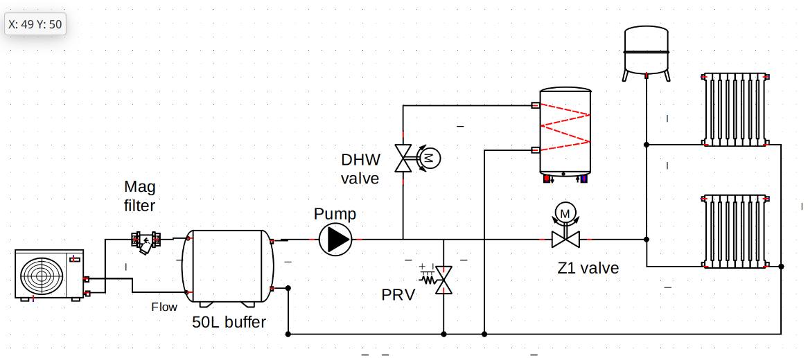

I have a 13kW Grant ASHP, installed to the letter of Grant's instructions at the time. 50 litre buffer, 200 litre DHW cylinder, radiators (with TRVs which are never used), wired as classic S-plan. After I rewired it to use the native ASHP controls since the installer followed the (very mistaken) Grant instructions, it works well for heating and hot water. The ASHP is maybe a bit oversized (deliberately, for noise reasons) but it seems to work fine - no short cycling. On mild days it'll run for a short time to heat the buffer and then circulate that heat for an hour or few around the house (ie the buffer is doing its job). It's set to run 'sniff' cycles every 20 minutes, ie run the internal pump to take the temperature of the buffer water by sending it past the outdoor unit's temperature probe and decide whether to turn on or not*. Here's a diagram:
(* I have actually wired a buffer thermistor so it can measure the buffer temperature directly, but it seems the only mode it'll use that is when it tries to keep the buffer at a constant temperature like a gas boiler - no weather compensation or anything, which isn't what I want. When I disable that mode the buffer temperature always reads 25C - seems using sniff cycles is the only option in more sensible modes.)
I'm pondering installing some fan coils for cooling. Current thinking is to install them on a second zone (S-plan+) like an upside down underfloor heating system: UFH manifold, UFH actuators, and no valvegear in the fan coils (easier to manage condensation that way). Sketch:
Are there any reasons not to go with this plan? I've tested the ASHP by switching the cables to the DHW and Z1 zones and running it in cooling mode - it makes a nice tank of chilled water (although the coldest water sinks to the bottom of the tank and the draw is at the top, so you can't actually chill the whole tank to 7C even if that's what it's making).
One thing I wondered was about the buffer when switching between DHW and cooling. If you've just made a tank of hot water for a shower then want to switch to cooling mode. What happens when you engage cooling is the unit runs its internal pump and the fan with no compressor to cool down the buffer circuit to outside temperature, and then runs the compressor to cool it below ambient. But this is inefficient as every time you switch from hot water to cooling you have to cool that 50+ litres, and heat it again when you want hot water. Typically I have it set to just run the hot water any time the water temperature gets a bit low, which can be at any point in the day. Let's assume that I just want a fit and forget option, ie I don't want to micromanage scheduling the hot water at 3am to avoid conflicts with cooling. It seems less than ideal to have hot water and cooling fighting like this.
One option would be to move the DHW before the buffer, on the basis that there will always be a constant flow through the DHW circuit. This would then move the buffer into the heating/cooling side only, and allow a switch between heating and cooling modes without having to shift the buffer water. Something like:
What would be the pros and cons of this approach? I need to do the calculation of the ASHP's minimum flow against flow through the hot water cylinder coil, but let's assume that's ok. I'd have thought there would be enough heat in the DHW side to scavenge for defrost cycles when in DHW mode, and in heating mode there's still the buffer. If one of the valves stuck presumably the ASHP would shut off to protect itself for lack of flow. Any other things to watch out for, or reasons why this isn't a good idea?
Edit: maybe I'll need to move the expansion tank to before the Z1 and Z2 valves, to manage pressure when in cooling mode too?

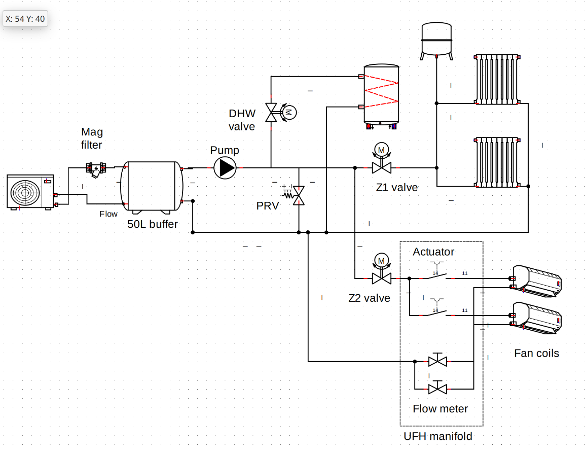

Posted by: @prunusOne option would be to move the DHW before the buffer, on the basis that there will always be a constant flow through the DHW circuit.
This is how my system is arranged, with a three port valve that switches the HP flow either directly to the DHW or to the buffer when in heating /cooling mode.
Posted by: @prunusOne option would be to move the DHW before the buffer, on the basis that there will always be a constant flow through the DHW circuit. This would then move the buffer into the heating/cooling side only, and allow a switch between heating and cooling modes without having to shift the buffer water
Definitely do this. My dhw operates fine without a buffer or volumiser and your logic explains why.
Posted by: @prunusEdit: maybe I'll need to move the expansion tank to before the Z1 and Z2 valves, to manage pressure when in cooling mode too?
Agree
If you are replumbing why not turn the buffer into a 2 port volumiser in the flow, lose the secondary pump and likely reduce your operating cost by 10-15%. You have probably violated the warranty anyway so you might as well do the job properly.
Posted by: @jamespaIf you are replumbing why not turn the buffer into a 2 port volumiser in the flow, lose the secondary pump and likely reduce your operating cost by 10-15%. You have probably violated the warranty anyway so you might as well do the job properly.
I wondered about that. Wouldn't that potentially cause issues with flow rates? I have no idea what the flow through the radiators is, and I thought the idea of hydraulic separation is that I don't need to care?
Also, I'm concerned about the situation with the fan coils if they are individually valved at the manifold (for reasons of wanting to minimise the places I'm pumping chilled water to minimise condensation), which means that if only one is turned on (quite likely because they make noise) then the flow rate will be limited to the pipe run through that coil only (16mm pipe, most likely).
I need to work out how to 'call for cold' but I was originally thinking that I can let the ASHP and buffer do their sniff cycles (ie they run 24/7 and fire up to cool the buffer when sensing it's warmed up too much), and then I am free to valve individual fan coils via the UFH actuator so they pull cold based on room demand (classic UFH room thermostat style, just with a bit of fan speed control too).
And why would you put the volumiser in the flow and not the return? Is that intentionally to make the system slower to react?
Posted by: @prunusI wondered about that. Wouldn't that potentially cause issues with flow rates? I have no idea what the flow through the radiators is, and I thought the idea of hydraulic separation is that I don't need to care?
Unfortunately even with hydraulic separation you do need to worry about flow rates unless you are happy to increase operating costs by 15%, because unless you match the flow rates you get mixing in the buffer reducing ft to the emitters thus increasing the ft required from the heat pump ( unless you have much larger buffer, in which case you can match average not instantaneous flow rates, which requires a different control loop that few installers know how to implement)

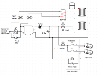

I suppose what I could do is add two three port valves, one for the DHW side (thanks @downfield, much neater) and another one as a buffer bypass. In heating mode the buffer is bypassed on the flow side but remains on the return side, turning into a volumiser. In cooling mode (or maybe never) the pump is in circuit and it operates as a buffer. At least I have both options and it's just one wire to experiment. How does this look?:
(I'll probably take the opportunity to add heat metering while doing it too)
Posted by: @prunusAgreed, you get loss of optimality - but it continues to work, rather than just breaking.
It is very unlikely to break, but of course it just might if there is something unusual about your plumbing. Its obviously your choice whether to (a) take the risk or (b) do it in a way thats reversible or (c) do nothing in relation to this matterother than taking it out of the DHW loop, which obviously you want to do if its going to be used for cooling.
Posted by: @prunusWe get about 40C internally due to east-facing solar gain (external shutters not feasible due to roof and window design). If I'm doing this I want to do it properly, ie get the same smooth constant temperatures for cooling as you get with a heatpump for heating (targeting about 20C). It also needs to be able to fight internal loads (solar gain, electrical equipment, showers, body heat) which makes it harder work than for heating where those things work with you.
OK that's quite a serious endeavour, and a seriously high temperature which TBH, suggests suspect house design (or at least house design that didn't take into account solar gain). However you have what you have.
I cant comment on this level of cooling other than to say that (as you imply may be the case) I am told by those who specialise in commercial aircon that they size for cooling not for heating, because its more challenging. I guess this is because the things that happen in an office (and as you point out also a house) will always heat it but never cool it. You will obviously need to do the same sort of calculations for cooling as you do for heating. In terms of outside air temperature its the same calculation but the adding in the internal loads. I personally have no idea how you calculate for solar gain which is perhaps the dominant effect, maybe someone else does. Are you absolutely sure there is no way to mitigate this at least in part, eg a remotely controlled blind integrated into the window in question, or a projecting shade. In the end it may pay to spend some money on reducing the gain just as it's a good idea to spend money on insulation. Of course I accept this may be impossible.
Common thermostats don't deal with cooling and I don't know if Grant ASHPs control for cooling, or just (like at least some) cool. Sorry I cant help here.
Posted by: @prunusI suppose what I could do is add two three port valves, one for the DHW side (thanks @downfield, much neater) and another one as a buffer bypass. In heating mode the buffer is bypassed on the flow side but remains on the return side, turning into a volumiser. In cooling mode (or maybe never) the pump is in circuit and it operates as a buffer. At least I have both options and it's just one wire to experiment. How does this look?:
The idea of making it switchable seems very sound. If I understand your diagram correctly I think, but am not sure, that the diagram turns it into a kind of three port buffer because there is a third leg not switched by the valves but still connected. A further shut off valve may be needed. Obviously the secondary pump would also need to be switchable.

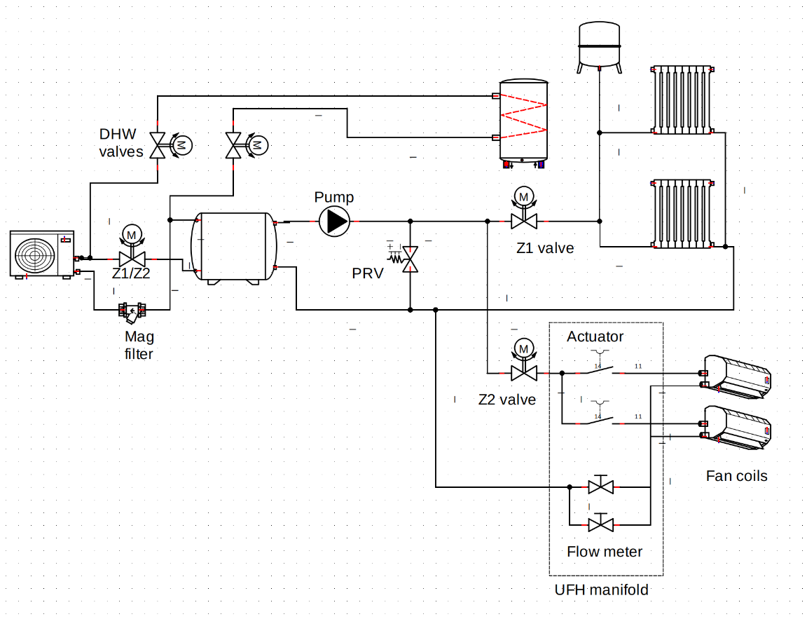

Good spot, I'd missed that 'short circuit' path. Here's another go:
If no V1/V2/V3 are powered (all NC position) then we're in classic buffer heating configuration. The pump runs when there's a call for heat.
V1 is powered (in the NO position) when DHW is demanded. Because V3 is unpowered (in the NC position) the buffer bypass is closed.
If V2 and V3 are powered then the buffer is bypassed. The pump must be disabled.
Possibly also want to drop the Z2 valve if the actuators are going to do the same job, or replace with a manual isolation valve.
How does this look? What else have I missed?
