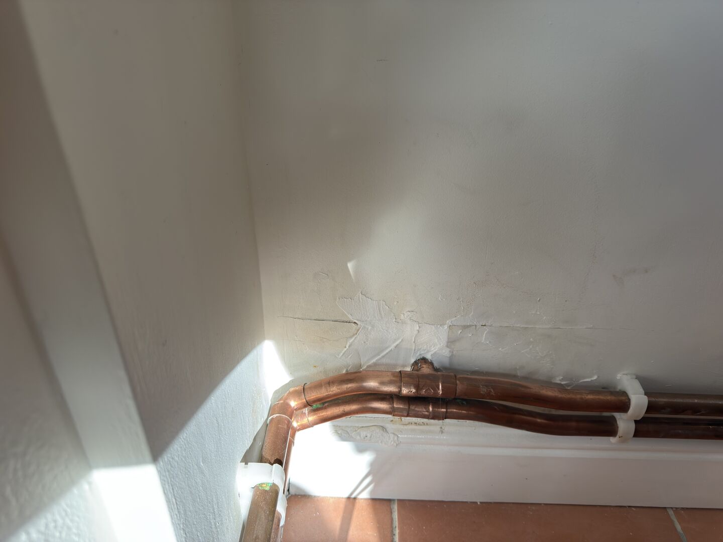

Communication has not been great, after the initial flurry of activity we had no further comms until the equipment was delivered on the 06th of Jan, before any tradesmen had turned up. When the heating engineers turned up they immediately got to work. They stripped out the old heating system on day one. We were told the install would take 5 days and that there was a team that would come around after the install and take away all the rubbish, neither of which happened. The install took nearly two weeks, bearing in mind we no longer had any central heating in January! They left the old boiler connected as it was on the same feed as our Aga, so we had hot water, and the log burner helped heat the house. Even though the install was complete it took over a month to get the final paperwork (warranties, guarantees etc).
The Ugly:

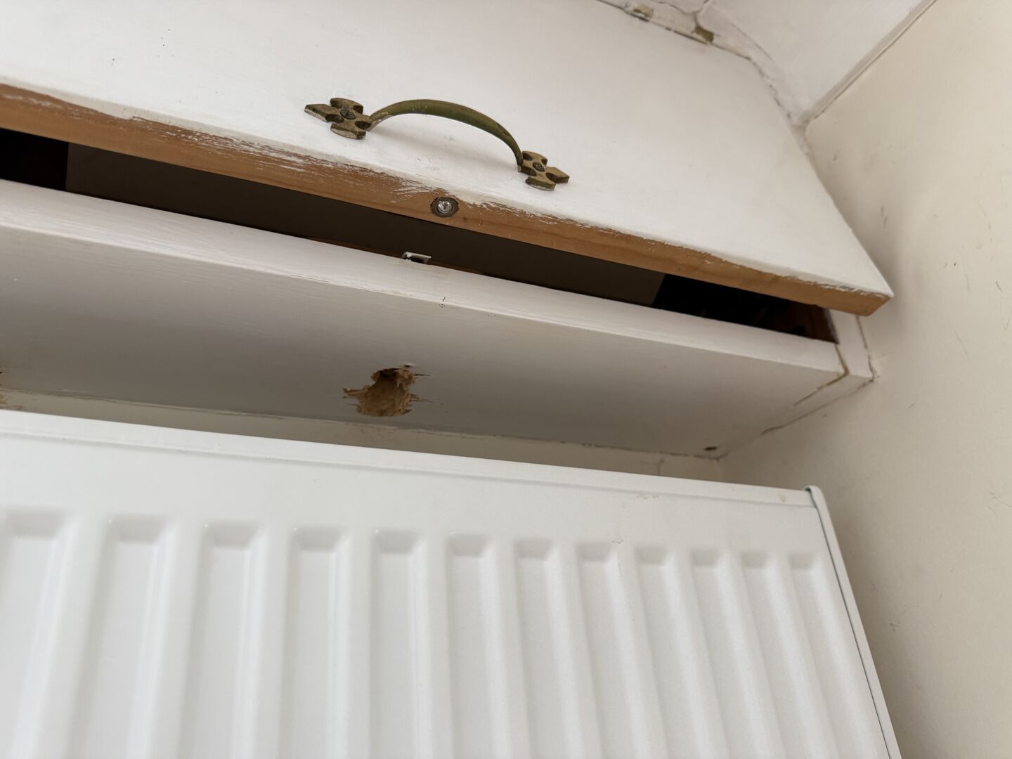

As the installer were definitely not local to us (they were commuting 3 hours in the morning and two hours home at night) which meant they were only working from 1000-1500 and because of this they were rushing everything about the install. Basic things you would expect to happen didn’t, such as not using heat shields when soldering near skirting leaving scorch marks all over the house. They very helpfully removed all the old copper pipe but left the plastic pipe in place. One of the most unforgivable mistakes was that they didn’t pressure test the system before filling it back up so when they did turn the tap on, we had mains pressure water spewing into our lounge. Apparently, the Friday crew were in a particular rush to get home as they had forgotten to connect one of the rads!
The soak away under the heat pump was drilled 4 inches away from the drain hole of the pump which means we have the river Nile running from it, none of which goes down the soakaway! Even the bodge job of sticking a upvc elbow under it isn’t working properly. When drilling from one room to another they didn’t check the other side and drilled through a bookcase.
When they removed the old tank, they stripped the blue insulation off it and just dumped it in the loft (bizarre).

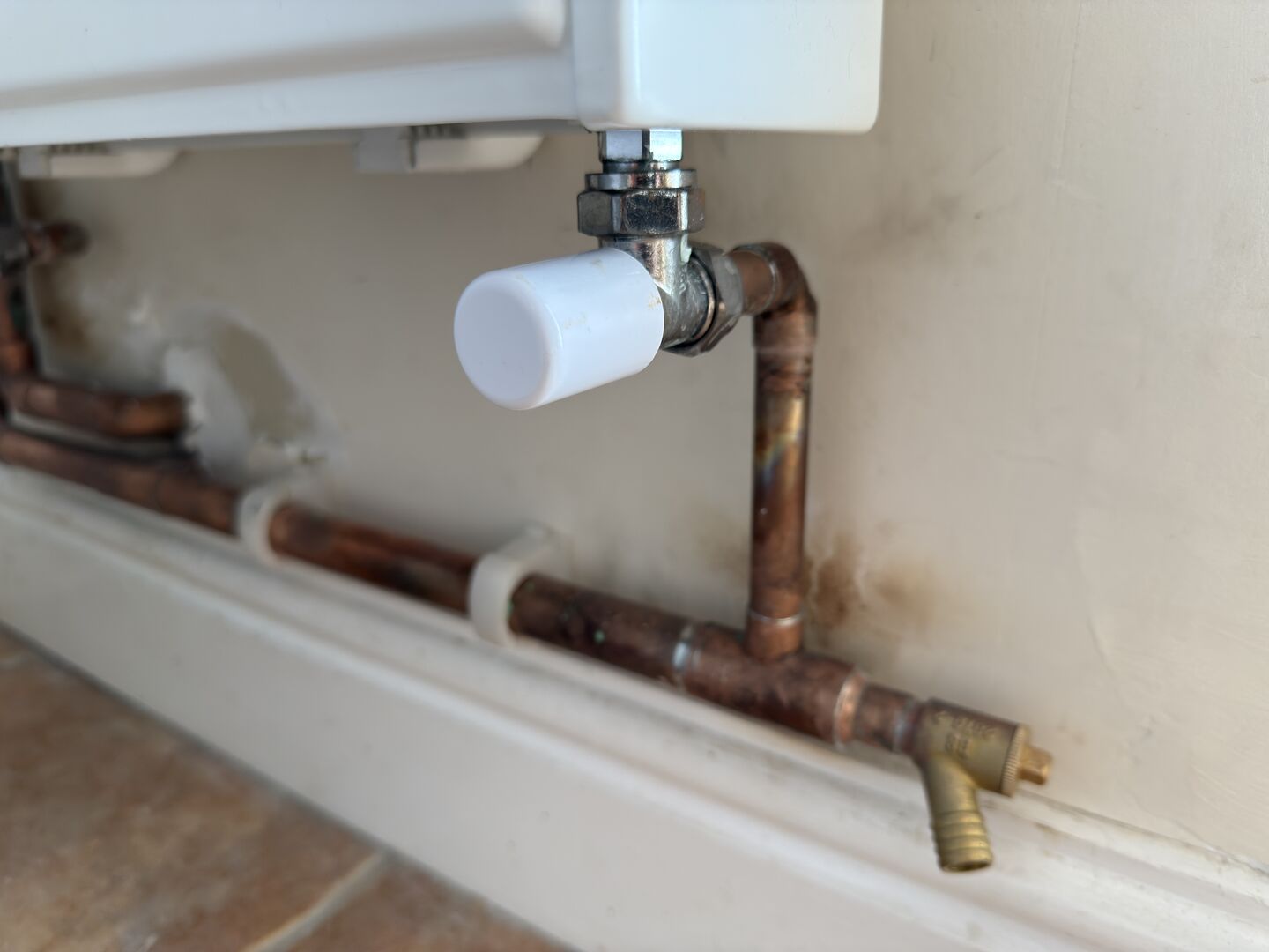

Finally, they turned the system on and then came the leaks! Even though we had been told they would not use any of the old pipe work as it had been an open system, and the old joints wouldn’t hold up in a pressurised system, guess what! The trail of destruction left behind as they rushed to fix the leaks was something to behold! More making good to be done.
The solar installers didn’t fare much better, they turned up, got to work and fitted everything in a few hours, amazing! However, in their rush to get the job done they reversed the polarity on one of the strings, they were in such a rush to leave the didn’t hand over the system or even let us know they were done. Unfortunately, the SolaX inverter they fitted comes with a dongle and a pretty rubbish app, so the company has decided that they are no longer going to install the dongle as they were getting too many call backs! Problem solved! If you know it is a poor product why stock it. Luckily, I installed the dongle and hardwired it to my network and immediately saw there were faults so had to call them back out to fix it. Any non-technical person would be stuck with a non-functioning potentially fire hazard of a solar system.
Once the installers were finished on the inside and we were all connected with the pump running, it became obvious that the system had not been balanced. Half the TRVs were set to low or completely off and one of the rads lock shield was completely shut off. More faff bleeding the rads daily, topping up the pressure but by morning it was down again, yes you guessed it more leaks, so back out they came.
