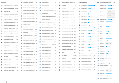

@grantmethestrength if you already have Home Assistant, just buy the Svenar dongle. It will take you 5 minutes to set up and you will have everything controllable through HA. It gives you 259 entities (data points) of which some 70 controllable.
An extract:

@mphb I have built a custom integration that exposes 245 entities on my Grant Aerona3 I currently use the Waveshare modbus to eth POE Module B to control the ASHP modbus registers and a couple of shelly minis to control dry contact switches on the PCB of the ASHP. I was just hoping that the new waveshare device would give me an all in one solution with 8 switches built in. I have just got a different device, the waveshare POE modbus 8 channel relay up and running so I will swap out that for the shelly's and use it with the original modbus controller.
