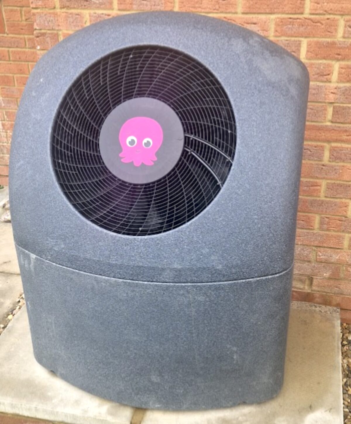

@wreckguru where was the heat pump finally installed, as in the final location?
New to heat pumps? Take the Heat Pump Fundamentals course and use INTRO50 at checkout for 50% off.
📘 From Zero to Heat Pump Hero
🛠️ Bodge Buster
🎧 Prefer to listen? Heat Pumps Explained – use AUDIO50 at checkout for 50% off.
@editor it's in the back garden, behind the attached garage. It faces the same way as the solar so 145 degrees SE and gets a bit of sun.
The DHW is the other side of the garage wall with a short flow/return about 50cm.
Your edited article looks good.
@wreckguru so the actual heat pump is not sited near a door or window?
🛠️ Bodge Buster
@editor well the house has both😂
To the left in this picture there is a door, to the right the kitchen window. A bit further down the wall an air brick.
A building surveyor passed the site for controlled zone. This was done during the swap from Daikin to Cosy.
Given I keep 10,000 L of medical grade oxygen at 220 bar in my garage I am not concerned at all about a tea cup of refrigerant in my garden.
This is just a small point, to get SCOP value you have to run it for a whole year. I think you mean COP.
@wreckguru can’t say I disagree with your assessment and choices. Just for clarity in light in light of this article and journey, did Octopus ever give you advice on positioning?
🛠️ Bodge Buster
@editor yes. For the initial assessment for the Daikin we basically ruled out all my thoughts and landed at the current spot.
When changing to Cosy the assessor needed more measurements and pictures before oking it.
The swap was done late in the day, just days after it was available and not confirmed till Thursday before the team arrived (after the scaffolding was up).
As sure as I can me this is #1 install (it is for this team😂)
App estimates SCOP from COP. I don't know if it is using the rolling figures or something else, there is no info. I suppose that would make sense and would agree with your comment.
