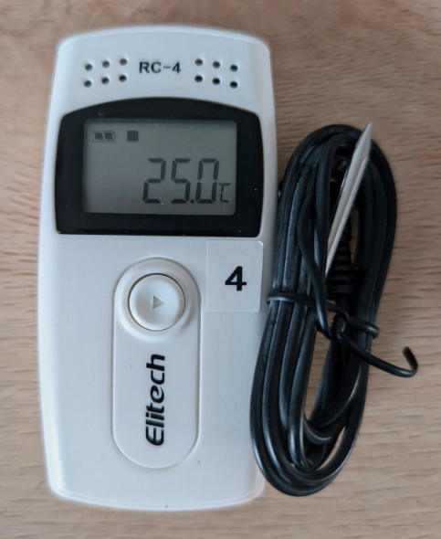

@pash44pump - to collect the IAT/OAT data, can I suggest you get a couple (more if you want) of these RC-4 data loggers:
Ebay listing here, these are used but look OK to me, under a tenner each. New ones are also available for about £20, see also on Amazon. They run for ages off a button cell, logging the air temperature at whatever interval you specify (I use an hour). You can then download the data over USB in spreadsheet format using a rather clunky software interface and produce whatever charts take your fancy.
I haven't done it (because I get the data via the wired controller), but it may also be possible to record at least an approximation to the flow temp, by taping and then insulating the supplied external probe onto the primary flow pipe. For air temps, you don't need the external probe.
I can go into more detail later if necessary, but there is one potential difficulty: the time stamps in the two (or more) data sets are different eg one data logger records the temp at nine minutes past the hour, the other at ten minutes past the hour, ie the data is out of sync, which can make for awkward plotting, but there are ways round this eg just remove the minutes (datetime stamp becomes yyyy-mm-dd-hh, but you do have to be careful, spreadsheets can be very annoying in the way they handle date/time) .

I think cathoderay would have been recommending those devices as the cheapest starting point to logging data. CR is far more knowledgeable than I when it comes to this sort of thing so may be able to provide further advice.

One the IAT, yes, fine if the wired controller is in a representative location, but what if it is not (mine isn't, it is in the airing cupboard, along with the DHW tank). An RC-4 data logger (like the one I linked to before) is the obvious simple inexpensive solution if the owner doesn't want to go down the full monitoring route. In fact, two RC-4s can take of both the IAT and the OAT.
There is really only one definitive test @pash44pump needs to do, record the IAT in one or more locations for a few hours minimum, preferably (much) longer, at a time when the OAT is at or very close to the design OAT. RC-4s can do that. Then plot the two on a chart and you have your answer.
