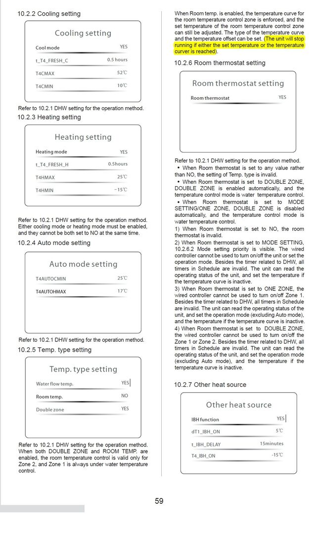

Posted by: @cathoderayPosted by: @tasosThe Midea pump is controlled by its wired controller, which houses the weather compensation curve (which is straight line, but ignore this) and its internal thermostat. These two should be operated in unison. The weather curve should tell the pump the outlet water temperature corresponding to a set of outside air temperatures. So at below zero outside temperatures, I should indicate maximum power (i.e. 60-65 C in your case). The internal thermostat should be at the required room temperature in the "coldest" room, say 21 C. This implies that you should position the wired controller in the "coldest" room.
This simply isn't true. Midea heat pumps of the type we are talking about are controlled in one of two ways:
(a) using weather compensation (WC): the flow (leaving water) temp is set from the outside air temp (sensor is in the outside heat pump) using the WC curve (which I agree is a straight line, curve being used here as a generic term for a line on a graph). The internal (to the wired controller) thermostat is not used, nor any external room temp thermostats (beyond setting them high eg 30 degrees, ie always on and always calling for heat). The only exceptions are 'set-backs' and 'set-forwards' which we are not talking about here, and crude on/off switching ie turning the heat pump off for the summer by setting an external room stat low eg 10 degrees. In normal day to day running, all the control comes from the WC curve, which only uses the outside air temp.
(b) using a fixed flow temp ie there is no weather compensation, in which case some sort of indoor thermostat is used, be it the one in the wired controller if it is in a sensible place (not always the case) or an external one. This mode of running is the same mode as normally used with fossil fuel boilers in the UK, and while it can be done, it is not the best way to run a heat pump.

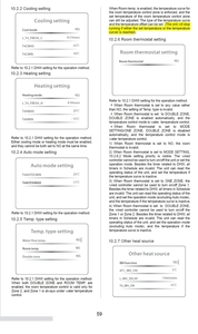

I think we are talking about the same type of Midea heat pumps. I attach the operation manual of mine, which in Section 10.2.5, p. 59, states what I am saying. Unless I understand wrongly.

Posted by: @tasosI think we are talking about the same type of Midea heat pumps.
I am now even less sure we are! The manual page you posted doesn't appear in any manual I have seen for my heat pump. I also note from your footer ('signature') that your heat pump appears to be R290, mine is R32, specifically a MIDEA M-THERMAL MONO. It may be that your heat pump's control logic is different, but still the general idea is that you don't use room stats with weather compensation, because the idea is to regulate heat delivery by setting the flow temp, based on the outside air temp, rather than by on/off cycling controlled by a room stat.
Nor am I sure I really understand the paragraph with the highlighted text. Perhaps it was written or translated by some AI bot. The text in my manual isn't really much clearer, but after looking at the various screens on my wired controller, it seems it can only do pure weather compensation ie just outside air temp control, or pure fixed flow temp, with room stat control, and never a hybrid of the two.

Posted by: @cathoderayPosted by: @tasosI think we are talking about the same type of Midea heat pumps.
Here is the manual:
https://www.emhbt.com/Manual/M-thermal/r290-arctic/iom-manual
In any case there is no point in continuing this discussion, as it is not going to help our friend. If he can be happy with weather compensation alone, then all is well. If however you want me to present my argumentation on the (in)effectiveness of weather compensation "control", I would be glad to discuss it in a new thread.

Posted by: @tasosHere is the manual:
They are definitely not the same! Even with the full manual, I still can't make much sense of it. But I have just had another look at my wired controller and as far as I can see on the second menu 'PRESET TEMPERATURE' there are three items: 'PRESET TEMP', WEATHER TEMP. SET' and ECO MODE'. Selecting PRESET TEMP' sets up fixed flow temp operation, selecting 'WEATHER TEMP. SET' sets up weather compensation, and it's one or the other, they can't be combined. If on the front page, I try to change the flow temp in the left hand box, I get a message saying 'Weather temp set function is on. Do you want to turn off it? (sic)', confirming its either fixed flow or weather temp set ie weather compensation. Nor can I find anything in the manual that suggest I can somehow combine the two, which makes sense - if the flow temp is fixed, it can't be weather compensated, and if it is weather compensated, it isn't fixed.
I am still not clear about what you are trying to describe. Re-reading your earlier posts, I think what you are suggesting is have weather compensation on, but then use a room thermostat (either the one in the wired controller in the coldest room, or an external thermostat) to turn off the heating when the coldest room gets to the room stat set temperature. But (a) I am not sure what this adds over and above just getting the pipework emitters and balancing right and running only on weather compensation and (b) if you wait for the coldest room to get up to temp, what happens to the warmer rooms?
I also have the room on the longest pipe run not getting warm enough problem, running on pure weather compensation (with the room stat set very high ie always on). If I were to lower the room stat to 21 degrees and put it in the coldest room (which I can, its a wireless remote thermostat) it wouldn't do anything to warm the room up when it's cold. I am more persuaded the problem is a pipework problem, in effect there is an obstruction, but as the pipework is buried in a solid concrete floor I have no plans to start digging it up any time soon. I think some time ago I may have closed most of the other lock shield valves (I only have rads, no UFH) and it still didn't want to warm up fully. I live with it - there is some warmth from the rad, and as most of the time the doors in my house are open, warmth moves between the rooms.
