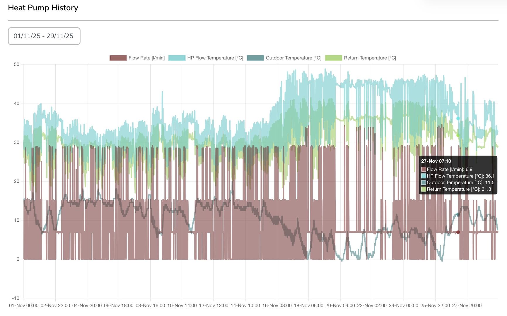

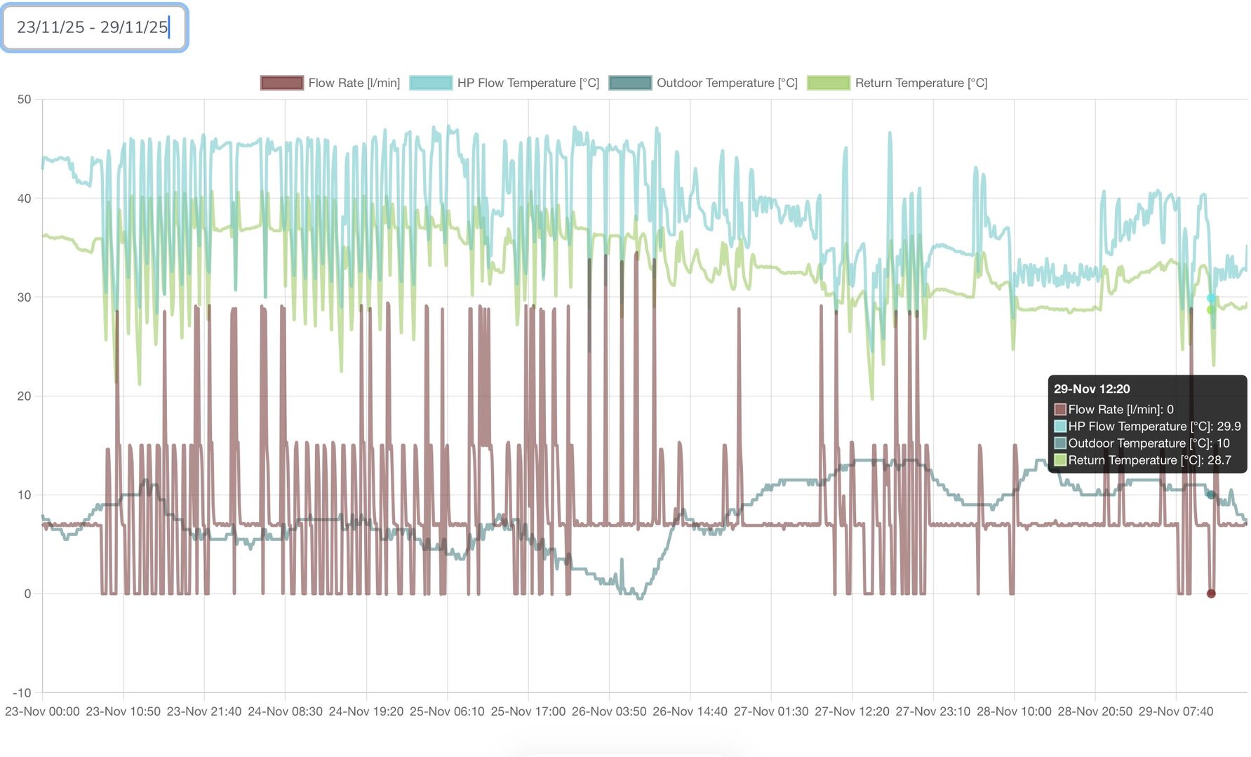

@jamespa They are indeed mysterious devices!!! I have only just discovered this thread and have been observing what I believe to be a change in the MO of my Daikin 8 kW Altherma 3 system. In previous times (last 2+ years, I have noticed flow rates that vary between ~28 lpm and ~14
lpm. Of late (during the last month) I have noticed that a flow rate of ~ 7 lpm has become the popular rate for the majority of the time once the system has settled down from starting up. I have now adjusted my Wilo Pico secondary pump on the flow from the LLH down to ~7 lpm from the former setting of ~14 lpm. What (if any) difference this will make to the running efficiency I don’t yet know though. I attach a Homely plot for the month and also for the last week only. Regards, Toodles.
@jamespa Ah, they do indeed do firmware updates very occasionally, they carried out one a few months back ISTR. Maybe that is the reason then! Regards, Toodles.
